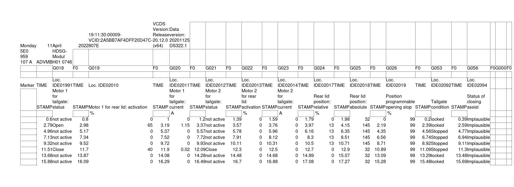

  5. Hi, I already know the topic is boring, but it can be interesting for me and I think for many others who are similar. Electric trunk is a known problem. I attach 1-2 LOGs or images in an excel format that I managed to read. Tailgate opens 1/5, it doesn't go any further mechanically. In this case, the lower lock will not be pushed out if it is accidentally pushed out (2x a year). I’m already hopeless, I can’t turn anywhere else here. I tried to teach him a new position by pressing for a long time, I tried the axle removal solution, I tried to unplug the sockets and blow in to see if there was any contact. The problem is that a lock structure is € 260, a telescope is € 400 (if it were a wonderful person within a group to repair it), the controller itself is € 205, so they are so waiting that you can’t. And whoever mentions the professional service I say in advance (unfortunately) I tried, they bet that they will also eliminate it in a trial way, so they will install it if, rectobic category. Thank you for any help you may have. 🙂 I may have read out absolute nonsense, but I tried what came to mind. The lower ones are pinned txt files. Log-Log.txt Trunk-Advanced Identification.txt Trunk-Advanced Measuring Values.txt Trunk-Log Live.txt

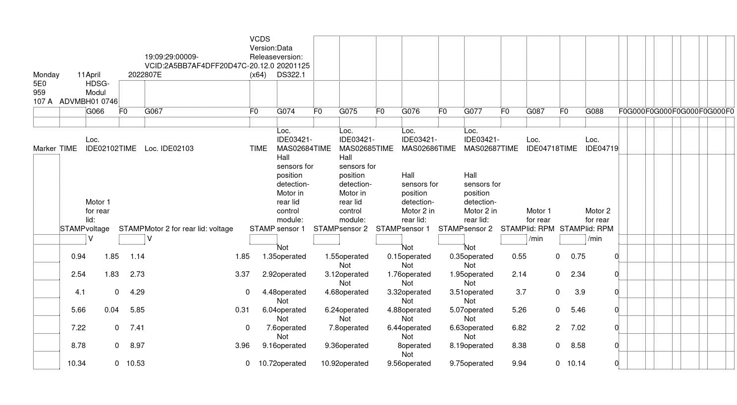

  14. Hello everyone..again. I have a problem with the electric trunk. As I mentioned earlier, it will not open completely just like 1/3. Sometimes he opens it but not much of the time. Here's vcds log about diagnostics. I tried to find out which side was wrong. Can you help me with this? What is a part number i need change, or somethink? Because im f**ked off with this.. Thank you guys. Address 6D: Trunk Elect. Labels: 7N0-959-107.clb Control Module Part Number: 5E0 959 107 A HW: 5E0 959 107 Component and/or Version: HDSG-Modul H01 0746 Software Coding: 1233074003 Work Shop Code: WSC 73430 790 00000 ASAM Dataset: EV_HDSGSk462 301136 (SK37) ROD: EV_HDSGSk462.rod VCID: 2A5BB7AF4DFF20D47C-807E 2 Faults Found: 0019 - Hall Sensors in Motor 2 for Rear Lid B120A 02 [137] - Signal Failure MIL ON - Confirmed - Tested Since Memory Clear Freeze Frame: Fault Status: 00000001 Fault Priority: 3 Fault Frequency: 2 Reset counter: 220 Mileage: 199298 km Date: 2021.11.14 Time: 13:19:53 Voltage terminal 30: 11.23 V 0128 - Closing Assistance Closed B113E F1 [008] - Implausible Signal Intermittent - Confirmed - Tested Since Memory Clear Freeze Frame: Fault Status: 00000001 Fault Priority: 2 Fault Frequency: 1 Reset counter: 5 Mileage: 199298 km Date: 2021.11.14 Time: 13:06:14 Voltage terminal 30: 11.72 V
