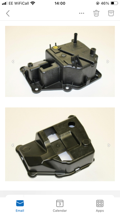

  3. Hi @netman82 thanks for your interest. Incidentally I’ve just got back from my local garage for a scan and happy to report it’s all fixed! The parts required were the crankcase breather/oil separator and its cover (04E103464AM & 04E103729, pictures attached). Got them both from Skoda direct for about £70 in total. The other part I listed that was on autodoc (https://www.autodoc.co.uk/bogap/18571281) turned out to not be for my car. As a complete non-mechanic I’m struggling to understand how two new bits of plastic have fixed the issues as the garage said there was no visible signs of damage on the old parts, but hey ho! Kind regards Ed

  6. Hello helpful Octavia folk! My 2017 plate 1.4 TSI DSG (97k miles, regular servicing at trusted independent garage) has been diagnosed with a faulty Crankcase Ventilation Valve by a company called “Scantec” in Hailsham, Sussex. It’s had an issue that’s been coming and going for a while now where once it was warmed up and usually after long drives it would have auto stop/start error followed by flashing EML when stopped, but would go away when moving off, and didn’t feel much like a loss of power or heavy fuel use (still getting 50+ mpg). Multiple engine misfire codes detected, concentrated on cylinder no.3. Spark and coil packs were replaced a few months ago and seemed fine but the problem had returned, and my local garage sent it to Scantec where they’ve diagnosed this PCV fault. Yesterday was a bit sad because the usual car part suppliers don’t sell these valves as standalones, and VW group said that the whole of the top of the engine would need replacing, so I was quoted nearly £2,000 after labour by my local garage. For a car that’s worth about £6-7k I can’t really justify that expense, gutted though as I think it’s still got loads of life. This morning however I have come across these parts on eBay! If it is just the PCV valve that’s faulty, please could you kindly tell me if these are the correct parts (not sure what the difference is between the cylindrical valve and the the longer hose section?) if so that‘ll be an enormous relief - £30-40 plus a bit of labour is a bit more positive than £2k! https://www.ebay.co.uk/sch/i.html?_nkw=crnkcase+ventilation+valve+skoda+octavia+2017+1.4+tsi+mk+iii Thank you kindly in advance for your expertise! Kind regards Ed
