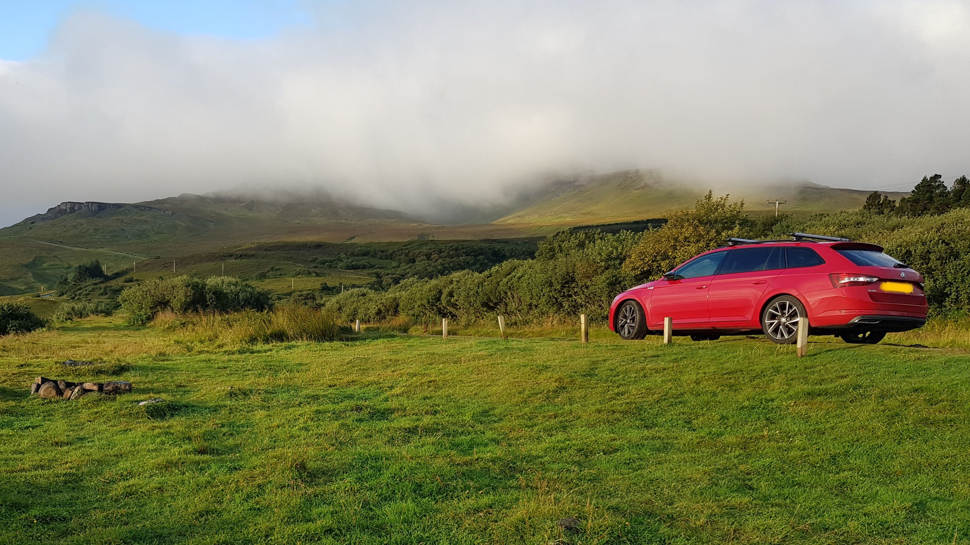

  3. Hi All, I found this forum while doing a bit of research on car models, and have to say it's been absolutley invaluable (and will continue to be, almost dangerous as it keeps giving me iddas of things to do ). I ended up recently getting my hands on 2019 Superb Sportline Plus, and have been enjoing every minute of it. Still can't get over the fuel economy for road trips! Here she is having just taken us up to the Isle of Skye for a bit of camping. Cheers, Matt
