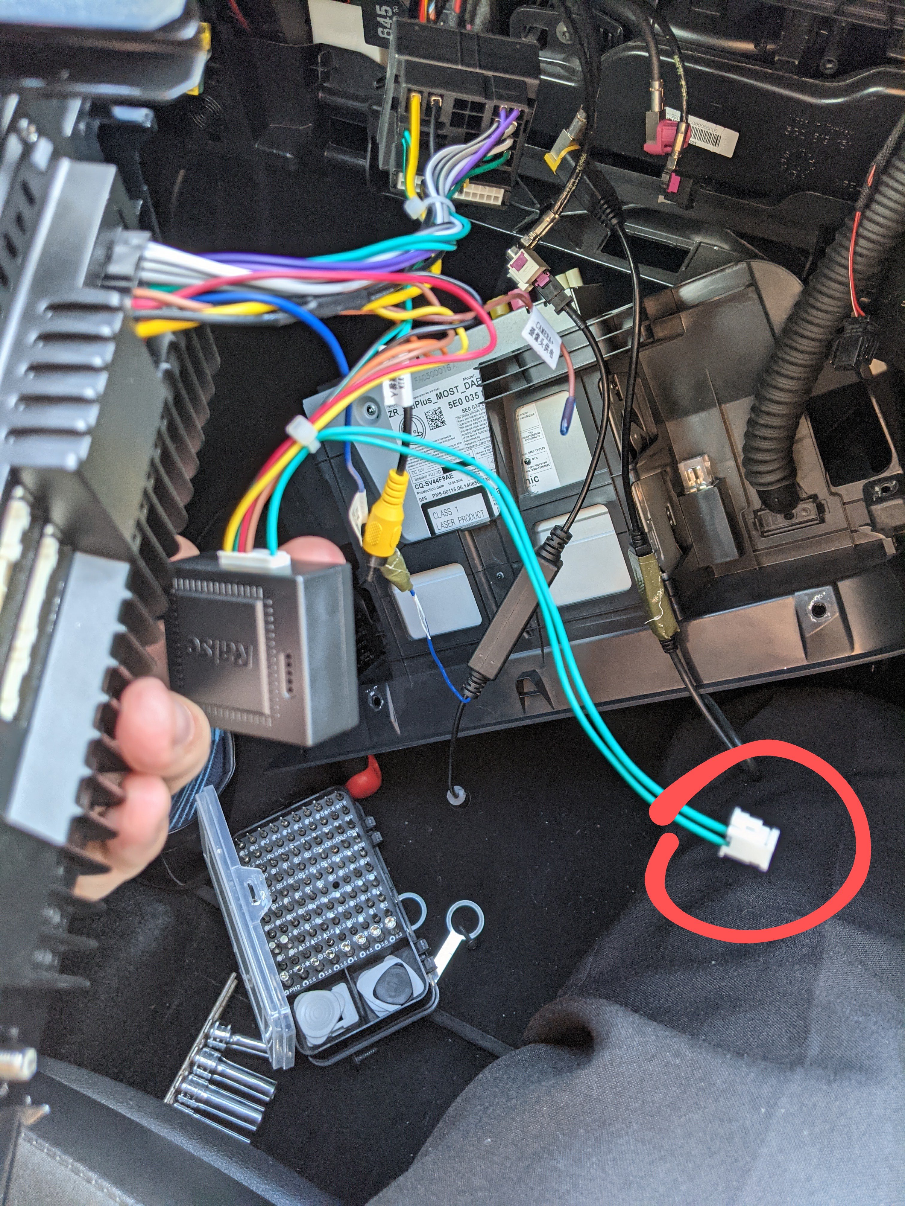

  12. As @FUBAR was saying there should be just enough room to plug the power in while your holding the unit a couple inch from the dash. It looked like you had it in that position on one of your pics? If you put your hand inside the empty space where you're previous head unit was. Just inside to the left is a few holes that lead to the area above the glove box, you'll feel the one nearest is bigger than the others to feed cables through there. As for mine, I managed to get the unit powered on. Turns out it is cutting out when the canbus connector is plugged into the head unit, not sure why? I was thinking maybe the + and - are the wrong way round. (culprit below) So for now, everything works bar all the trip computer information stuff, which is a pain. I'll be asking the seller for a new harness and connectors I guess. Looks great when it's in though!
  13. Android unit still had no power the 2nd time, so I've put the original back in for now. Original one works so don't think an internal fuse gas gone. I need to check the android units fuse in case that's blown, I didn't disconnect car battery during installation. Failing that I'll sort another from supplier I guess. Quick one for you @FUBAR was there anything I was supposed to do with the power connector that plugs in to back of the original screen?
