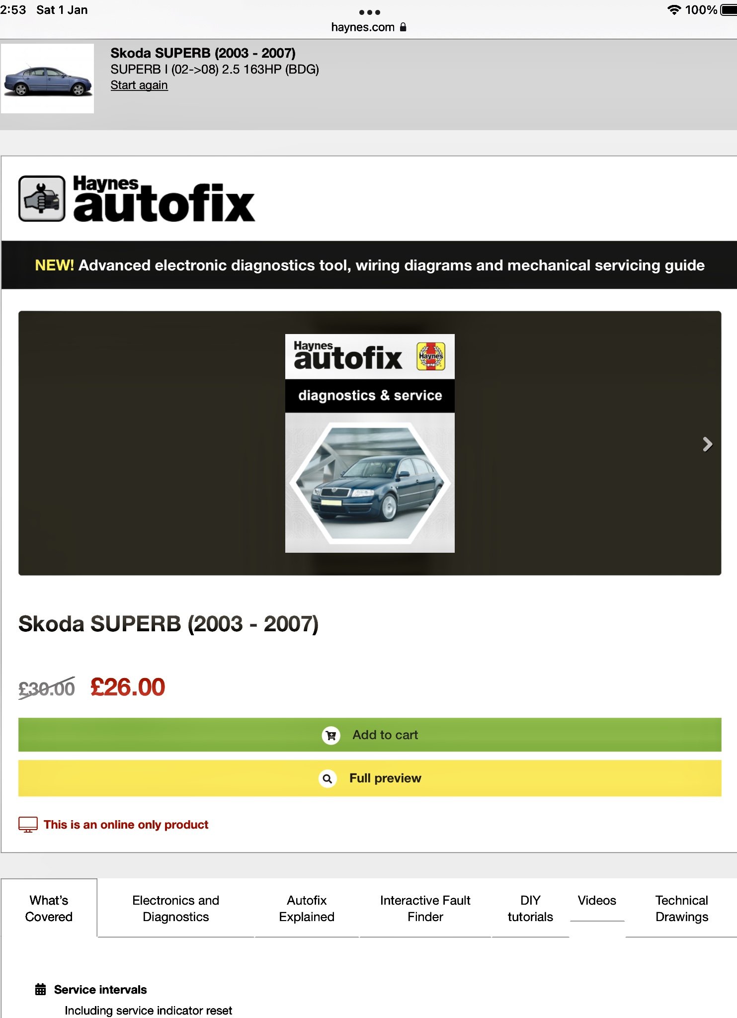

  11. Would this be the right one? Was just searching myself and Google showed your post on Briskoda
