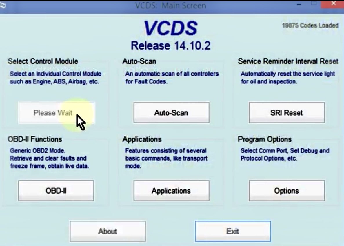

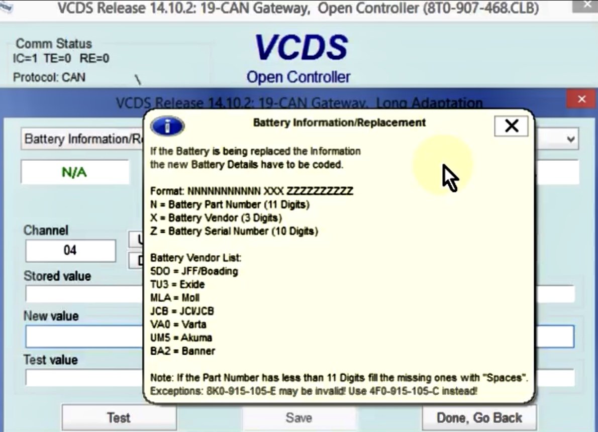

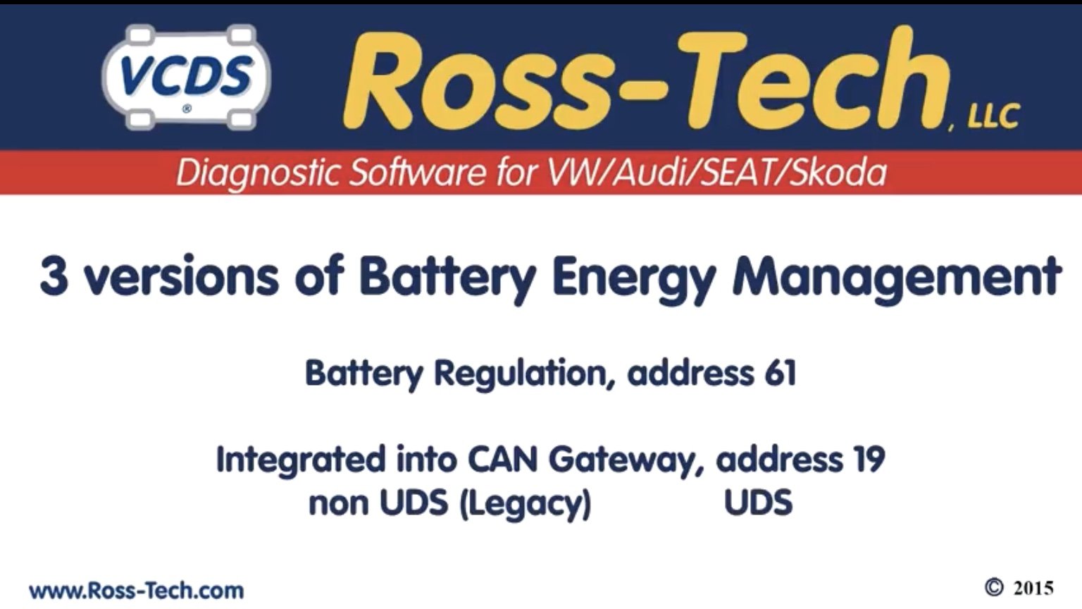

  Since writing my question, I came across a  video article that said a new battery has to be Coded into the car system when it is installed,
I watched the video showing the method if doing this which I have to say, no normal person would be capable of doing this; only a
Skoda specialist would be able to do this.
I have never heard if such a thing and may well have misunderstood the whole business.
i attach 3 screenshots.   Perhaps I have got it all entirely wrong.

I think the battery coding will be irrelevant for a car of 2007 vintage,  so relax on that front.
