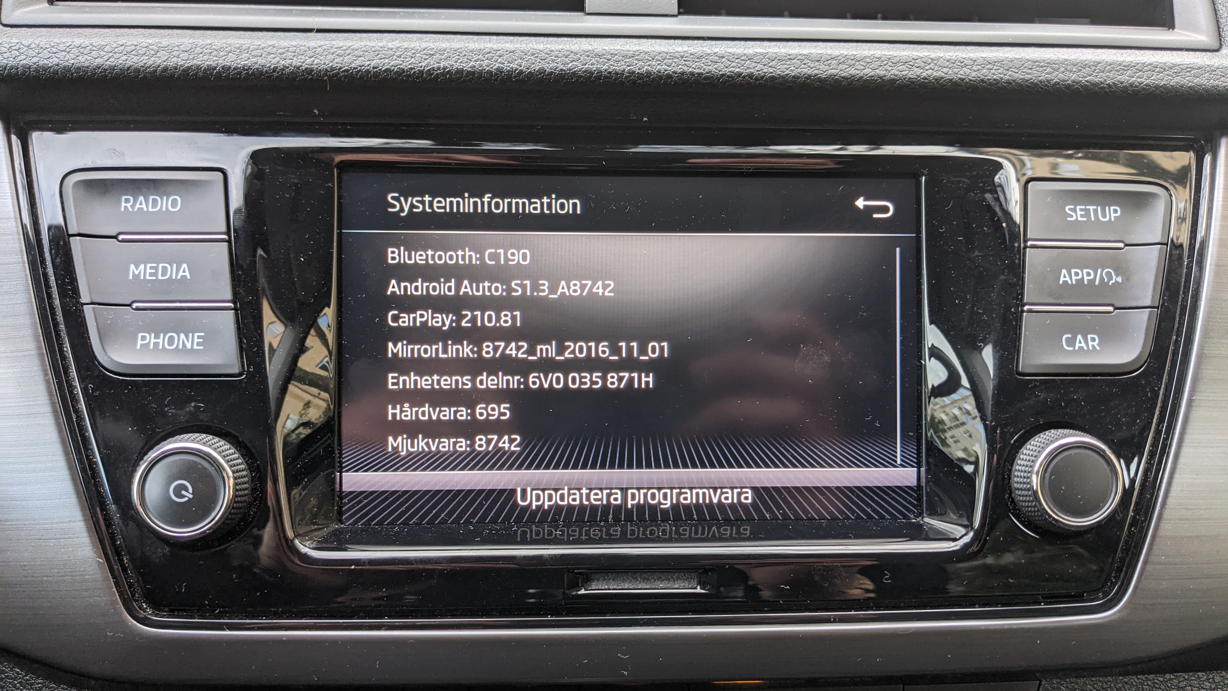

  2. Thank you for that info, very helpful! 👍 I guess I'll just have to try then but sounds hopeful that B and D units does support RVC. It would follow the logic that you explained, then, that H will as well. A follow-up question if it turns out my unit does support RVC: Are there any instructions for programming with VCDS? I do have a VCDS cable available for my car and it connects OK when hooking up but I am unsure as to how I would program it.

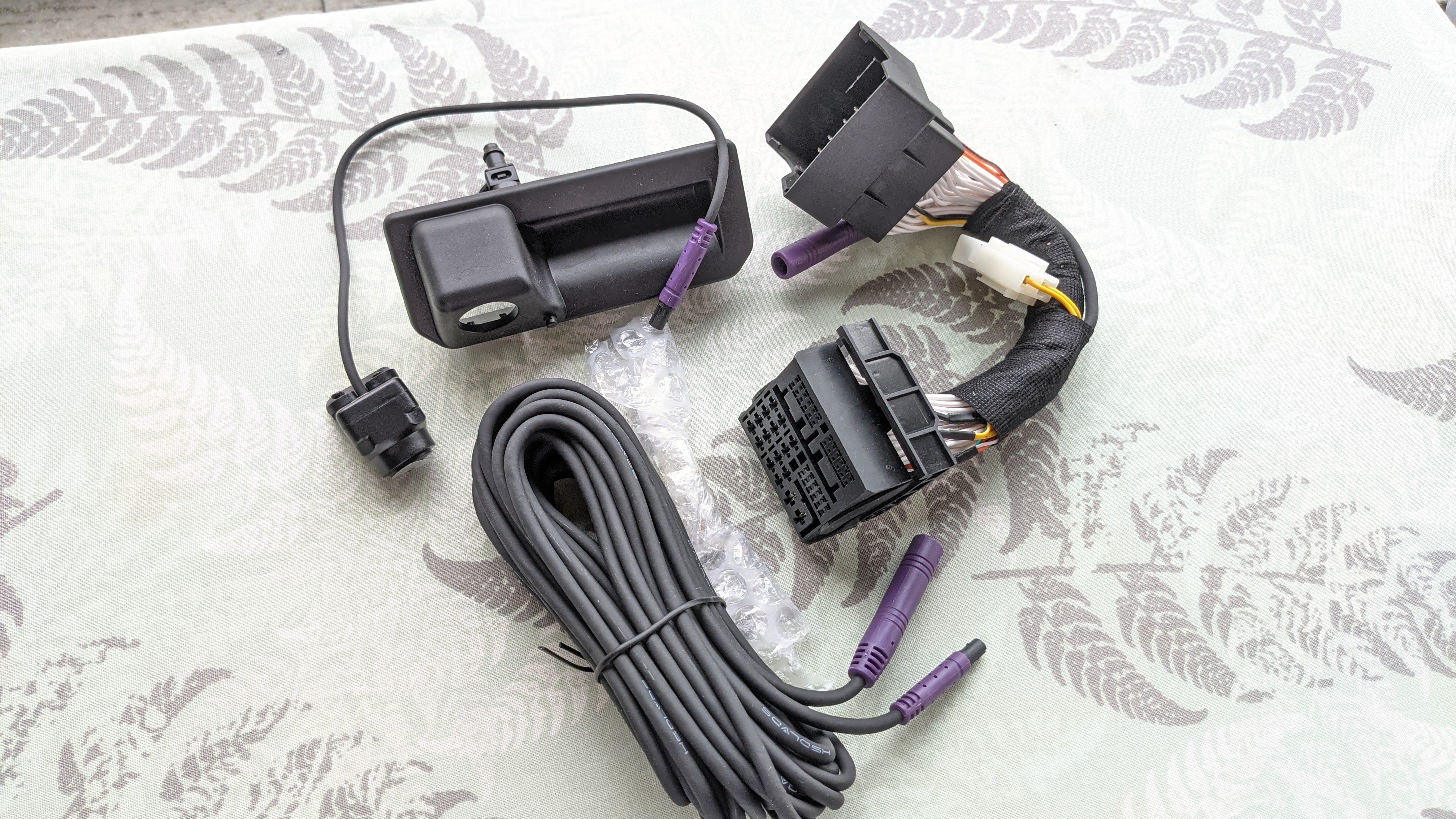

  3. This is what I found under "System info".
