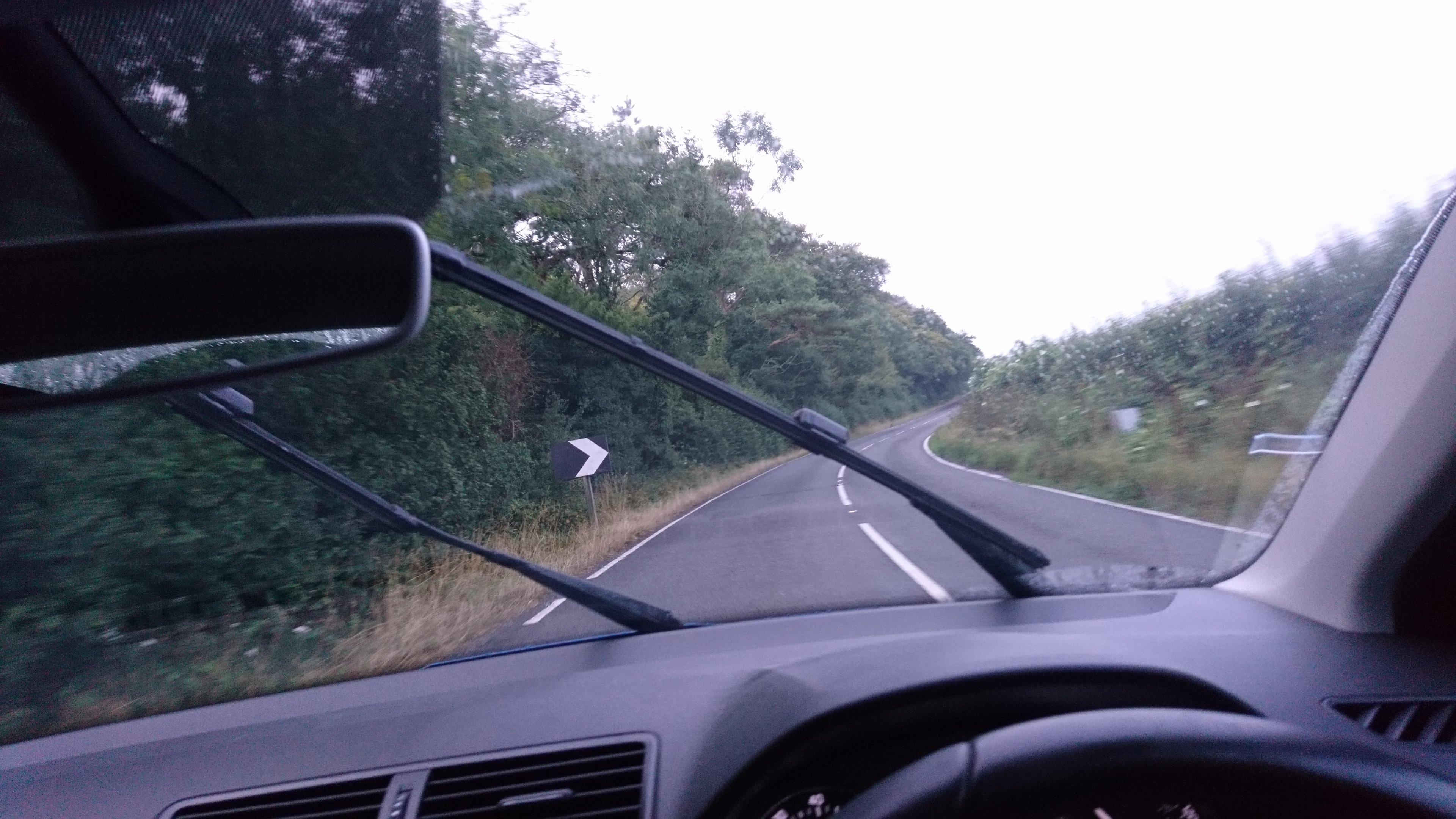

  2. Thanks for the replies, and sorry it's taken a while to respond. I haven't had a chance to measure the battery voltage or check with a scan tool yet - both good suggestions (though I would be surprised if the battery was the culprit). The service position is with wipers vertical, different to the position they stop at, so I don't think that's it. The stalk issue is an interesting idea, particularly as it's a common fault and the fault only happens in the intermittent position. Thanks again, will check battery and scan codes and report back.
  3. I've had a problem with the wipers on my 2016 Fabia SE-L recently where on intermittent mode, the wipers sometimes stop at 45 degrees (see pic). It only happens on intermittent mode - never on continuous, or on single wipe. On average it happens every 7 or so sweeps, but be as often as twice consecutively, or as infrequent as one in 20 or so sweeps. Doesn't seem to be any pattern to it - e.g. how fast, how dry/wet the windscreen is etc. Each time it happens, I can either over-ride it by selecting continuous wipe, or wait for the next intermittent wipe which completes the cycle and stops the wipers at the bottom again. When it happens, I can hear the relay click, as if it thinks it has completed the cycle. I'm thinking it's something particular to the intermittent cycle, as it never happens otherwise. It seems odd that it doesn't ever happen on a single wipe, as I'd assume the operation is the same as a single wipe as part of an intermittent cycle. Anyone have any ideas? Does anyone know how the mechanism detects that the wipers are at the bottom to end each cycle?
