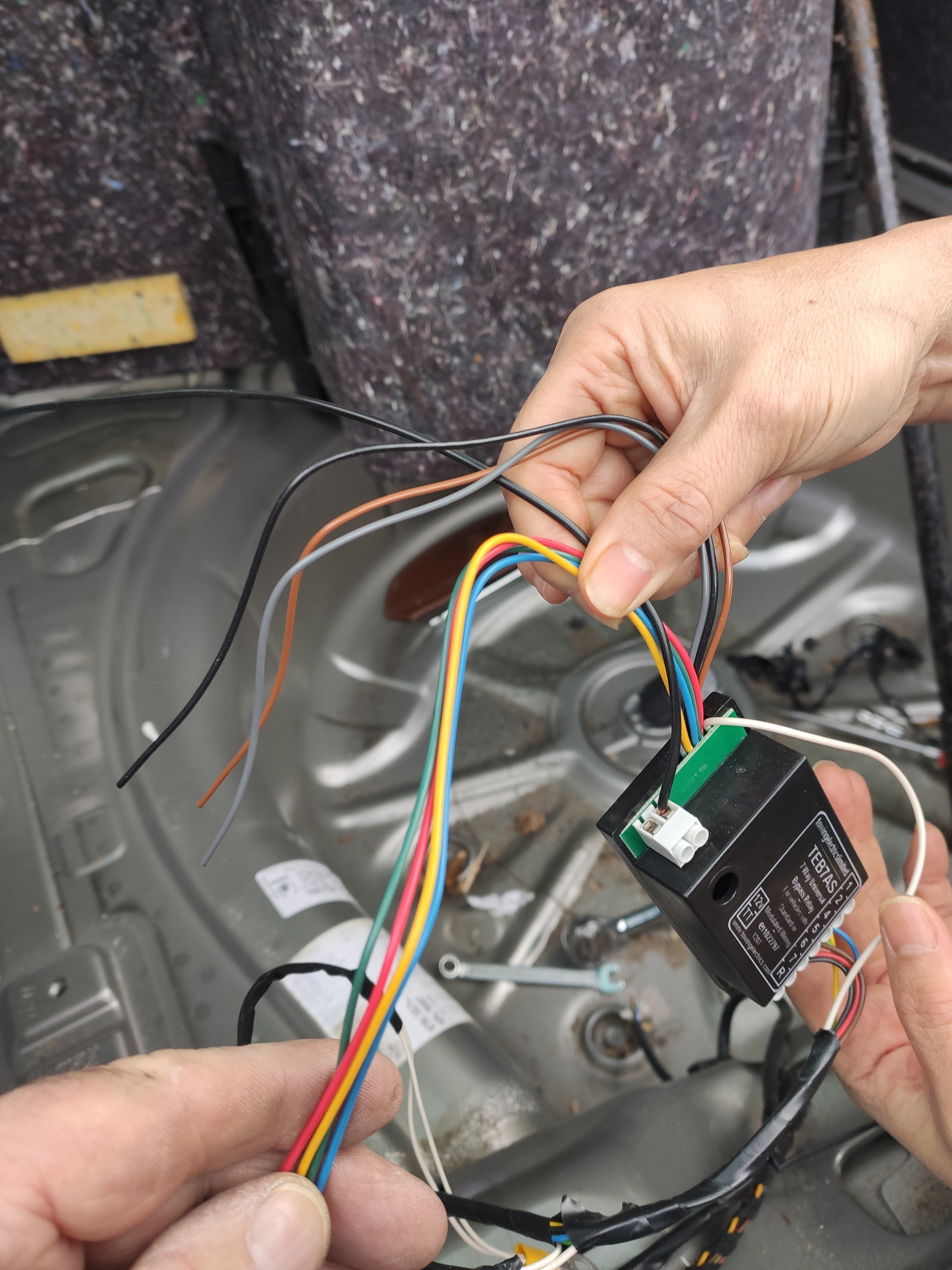

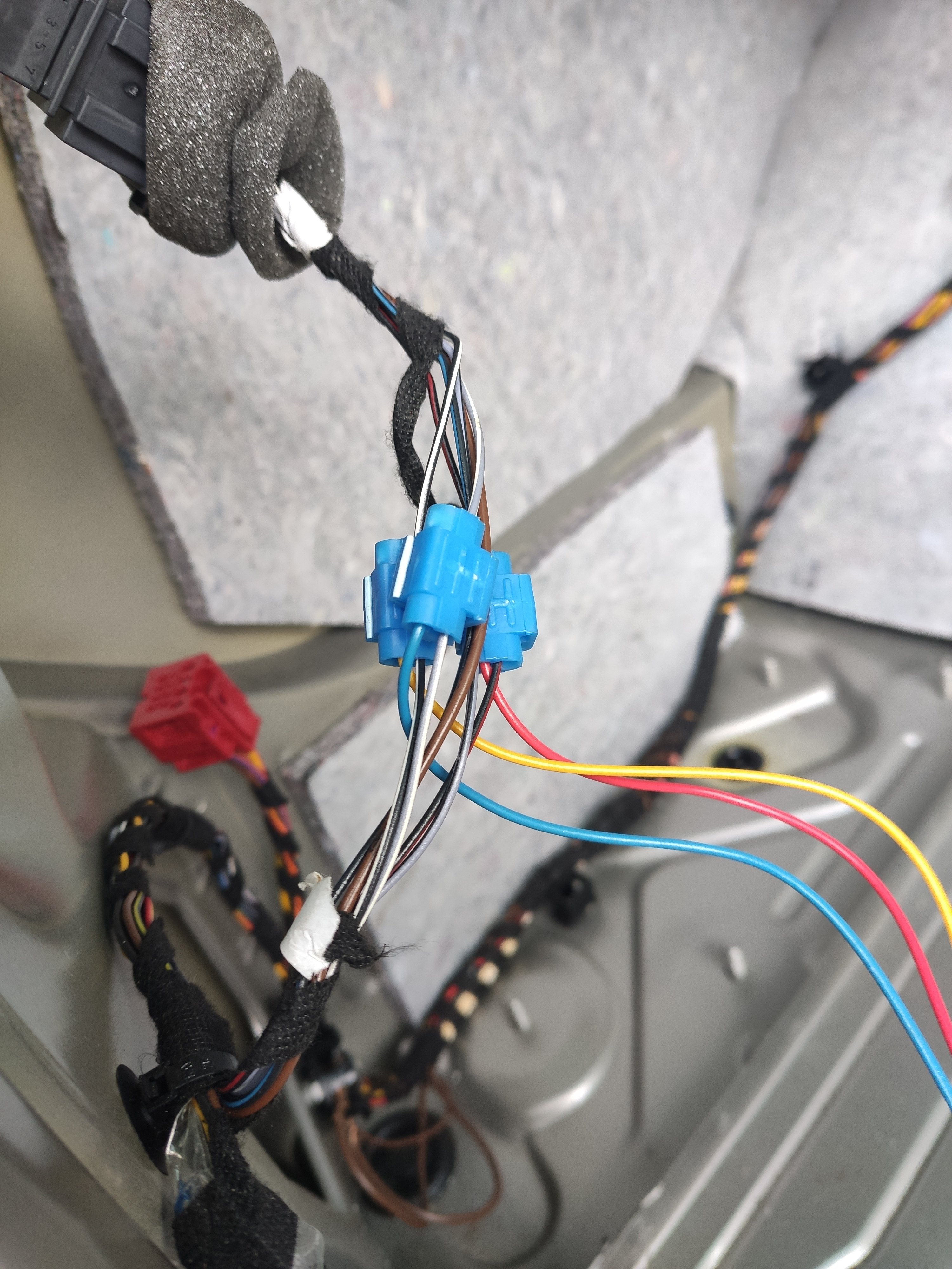

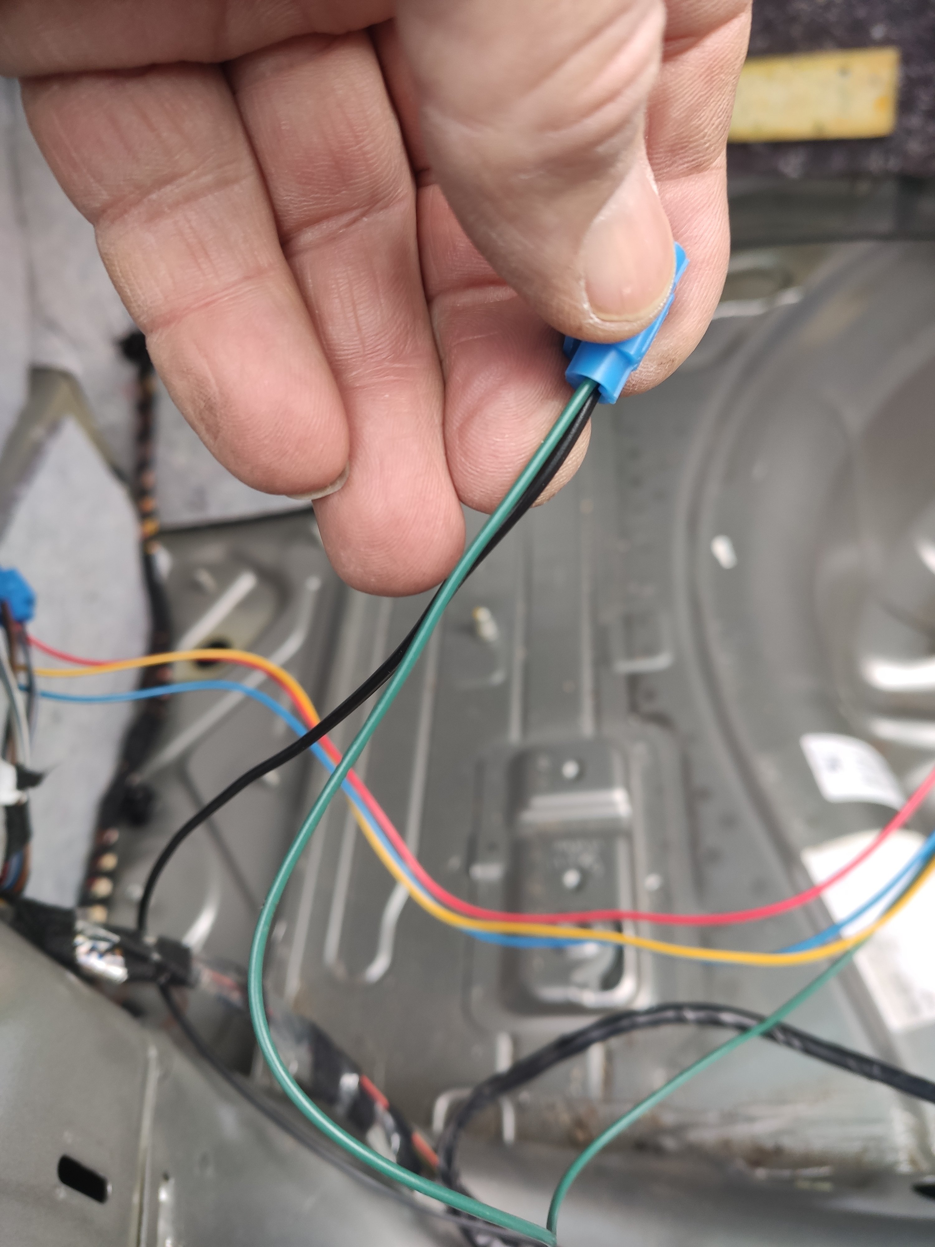

  9. Right, done it and thanks again Derbyshire bod along with others. 'Done it' meaning that I pulled the back of the car to bits snapping off various plastic lugs in the process. I can only assume that the bloke that took his apart and made the video had done it so many times that all his plastic detente bits and clips were broken off and missing anyway. So to report upon my findings the relay box was tucked away and having removed it I have found that everything from the drawings and pictures supplied comply. The BLACK BROWN and GREY are not used and capped while the RED, YELLOW, GREEN, and BLUE are all connected correctly into the harness having followed Derbyshire bods rear light cluster picture and comparing it with my own, and wiring. The green, as was suggested, has been connected to an individual line leading to the driver side. I was disappointed that mine is also connected to the auxiliary 12 V socket in the back minus a fuse so I think when I put it all back together I will install the relay inside that that covered storage space along with a fuse holder so that in the event it all ****s the bed again I can change it without dismantling the car. So the verdict is that the relay is malfunctioning? Correct? I don't see how it works anyway with this sidelight and brake feed being common. EDITING: If it's a question of the relay recognising resistance have I unnecessarily taken the car apart because the cause is my fitting LEDs in these rear clusters? FYI harness black & blue goes to Blue (reversing light), grey & white to Green (fog) brown to 2 x Black (common), purple/grey (my eyes) & black to Brown (lights), black & red to Red (brake & lights) black & white to Yellow (indicator)
