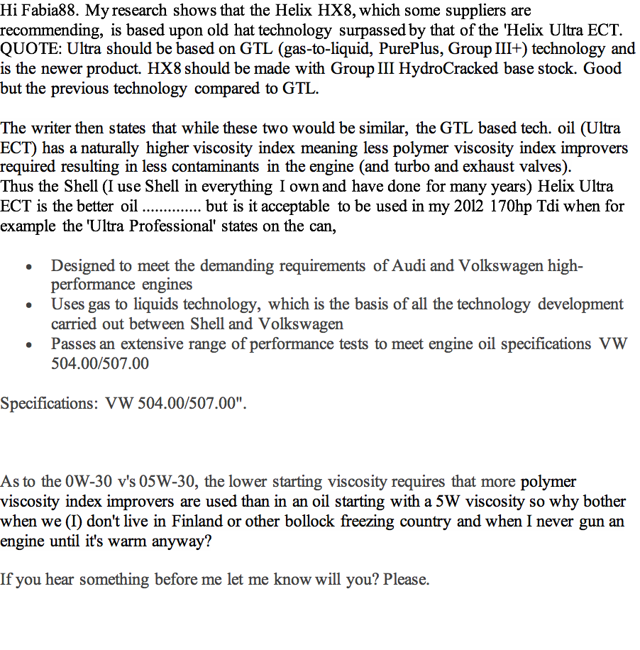

Members, Not interested in anything other than Shell and only 5W-30 (not 0W-30). The only light shed on the matter of choice has been reducing the build up of deposits in turbochargers and intake valves through a difference in viscosity index improver polymer. The question is then - because I can't find an answer or sufficient information to enable making a choice - Shell Helix Ultra AV-L or Shell Helix ECT C2/C3 and why one is the better option for a 2012 Superb Tdi 170hp with 103,000 miles? Thanking you in advance for your experienced, knowledgable input.
