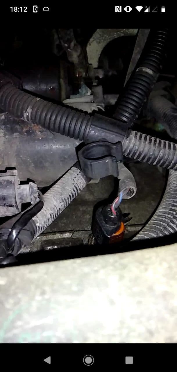

@Wino Here's the vid, but I am not sure whether it ever goes over the cable you seem to talk about.

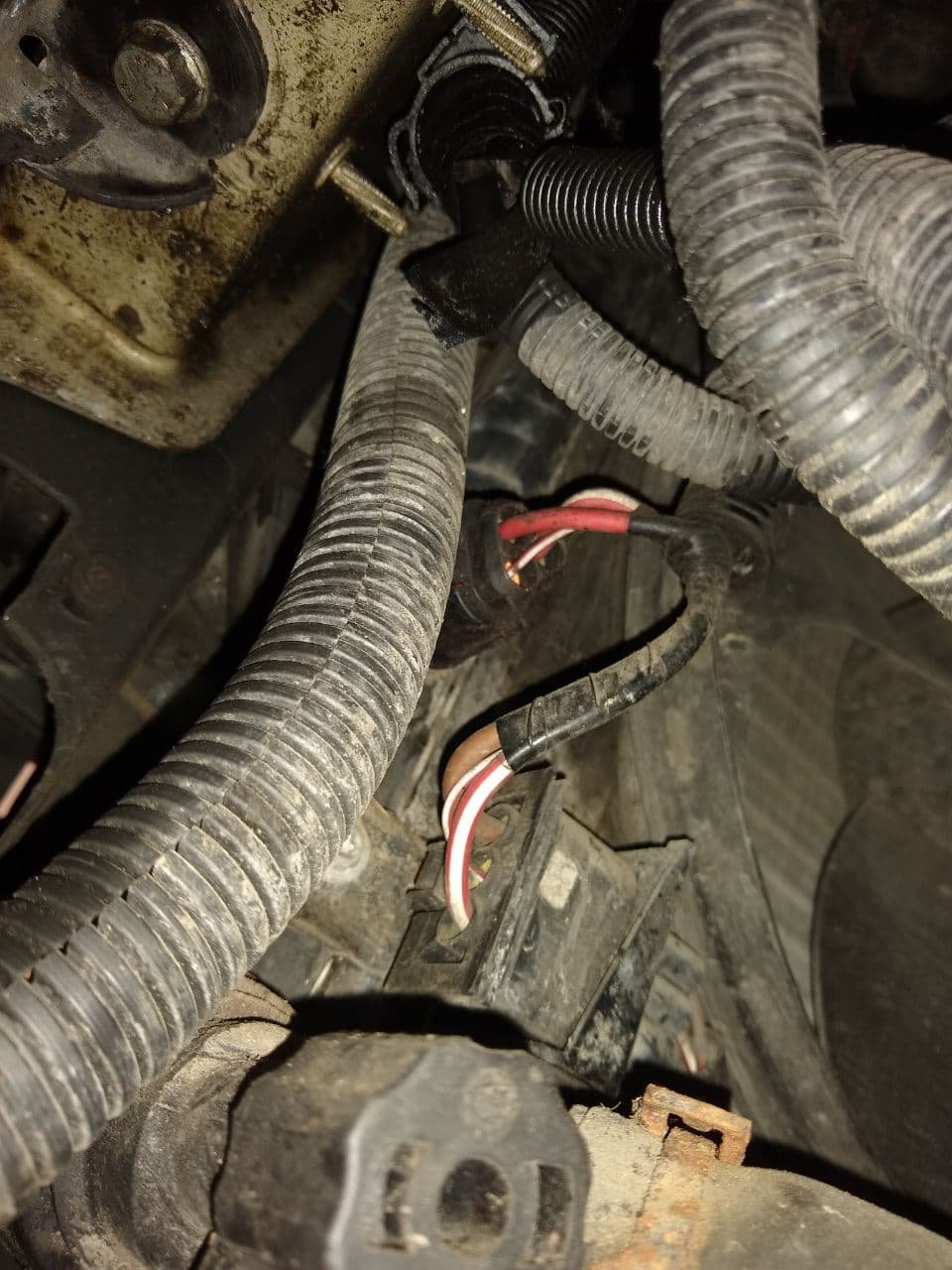

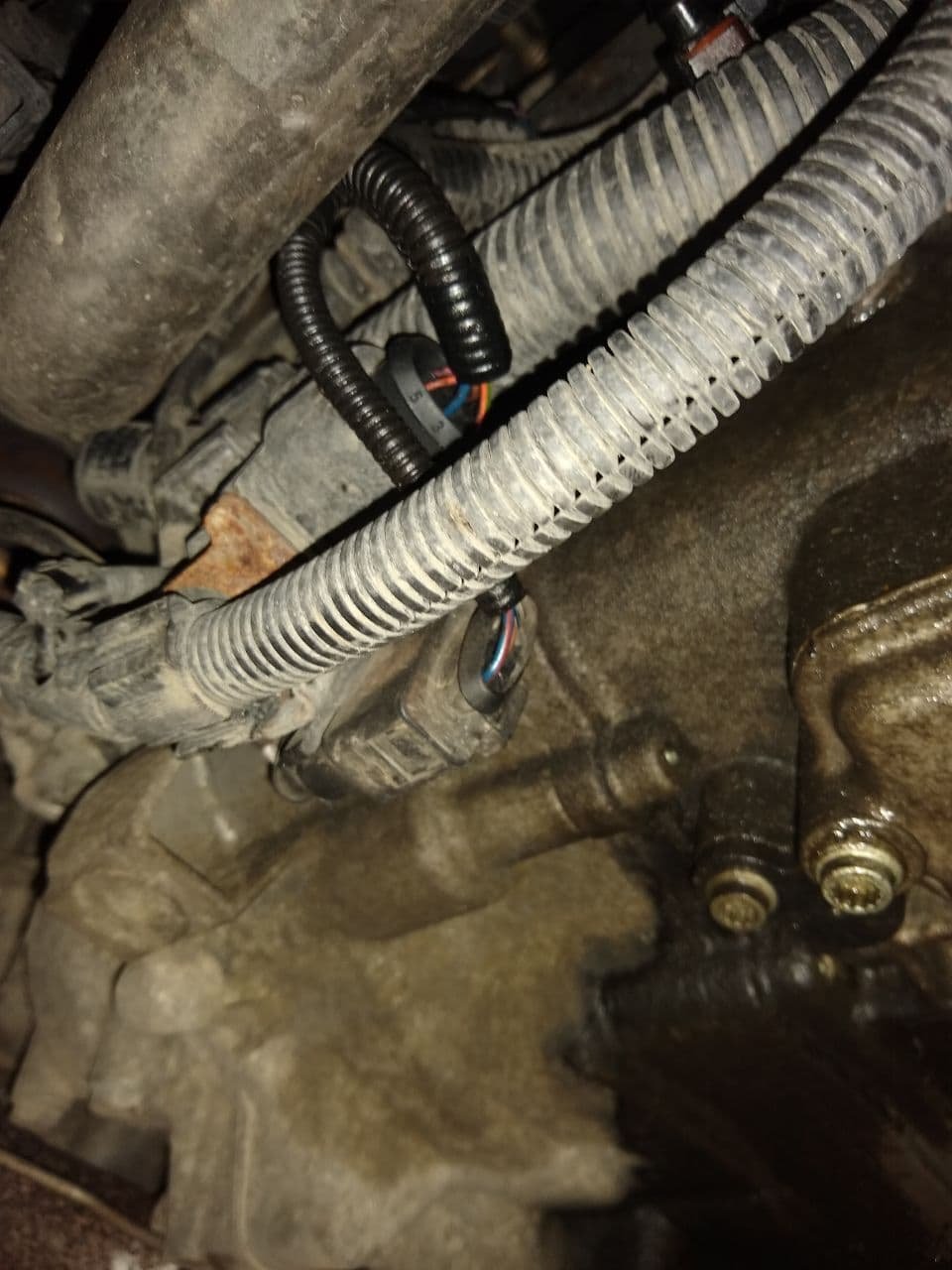

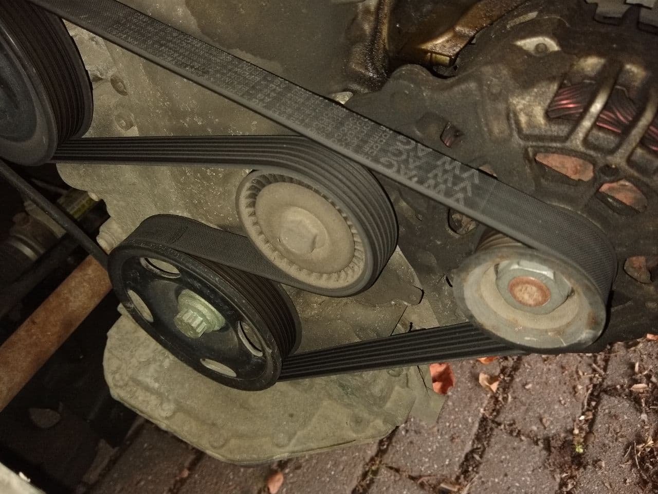

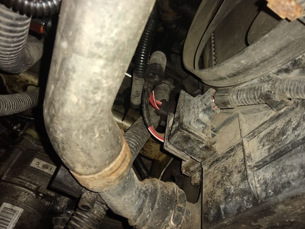

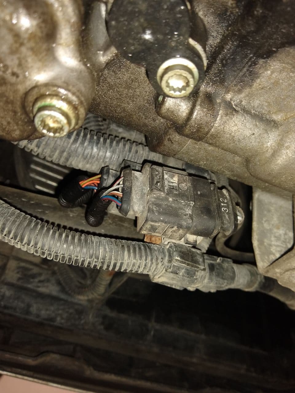

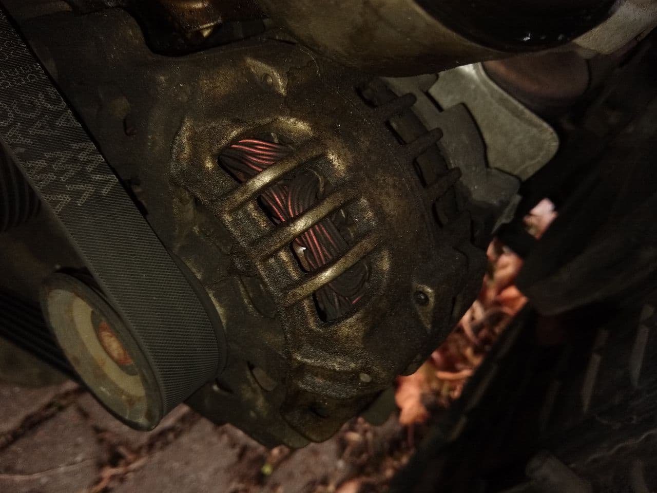

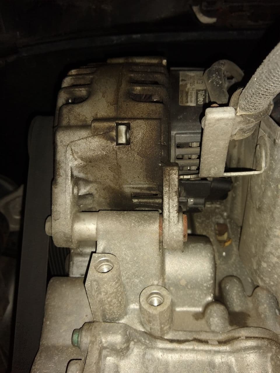

@Wino I found a place which lets me use a lift for 12 per hour, lifted the car up and looked for a broken cable everywhere but couldn't find it. So I took a picture of every cable I could find... and also the alternator. I looked pretty clueless so some guy came up to me and also tried having a look then told me he had a similar issue caused by a blown out fuse. But honestly I am not even sure whether I was looking at the correct cable? Turns out I am pretty bad at this and everything looks the same to me 😭 Thank you for your continuous support... do you see anything in the pictures? I have more & also took a video.

@Wino Tried using a phone to see underneath but wasn't really able to, so I'll need to pay for it to be lifted and look at the cables then. I took a picture of the alternator but not from the cable side so I guess that's entirely unhelpful. I am just scared that even if I lift the car, I won't really be able to to tell what a damaged cable looks like, I've looked around and the post that people point to https://www.seatcupra.net/forums/threads/how-to-fix-broken-load-signal-cable-from-alternator.209472/ , no longer has the pictures. For fixing it, I assume I can just follow any cable fixing tutorial and use a solder to connect the cables together, however, as I am reading this forum I realize the reason the cable breaks to begin with is that it's too short, so will I even be able to rejoin it, is there some way to lengthen it? Finally (and sorry for asking so much) I've just gotten my multi-meter and tested the battery voltage, when the engine is on, it's actually perfect right around 14.25, so the alternator seems to be doing it's job.... Is this normal even when the sense load & exciter cables are broken?

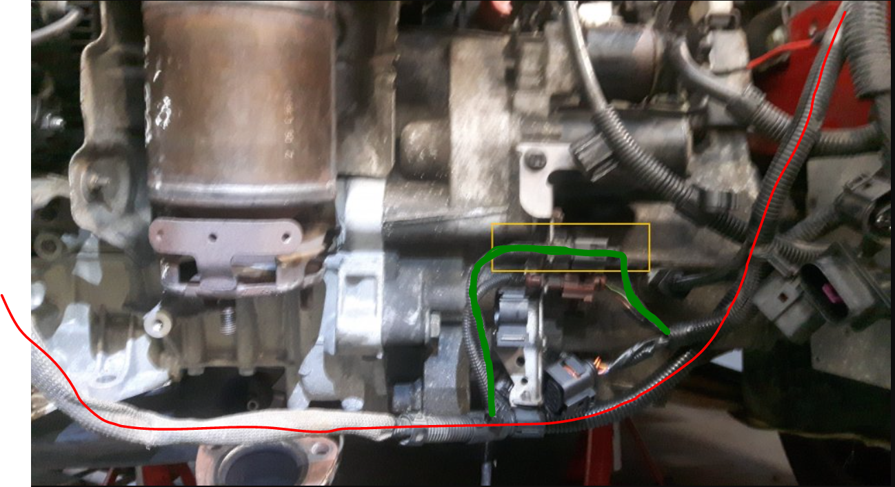

@Wino Oh, so the exciter cable and the DFM cable, are connected to each other? Would I be looking for visible tears and the like in the entire length of the cable (highlighted red) or only the (highlighted green) part? As for the voltmeter, unfortunately the cigarette lighter doesn't work at all in my car, probably a completely unrelated issue as it's all ****ed ****ed up looking. I've bought a multi-meter and will try to test everything on Saturday. Then I'll try to get to a place where I can lift up the car and inspect all the cables.
