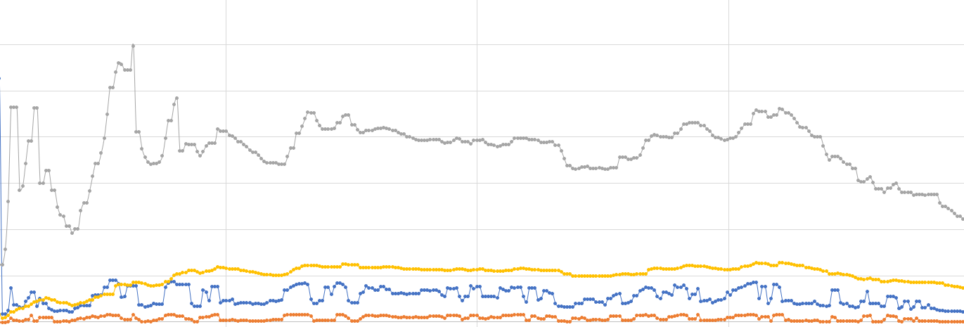

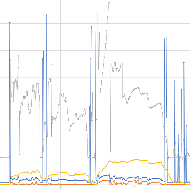

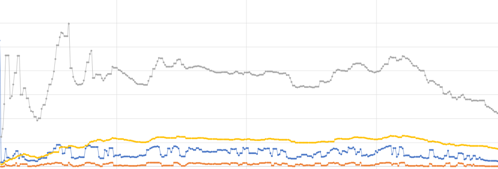

Few points because I couldn't find them on here before: MAF readings do rise when engine idling, not sure why but they are reading ~550 g/s when stopped/slowing down as shown below (maf is blue, revs are grey) town driving Sliproad and motorway driving (same route as earlier graph (maf follows revs pretty much) Normal driving values are ~20-40 g/s Motorway values are 40-90 (90 being hard overtake accel +70mph) My old one was spiking (but not constant as above) and not reading above 35ish on the motorway. My max boost (for that journey) is 16psi The sudden jerky motion when taking foot off/putting on of the accel has stopped completely (following the maf change) and the drive seems much smoother now.

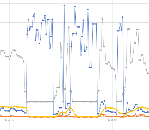

Vac pipes are good I believe, garage checked them over and I have recently swapped the brake booster hose as that had a split a while ago (was fun stopping a ship with no help!) I'll get the maf out and test it over lunch to see if there's anything obvious, sadly the m1 was standstill today so not a great recording but one thing of note is a very peaky maf recording (driving around 30ish but peaking to 600+). Used the torque datalogger to make the quick and dirty graph below. Small snippet of a 30mph road and then the m1 slip (not perfect due to other cars but the spikes are evident). I'll try again on the way home (sadly mostly downhill so not as bad) I can give data if anyone is really bored but just to show the general behaviour Grey = revs Blue = MAF (g/s) Yellow = Speed Orange = boost (psi) MAF is generally around the 30 mark but the peaks are 500+

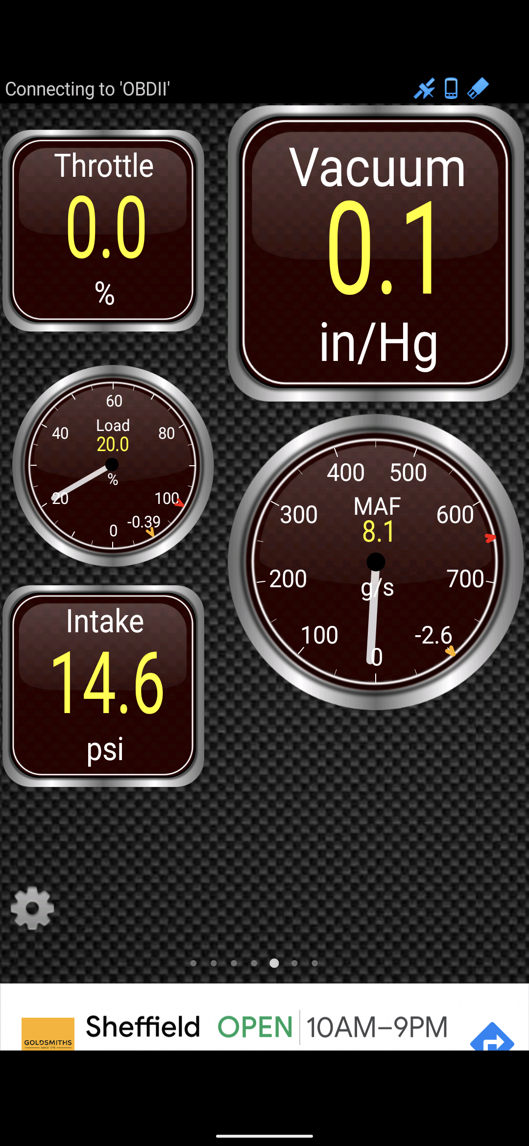

Thanks for the detailed reply, I think the throttle-boost relationship was correct upto 3rd and then it started falling off once on the motorway, foot flat and the speed is just dropping off to the point I join the lorry ranks. I was watching the turbo and vac gauge, it defaults to vac when idle it seems in the image above. I'll log my commute tomorrow (centre of sheff to Barnsley) so can hopefully give a clearer picture of numbers rather than quick glances. 1- unmapped when bought and honestly just thought this is what a 20yo car was so wanted to try and make it fun whilst it lasted. The map was a very cheap one (from an alright place) so they only checked for errors and then flashed it, barely started engine. (Car was only £800 to me so didn't want to throw a £300 proper map at it) 2- map actually made it a bit better! Was sluggish before but think the map made the throttle a bit better 3- not 100% how the mapping works but in my head they took a copy of the original and sent it off via some online service and got the tuned one back. I've been reading alot of forums with TDI issues and some have been similar symptoms with blocked up cats etc so could be! Would be nice if it was (nice to have a simple solution, not nice to spend money). I can look at how hard it would be to take the backbox off and see what it does.
