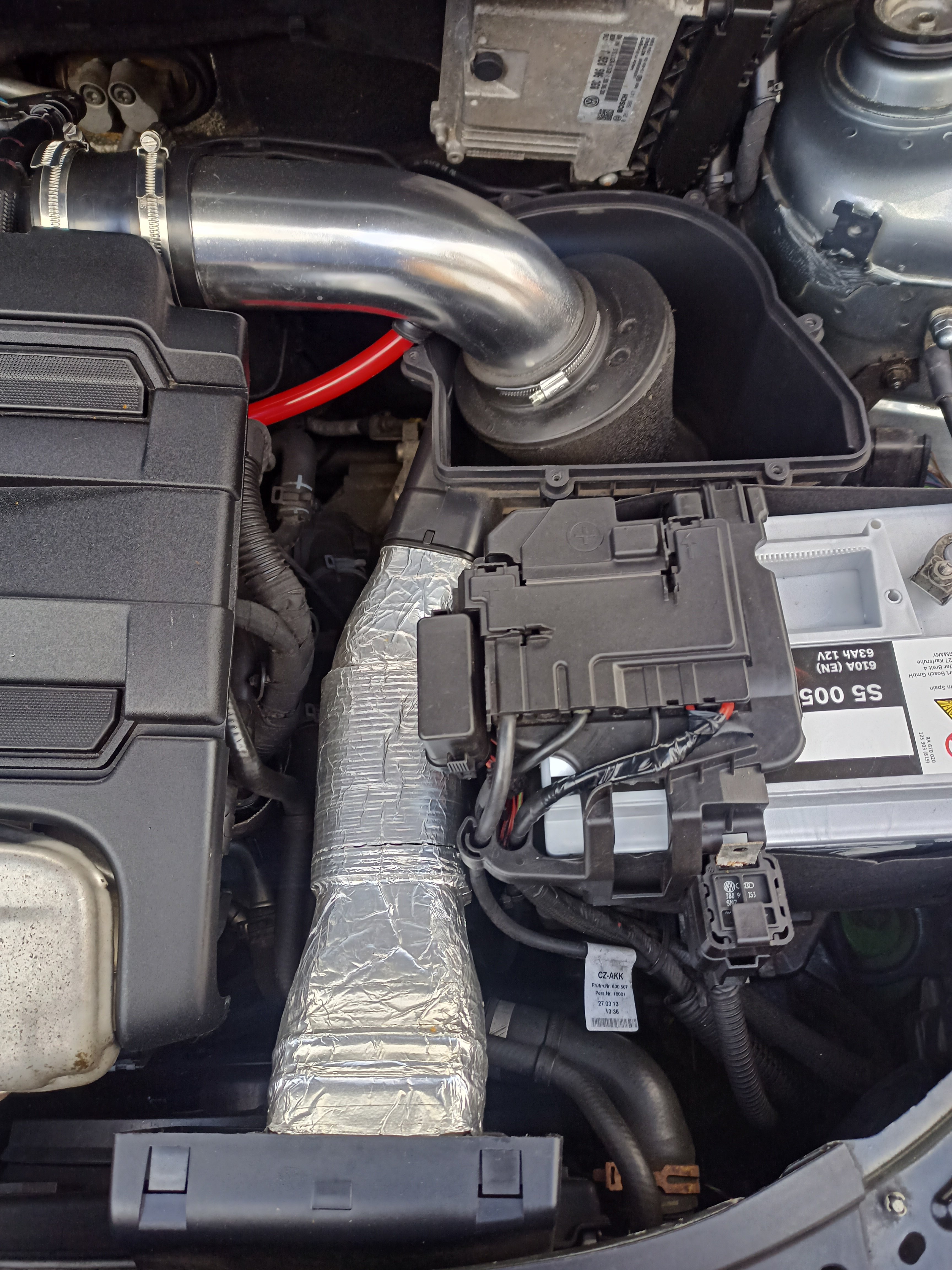

  3. Hi, it is a 13 plate in grey, last numbers are UBU if that helps anyone, My initial thoughts were it had been mapped, with it having the "induction air filter" fitted and the upgraded exhaust,,,it has been on the dryno and got 194, as mentioned by others it may have been mapped but 194 with additional mods seems poor, when I have read as you mention some seem to have higher output as standard, I will do some more investigation... Photo of filter
  4. Thanks The original ducting is still in place,and has been wrapped in foil, I assume to keep the temperature down on the air flow, just that a ram, cone shaped or similar air filter has been fitted, Dark side are literally 10 mins away from me,
