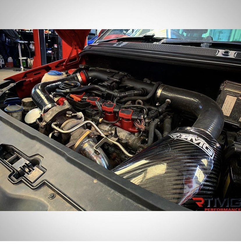

Either an RTMG replacement induction kit with battery relocation kit or , an ITG maxogen

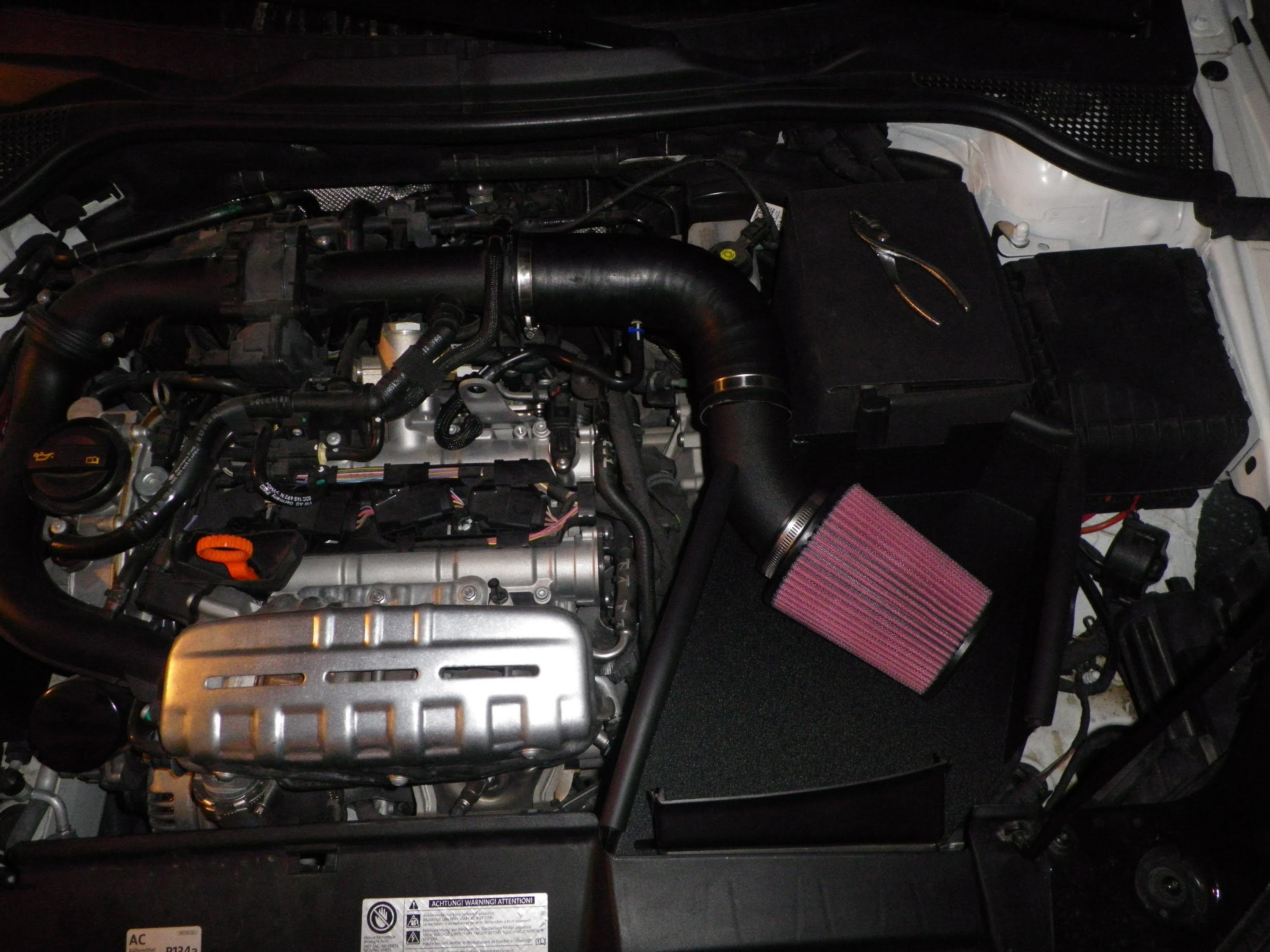

Photo of filter
Some kitten has removed the lid to try and get it to make silly noises, not for performance.
People fit induction kits so they can go "Bwaaarrrrrrrr" and pretend the car is faster, it's the placebo effect.
All kinds have been done.
Some people put the cone in after removing the battery. Or turning it, or fitting smaller ones.
So forward, with better intakes,
or on the Polo GTI Twincharger the batter was in the boot.
As it is in Summer the area where the Air Filter sits behind the battery gets very hot and sits and there is heat sink.
As it is there are ways of getting cooler air in and ways of more noise, and ways of better performance.

RTMG,FORGE, RACING LINE OR MST for the filter.

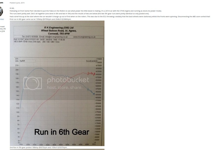

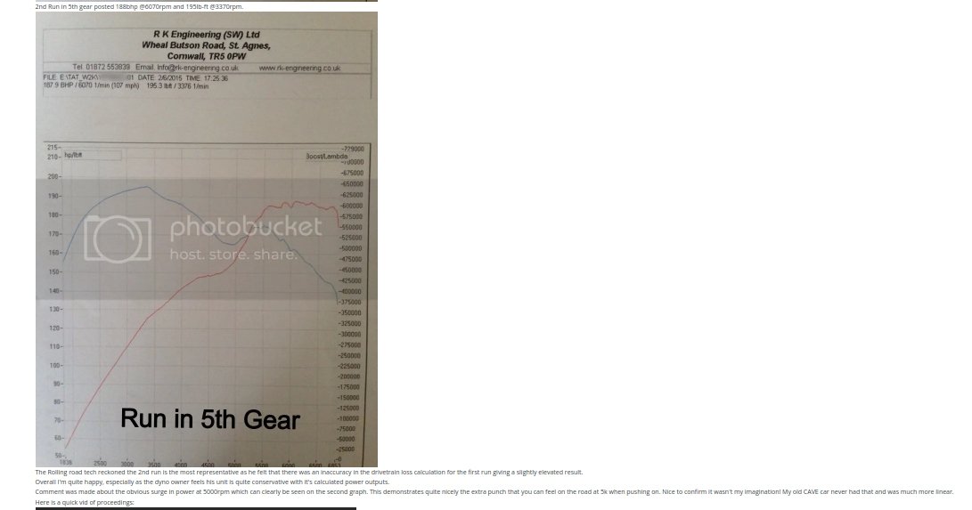

194bhp sounds an odd figure to be fair as usually a stage 1 remap is around 210bhp, Where was it dyno'd?
@FurbytomHad the Dyno done on a Factory standard 2014 CTHE.
Maybe there are members that have had their car on the rolling road that want to show what their standard car did.
http://briskoda.net/forums/topic/327528-mk2-fabia-vrs-rolling-road-post-yout-graphs
Some standard CTHE's here including @sharkrider& @Furbytom

Dyno calibration is incredibly finicky, engine dynos are far more accurate, however if you're planning a sequence of modifications then a rolling road can be useful as long as you use the same one throughout and you tell the operator that you are only interested in consistency for comparison and not the actual numbers themselves.
An operator can program a dyno to say whatever they want it to say so you can largely ignore the figures, suffice to say that 194BHP is a standard engine and the daft foam filter and the missing airbox lid aren't doing the engine any favours keeping the intake air cold and clean.
