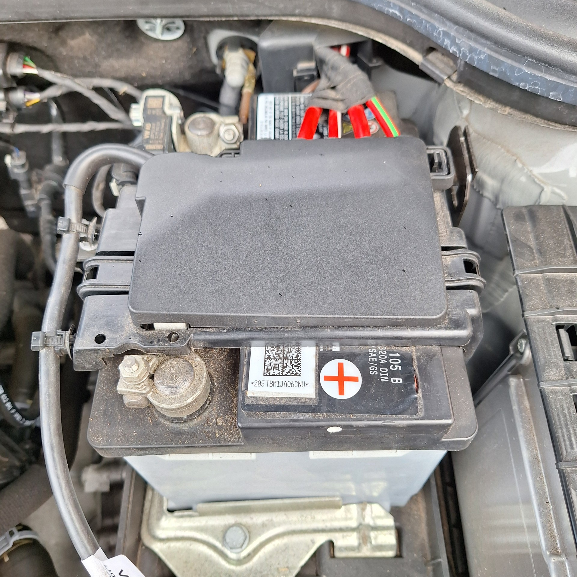

  14. Thanks again for all your replies. I won't be touching anthing at the moment, and will probably be taking it to somewhere I feel confident they know what they are doing. Still can't believe a comany which I previously described, doesn't know what they are doing though!. Here's a photo of my battery, I have removed the positive cover to try and show you the connection from terminal to this connection box on top
  15. @EMike perhaps it's just me, but I'm confused. The battery information, on the top, should be accessible without removing anything? Perhaps I need to take a photo, but the battery postive goes to a plastic box that sits on top of the battery and has plastic clamps either side to secure it. From here I think there are 4 fairly large cables, connected to this, that go off into the car electrics.
