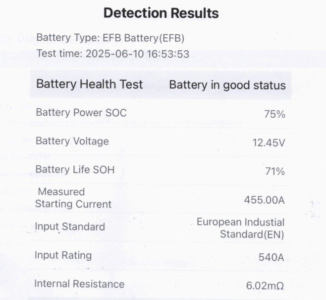

  1. When I got the battery tested it was down to 71% of it's performance when new. I believe 70% is when a battery is classed as "dead" / in need of a replacement. The dealership initially said that batteries are not covered under warranty, but after some pushing they agreed to replace it. This was a couple of months ago now and since the new battery was installed stop start has worked flawlessly and I have not seen a return of that particular message.

  4. Thanks for the reply, I will try and add a bit more info based on what you have said (although I am far from a car expert and a bit confused by some of the points you mentioned here). Car Details as follows: - Year - 2019 Model - Kamiq Trim - SE L Engine size - 999cc Fuel - Petrol The guy at the garage seemed to think that it was probably the original battery from what he could tell, but I guess you can never 100% be sure from a visual look. If I am understanding your question correctly, when they did the scan, they looked at the values on the battery label and entered those as the parameters before the test started, rather than looking at what had been coded for the battery. I will send Pete a message to see if he would be able to assist and will post back if he is kind enough to assist. I am wondering if at this stage, with all the faffing round it it's just worth cutting my losses now with the dealership and replace the battery myself as the percentages here seem to imply its closer to being a "bad" battery than a good battery now.

  7. I found that when comparing the plug-in with multimeter direct to the battery, the values were not a million miles off. With what you have said above now though, I'm not sure what the next point of call should be, the dealership said battery was fine as did Halfords and I suspect all the dealership will again say is battery is ok, we can't fault it.

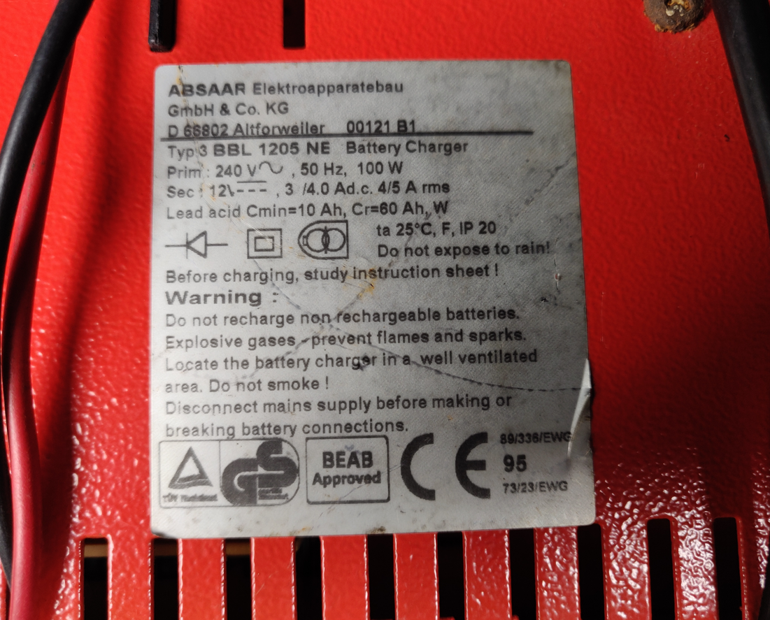

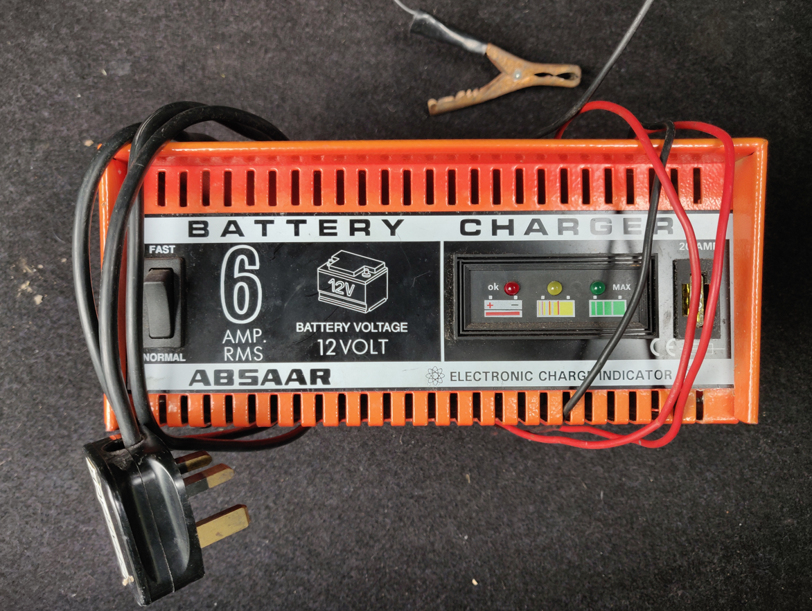

  8. Thought i'd give a quick update as it's been a few days since I posted. With the second external battery charger I used (which I know was working as it was used the previous day to charge a different battery - not fitted to a car mind - and reported "green-fully charged on that battery), I left it on overnight and it charged the battery to 12.7v*, but never recorded the battery as being full, as the indicator light remained on amber. Arrival at work (after 30-ish mins travel) battery remained at 12.7v*. After an 8 hour day, checked battery before turning engine on and battery reporting as 12v* Arrived home and battery reading 11.9v* However, each day this week, the temperature has been a lot higher and as a result, every day this week, the stop/start functionality has worked perfectly as expected. So, maybe there was never really an issue with the battery and it was, as implied by the dealership down to temperatures. One to keep an eye on I guess but for the time being, I am not going to think too much more about it and see how it goes. Thanks once again for everyone's advice though, very much appreciated. *(voltages checked with plug-in tester into cigarette lighter socket.)

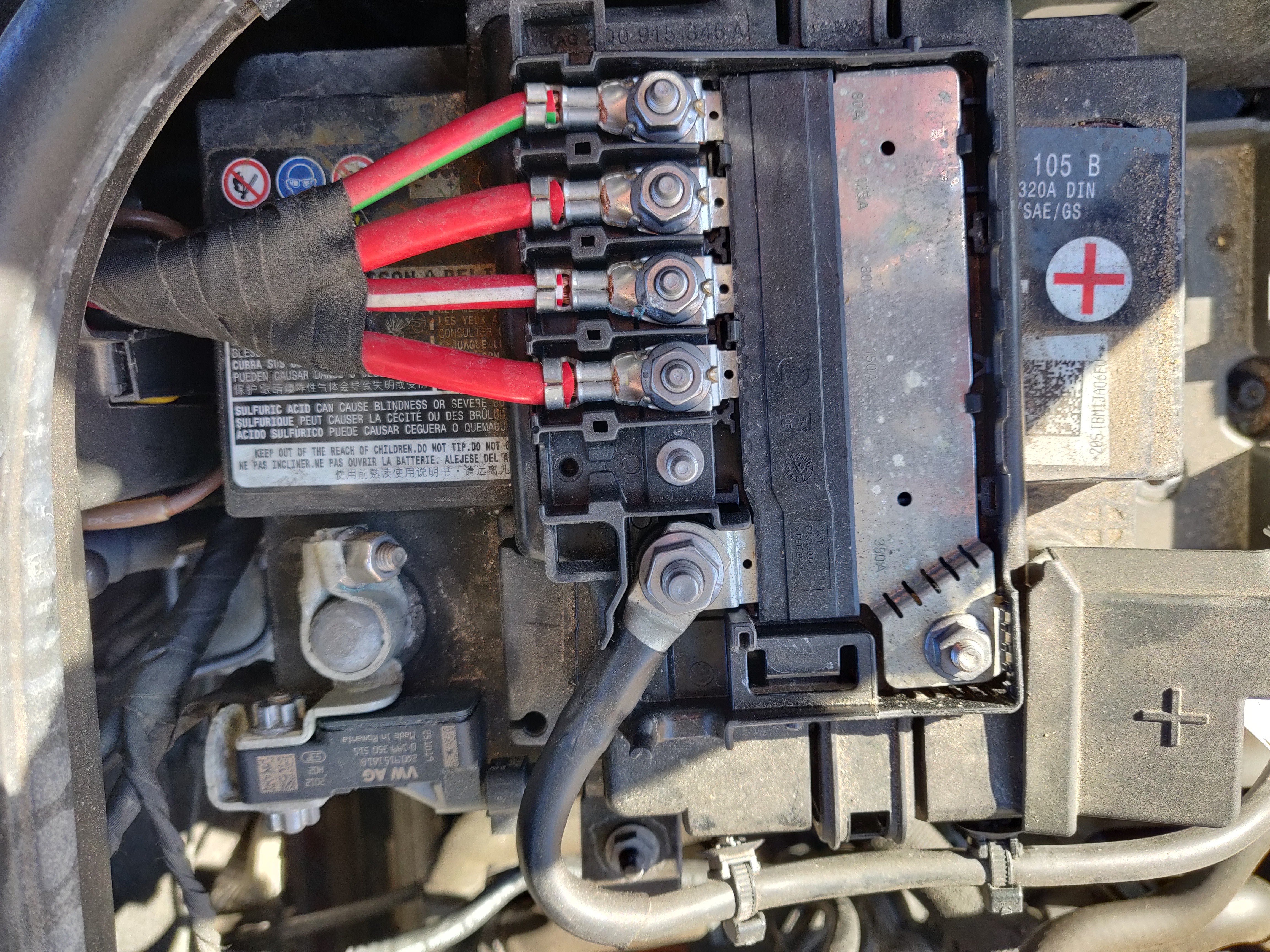

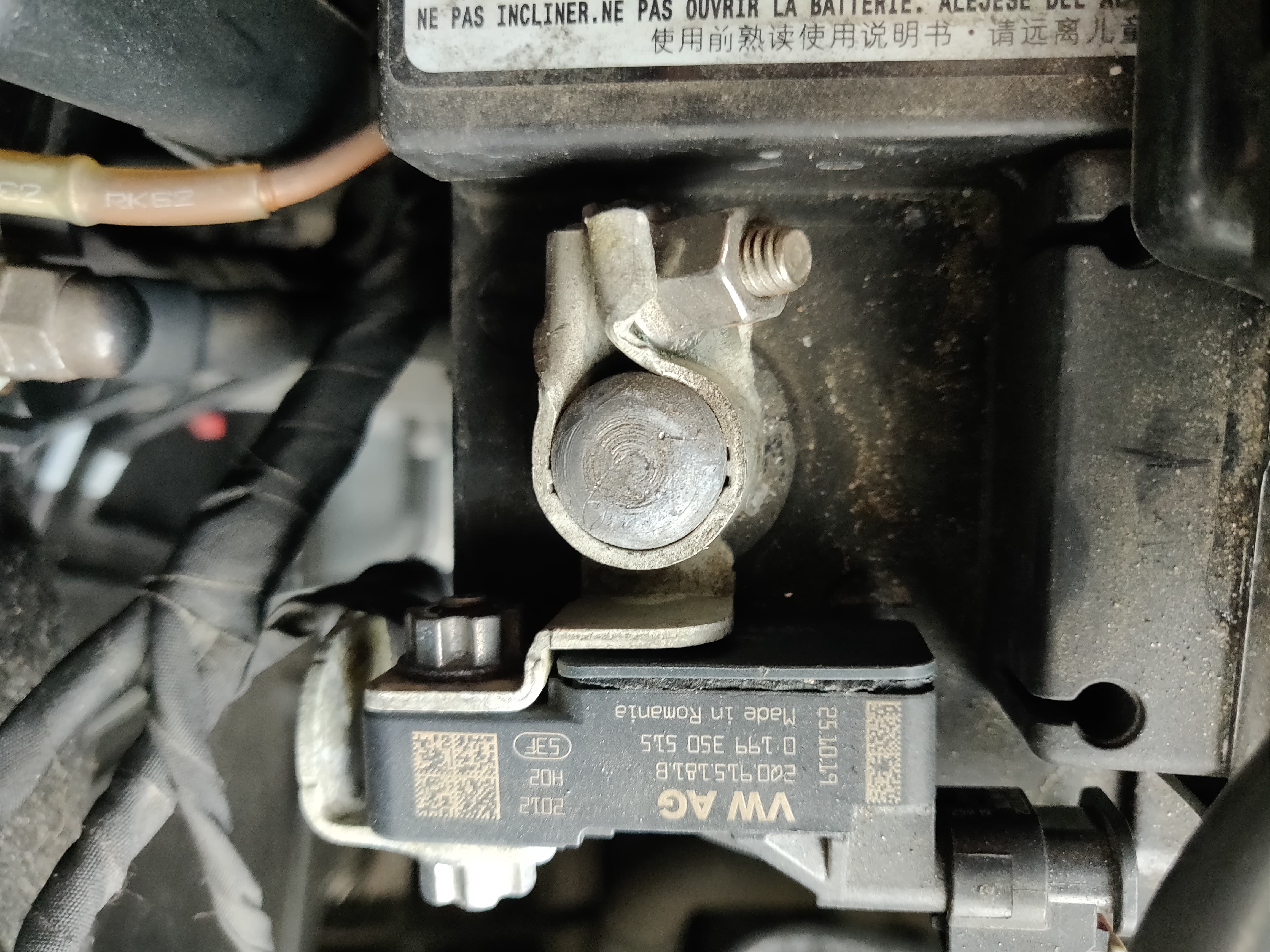

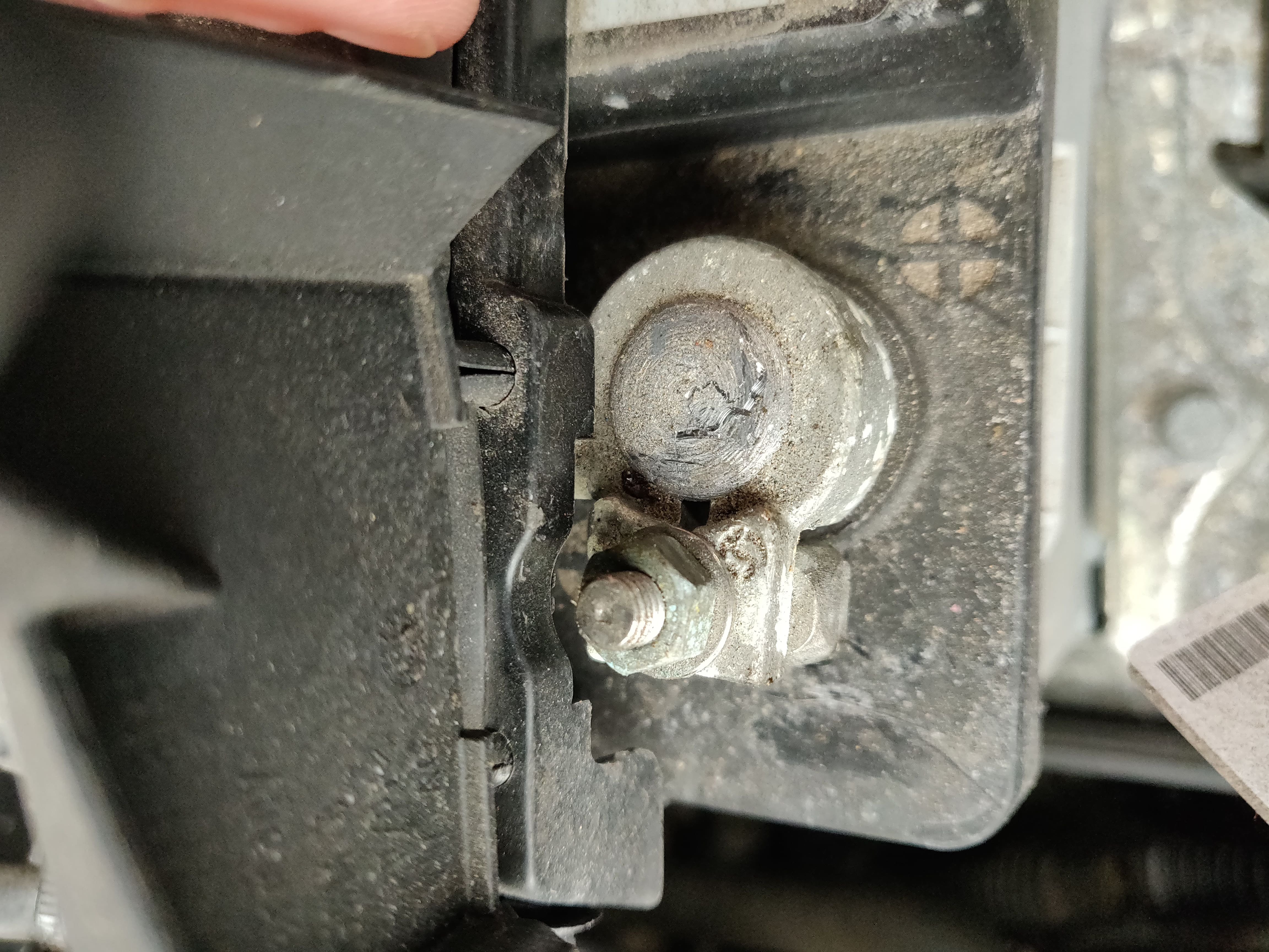

  9. Stranger and stranger with this now... Checked the reading before I set off from work at 16:30 and the reading was 11.9 (exactly the same as it was this morning). All the way home , stop/start functionality was available and working ! So I'm even more confused now. I've also found that the battery charger I posted earlier is faulty and not charging correctly (as confirmed by checking it in a fully charged battery) so I've got another one to try this evening that I know is working. It may not even be a battery issue after all this considering it was working again this afternoon and maybe it is just so so with the temperature at the moment....who knows at this stage (well I certainly don't!) Couple of photos as well of how the terminals look on the battery.

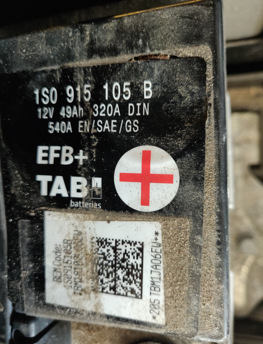

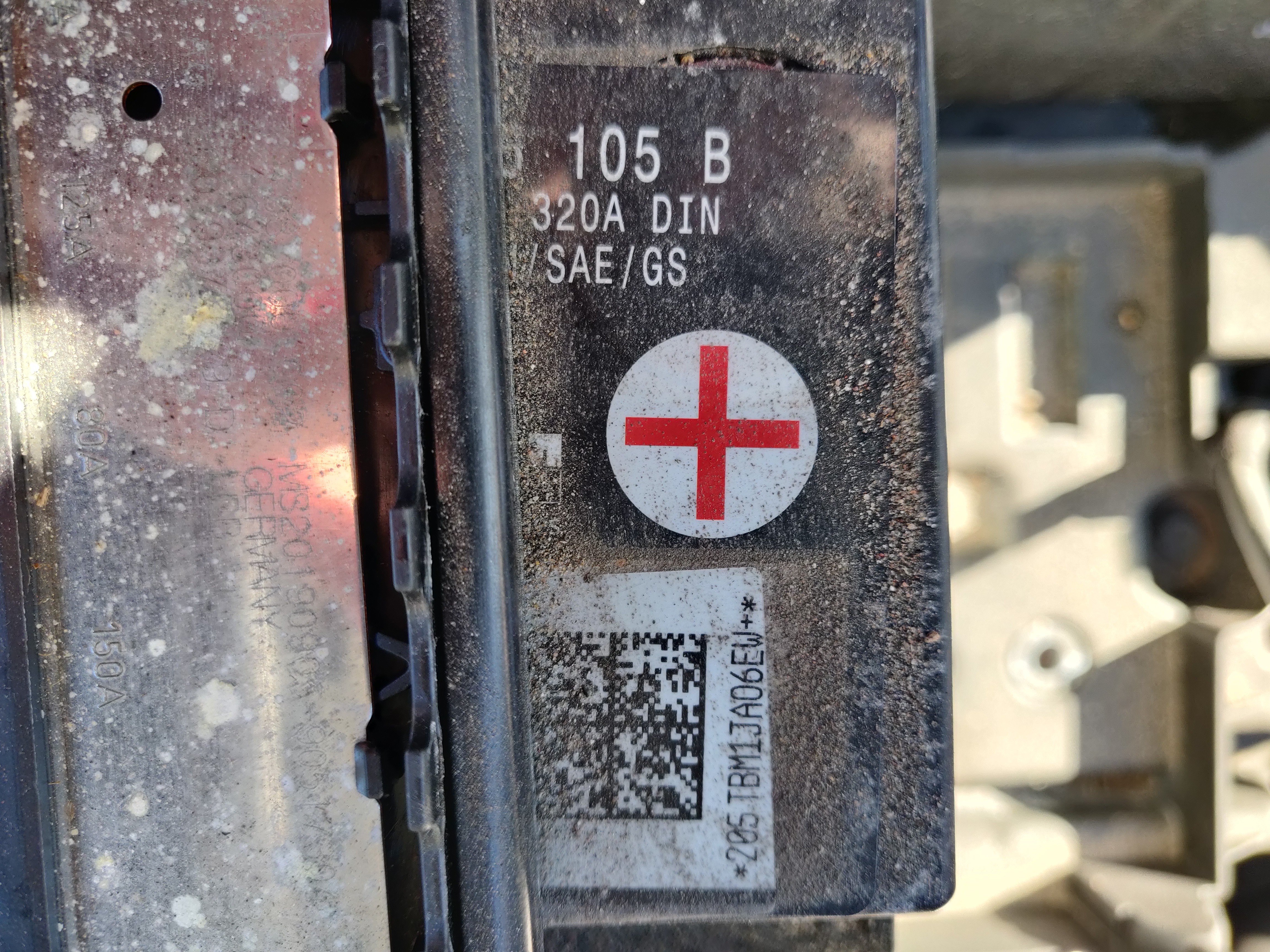

  13. Thanks again for all the new info, people here are great, especially to new people who probably ask age old question! I did check it again this.morning and it's still showing 11.9 with the 'plugin' volt reader and slightly higher with a volt meter directly on the battery. I've loaned a battery charger off my dad and I'll pop that on overnight tonight to see how theyit as it did indicate it needed a charge. I didn't see much identifying info on the battery to be honest, but took a couple of photos anyway of what I saw, maybe they are what you needed, apologies (Also, stop start did seem to work again today more regularly after the day got warmer, so who knows what's going on!)
