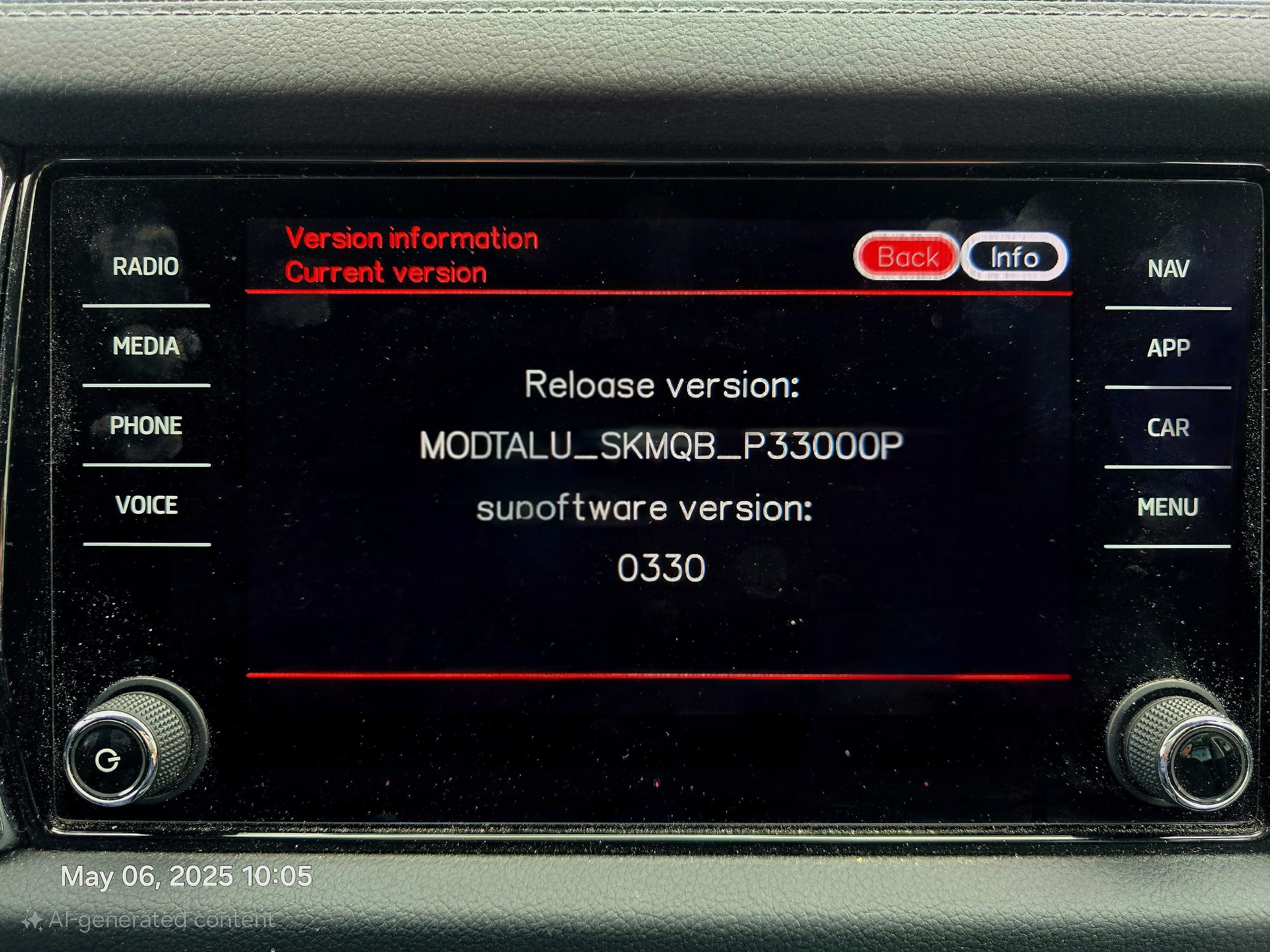

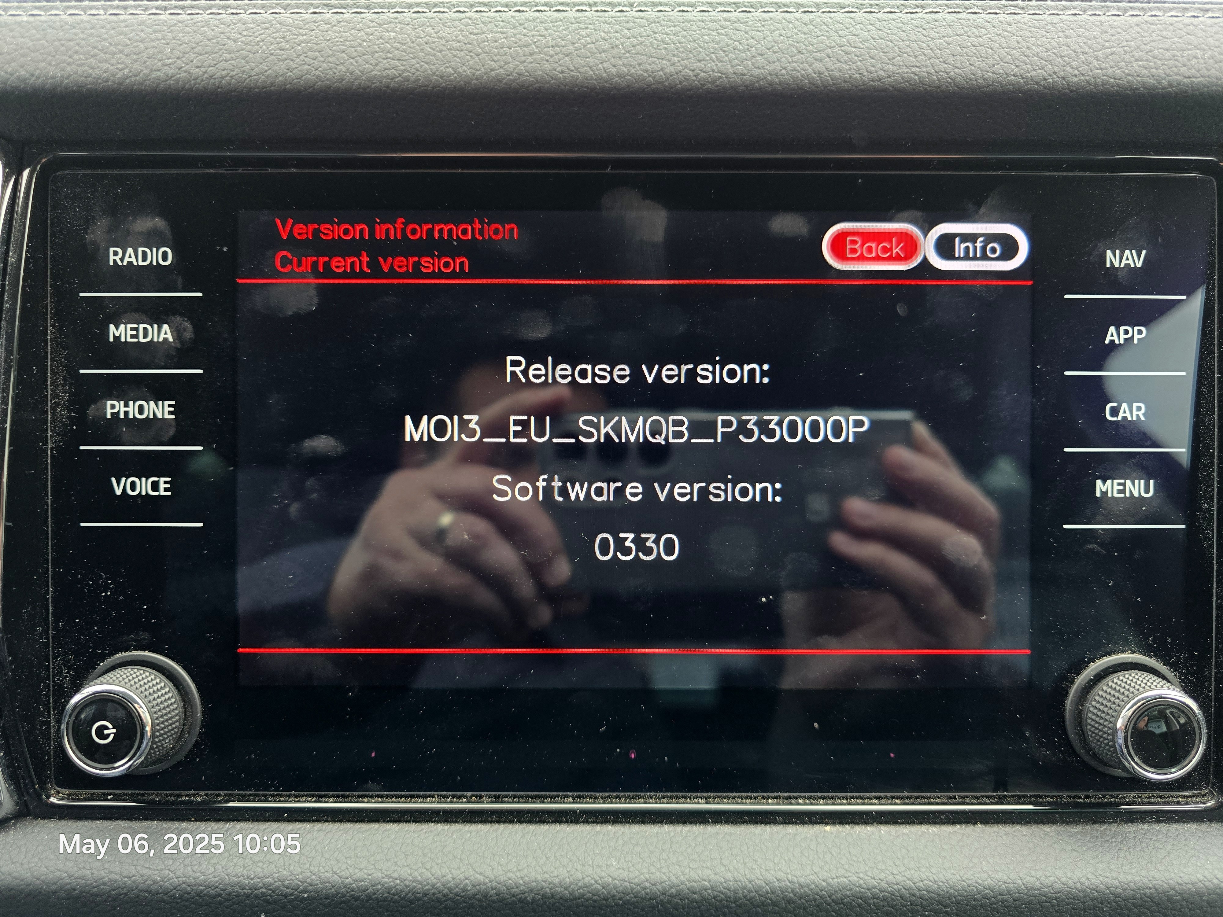

  12. Omg...I did not seen that....I was edit picture before uploading...I was erasing reflection and my hands with my galaxy s24 and the AI fuc.ed picture...you can see left belowe AI generated..sorry...this is original...
