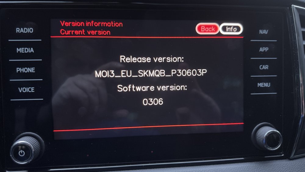

Has there been new updates rolled out since 306? I have a Skoda Karoq with virtual cockpit and Bolero unit with software 306 installed. I don't have navigation but I'm experiencing some small bugs that are becoming annoying like: when setting a destination on google maps I get a message "Compass unavailable" in the VC and I have to exit the navigation using the steering wheel commands and the get back and then I can see turn by turn navigation, some times the 3rd option for configurable dials layout in VC is missing and it only shows 2 options instead of 3, other times when put the car in reverse it shows only the back-up camera without any guidelines or overlay, it doesn't always enter in Android Auto but this could be phone related, and other small issues regarding VC and Bolero.

Any way I can get a download link and how to update tutorial? I’ve included a photo of what the service menu shows, but there are no OTA updates available, maybe because I’m based in Romania. I can ask the dealer to update it for me and claim there is a warranty issue like the bugs I’ve detailed.

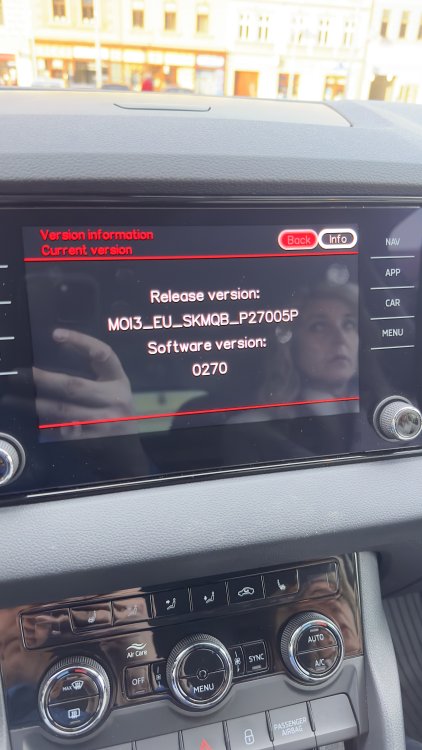

Hi all, I just kicked Karoq and the infotaiment shows me sw0270. I can somehow update it. Thank you for answer.
You can update to 0306 version, I will PM you a file to download to USB stick.

Dne 26. 2. 2023 v 12:14 Sofer0 řekl:
Hi everybody
Is the same update for a Skoda Kamiq Montecarlo software version 270?
10 minutes ago, Gennaro81 said:
Hi everybody
The key value you are looking for is the release version (what I call Software Train) to be MOI3_EU_SKMQB_P27005P in your radio, and you can update to 0306 version

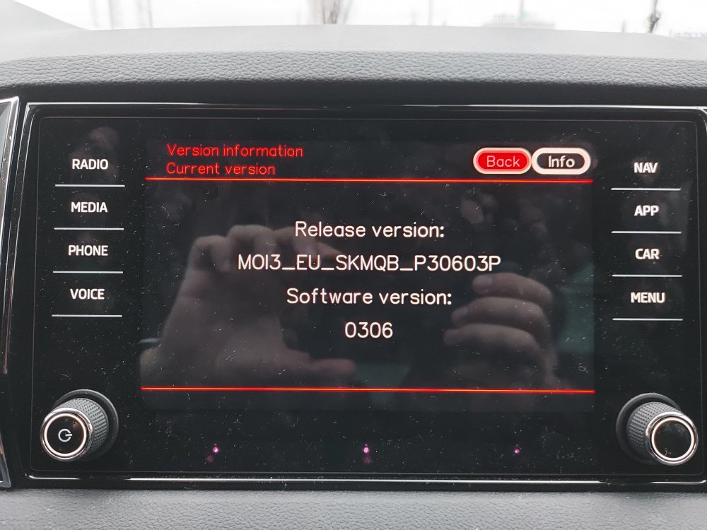

I'll correct myself... it's version 0276! Can I update the same?
Yes you can update to 0306
Taken from inside the update
 "Release": "MOI3_EU_SKMQB_P30603P"
 "MuVersion": "0306"

Done now! Everything perfect! Thank you

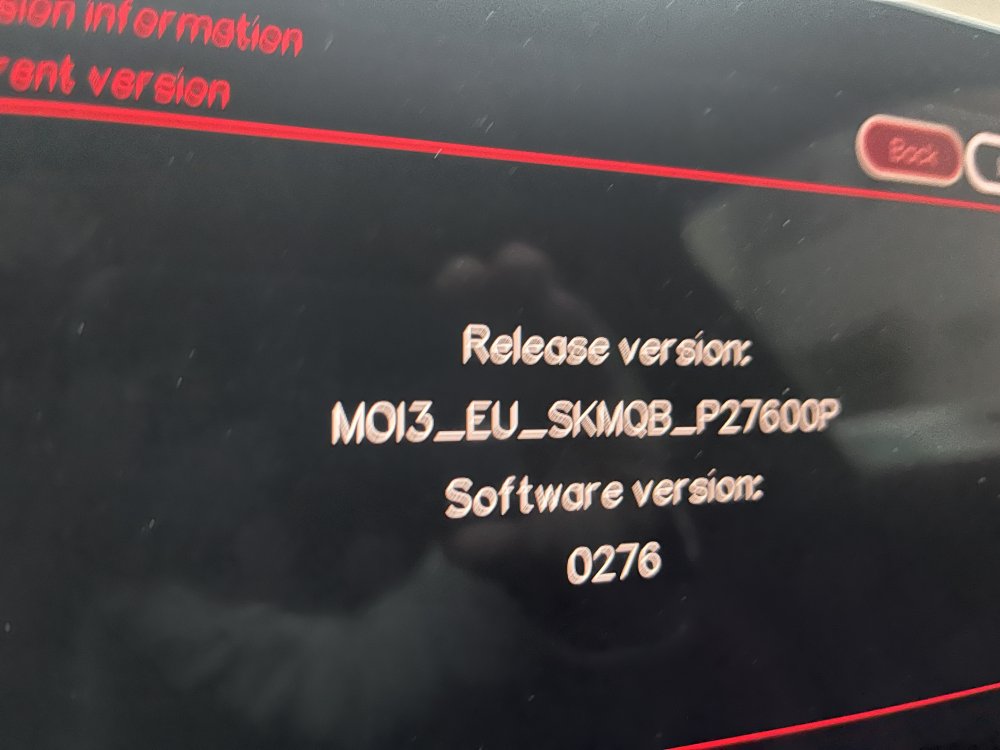

Hi!
Just registered here because of this interesting thread about a possible software update for my Karoq!
I wonder, if it would be possible to update my Karoq's software, MY 21, too? Which is the currently available software version? 306?
Hardware level is H22 and software is currently 0276.
Could not really follow the vid above 'cause it's in Italian language 😁 The steps necessary to update using an USB stick are clear, though.

Welcome to the forum Michael,
Yes the update should bring you to 0306 should you wish (if your Software Train is in the correct format)
I cannot understand Italian, but seeing the screens is much more helpful than me typing out 20 steps for sure.
Dealers are very reluctant to do software changes as they are concerned about breaking things, understandable really, but as you can see the success rate is good.
With any software update, you do really need stable power, at the least I usually tell people to have their engine running to keep stable power.
During the official process at dealer, at the end the new software version will be updated at their end so they know you left factory with 0276, and now have 0306.  Not sure what you mean about changing of hardware parts exactly.
