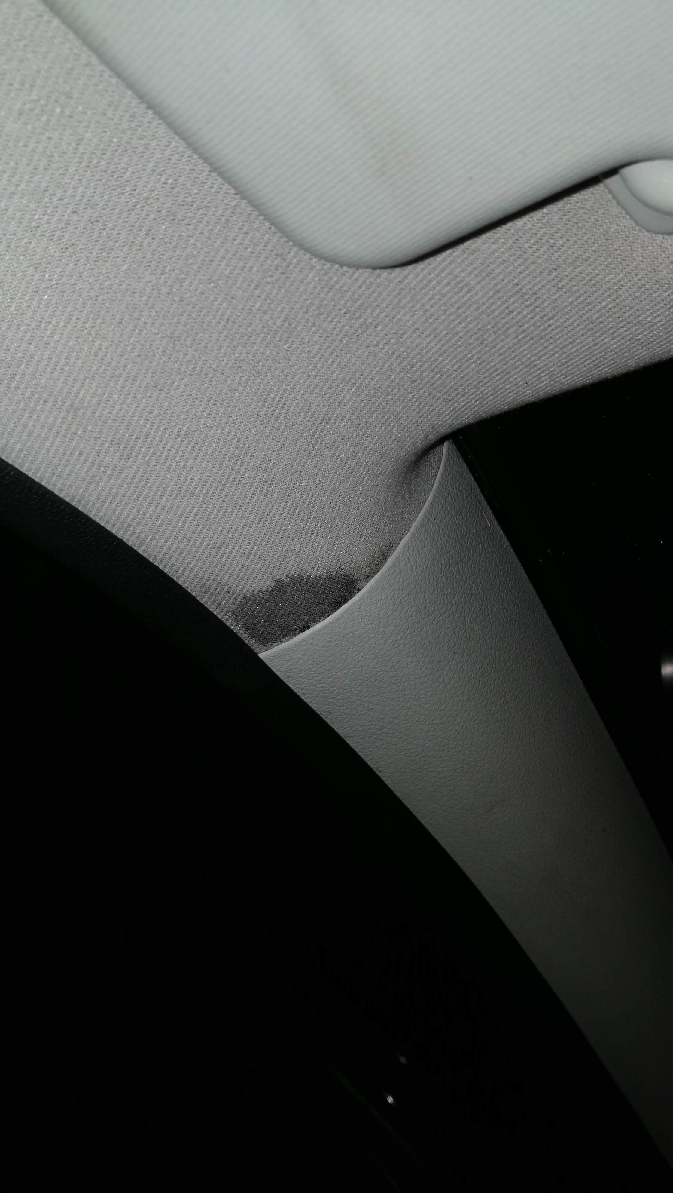

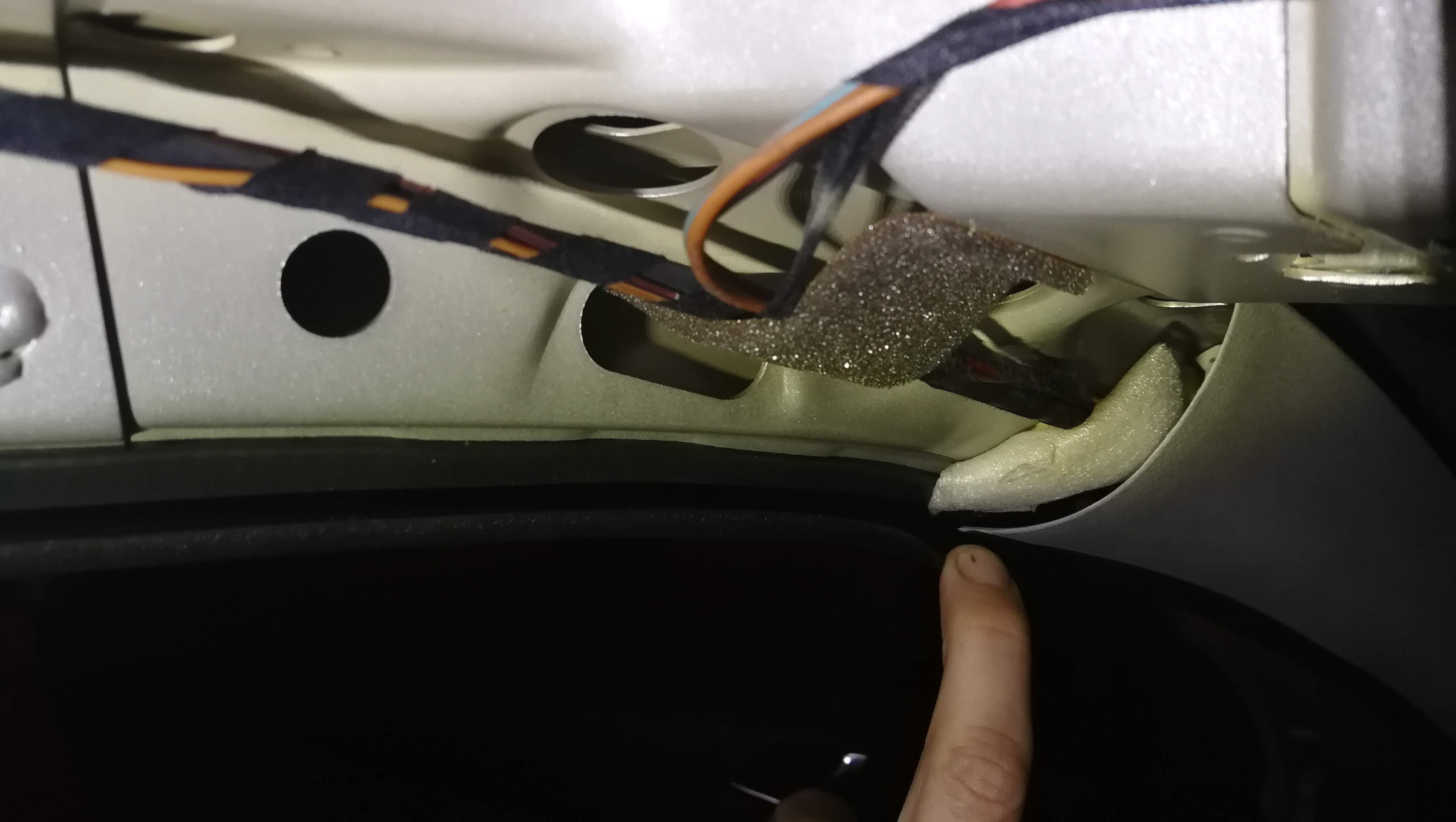

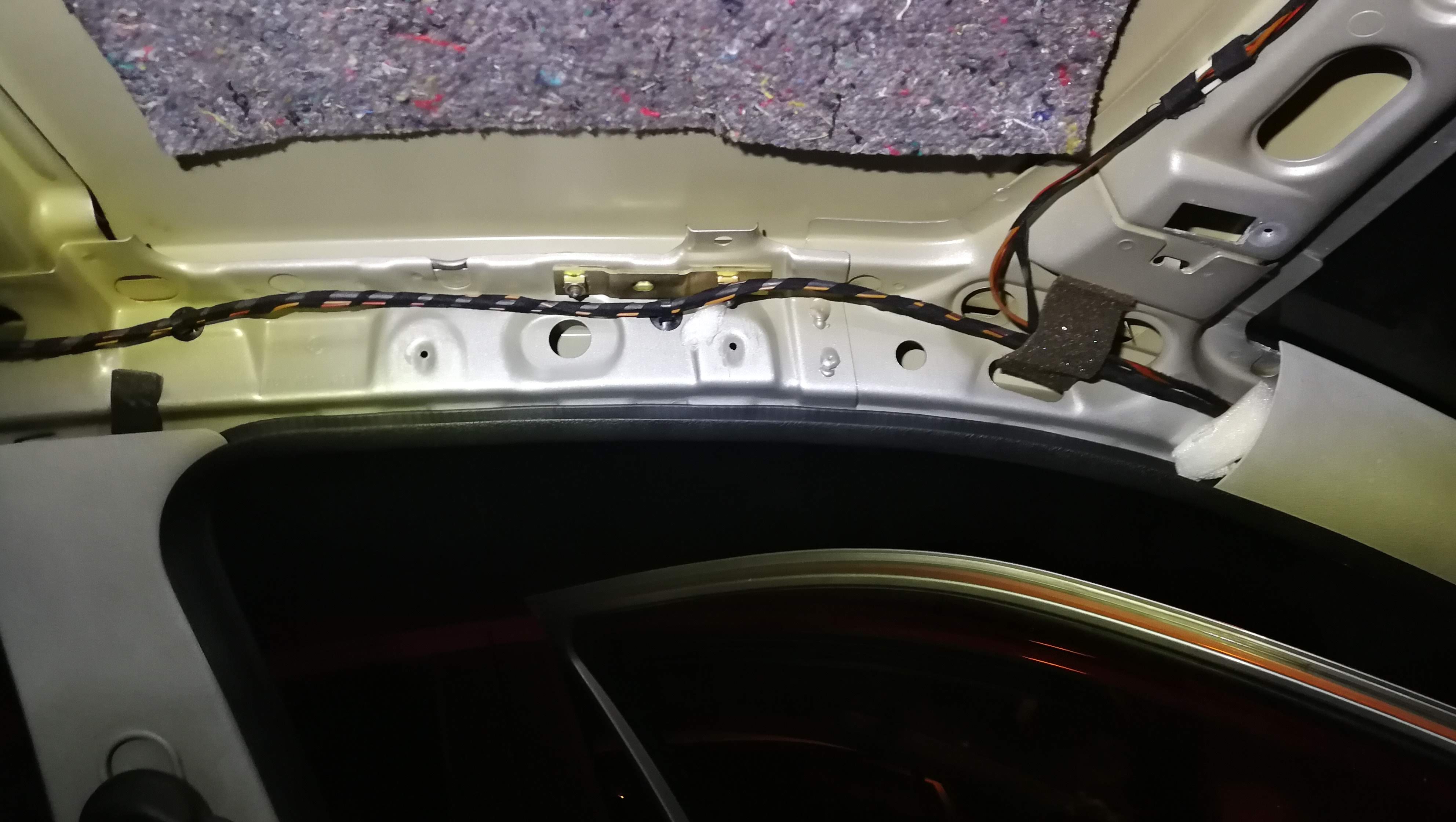

Octavia 1 water leak on windscreen
I put silicone around windshied corner and two holes for roof mounts - still got a leak when raining. It's very localized unlike my previous octavia where moisture would spread up to my head. I was lucky to have a neighbour fix his roof liner and took a deeper look at the exact spot where I have a leak and cannot deduct anything smart except that I think the water is going through the rubber seal and then concentrating on the spot where I have the leak. I also believe this leak develops only when car is stationary on rain, during driving it doesn't leak (I have a garage so most of the time it doesn't see the elements). See pictures below, if someone can point me where to seal it again before I take down the roof liner... P.S. my car has a sunroof and the left side drain is either clogged or disconnected, because blowing compressed air on the right I get pressure on the door drain, on the left I get none - I did block the left drain at the sunroof but the issue remains. Maybe it's this drain but I have a hard time finding the drain pictures online on an octavia...

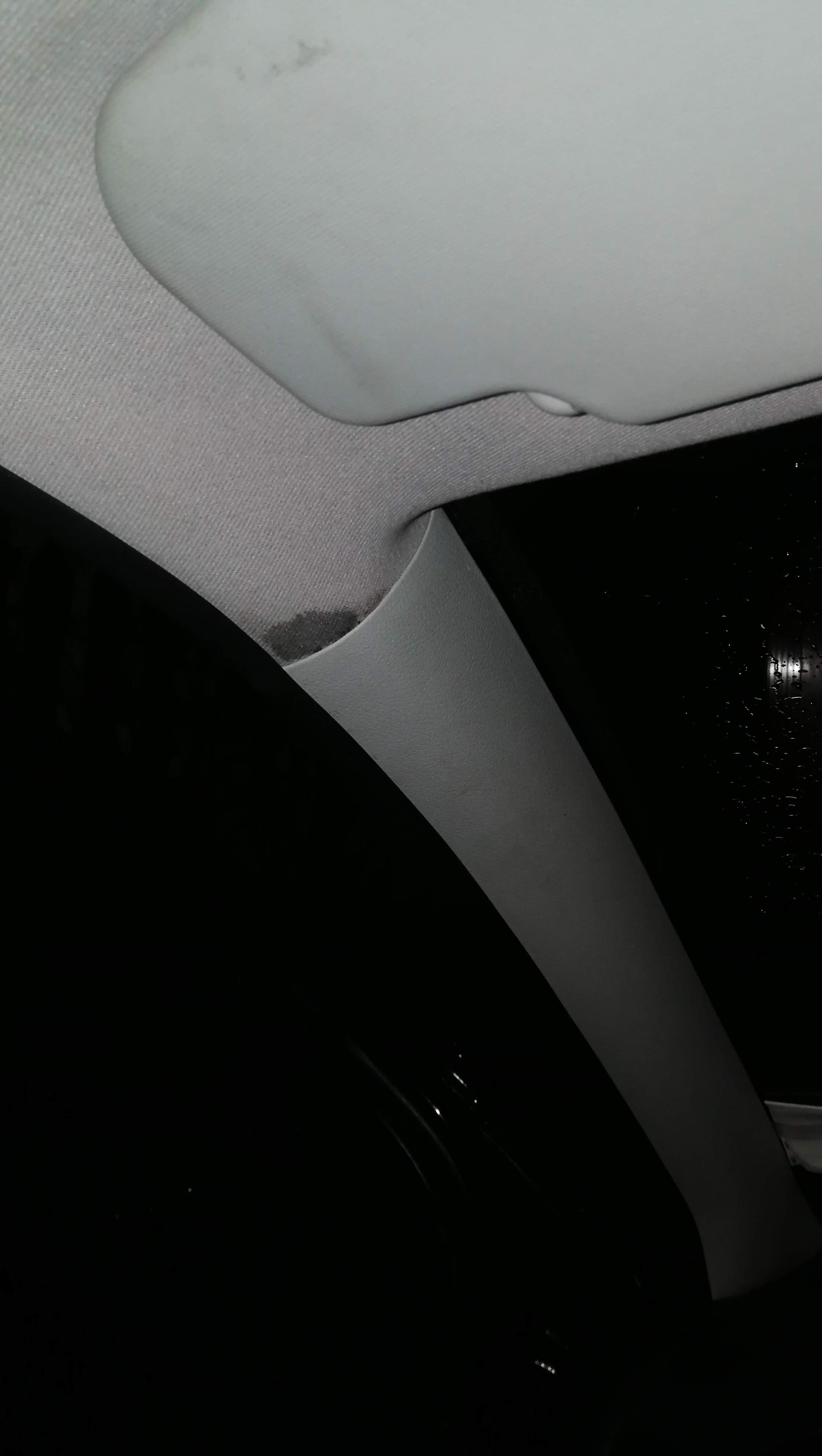

Me again, my second octavia, this time estate and 2001 and with sunroof. The same issue on the same place, left side A pillar where it meets the headliner is getting more and more wet. It's not the sunroof. I "solved" it on the old sedan by clicking in the exterior trims here and there, but here it doesn't help. Do I put sealant on the outside or inside, I'm having a hard time deciphering how you actually solved it? Btw the Estate has one piece trim throughout the length of the car, kind of fearing of breaking them...
