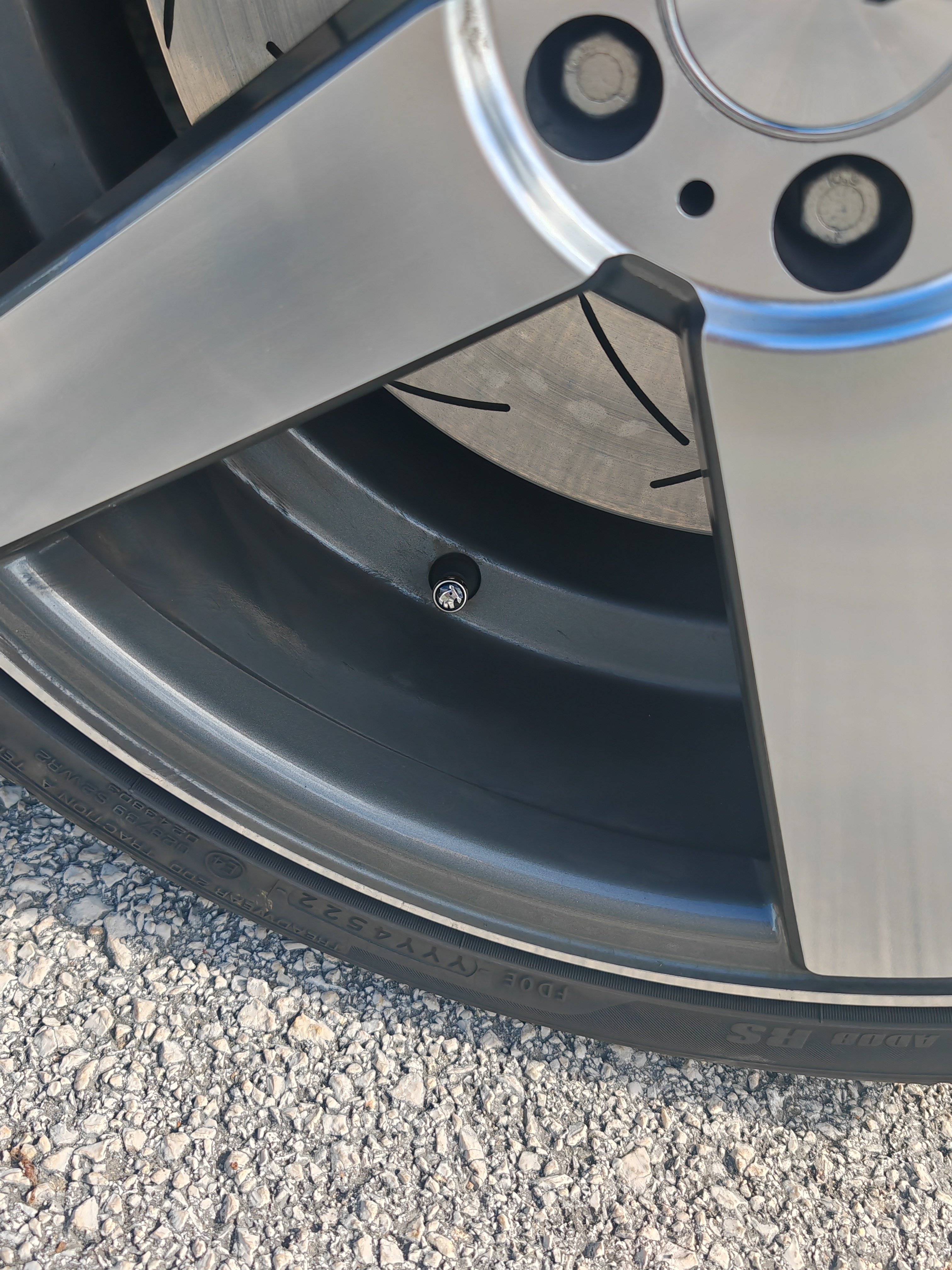

Had to replace old TRW right rear caliper because it was producing squeling sounds when in reverse than also in forward driving-blocking the wheel-piston rubber went off. I bought this time Essen red ones,not green as last time but anyway I had to machine them again due to the new stupid wheel design-lack od space (with old 19s didn't have that problem). Painted that machined part in Foliatec 3020 Porsche Brembo red and now enyoing sound free new caliper

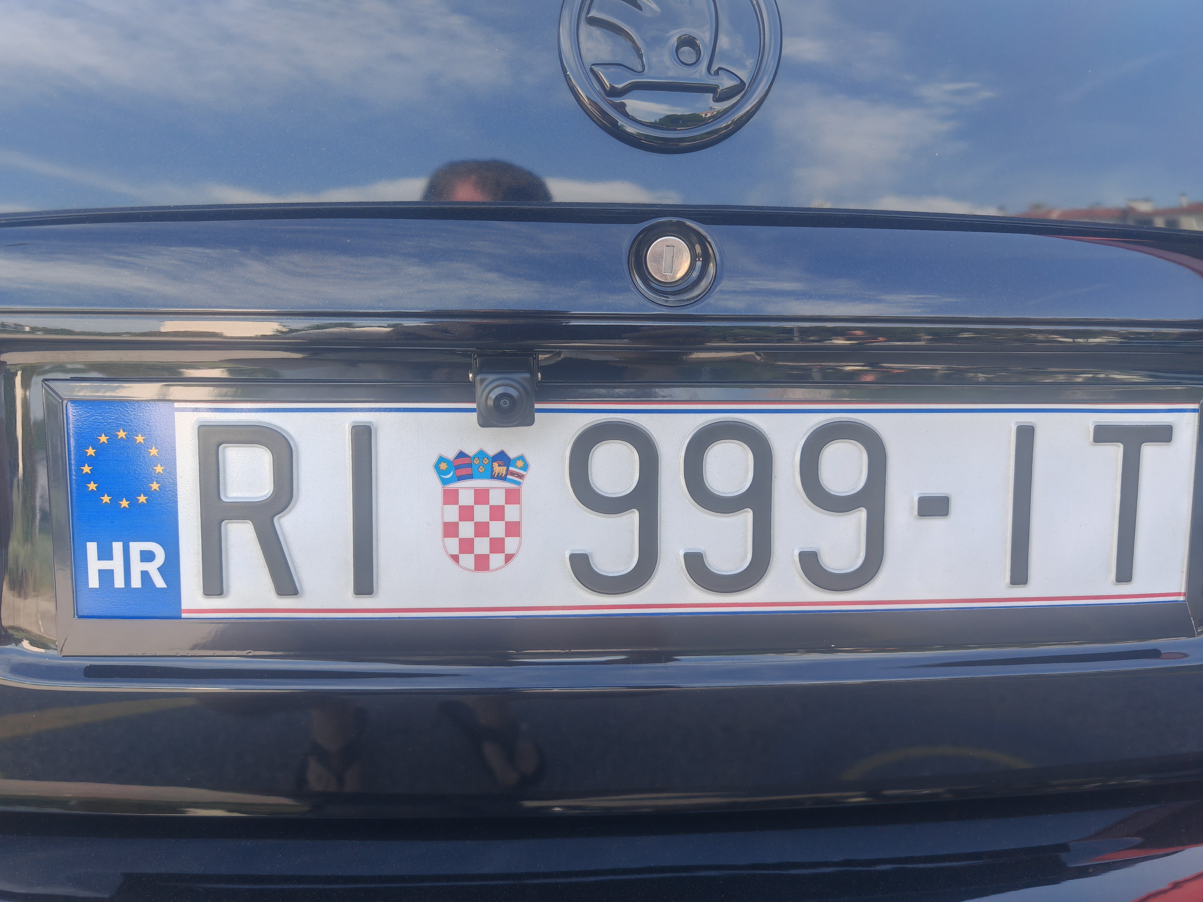

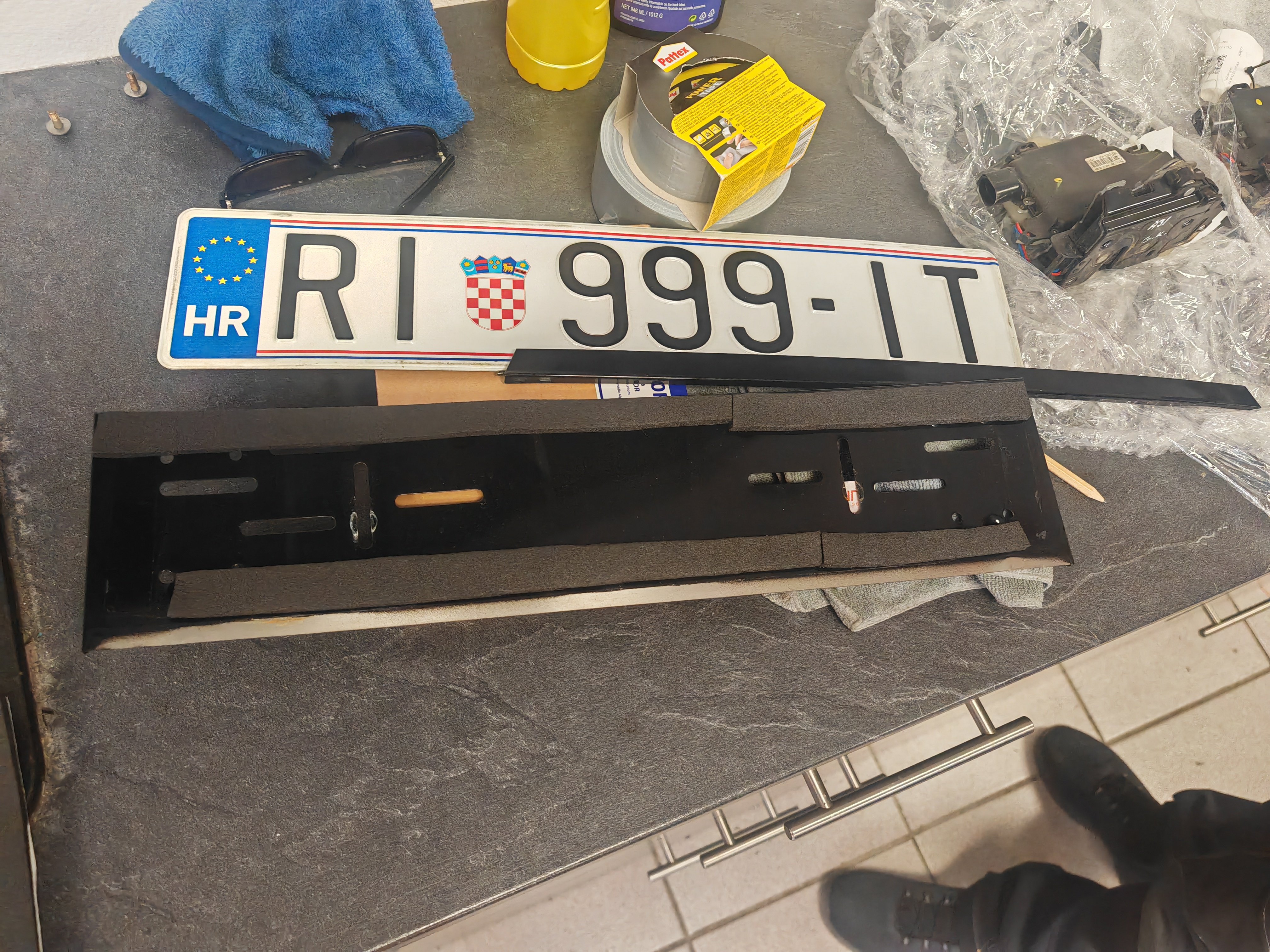

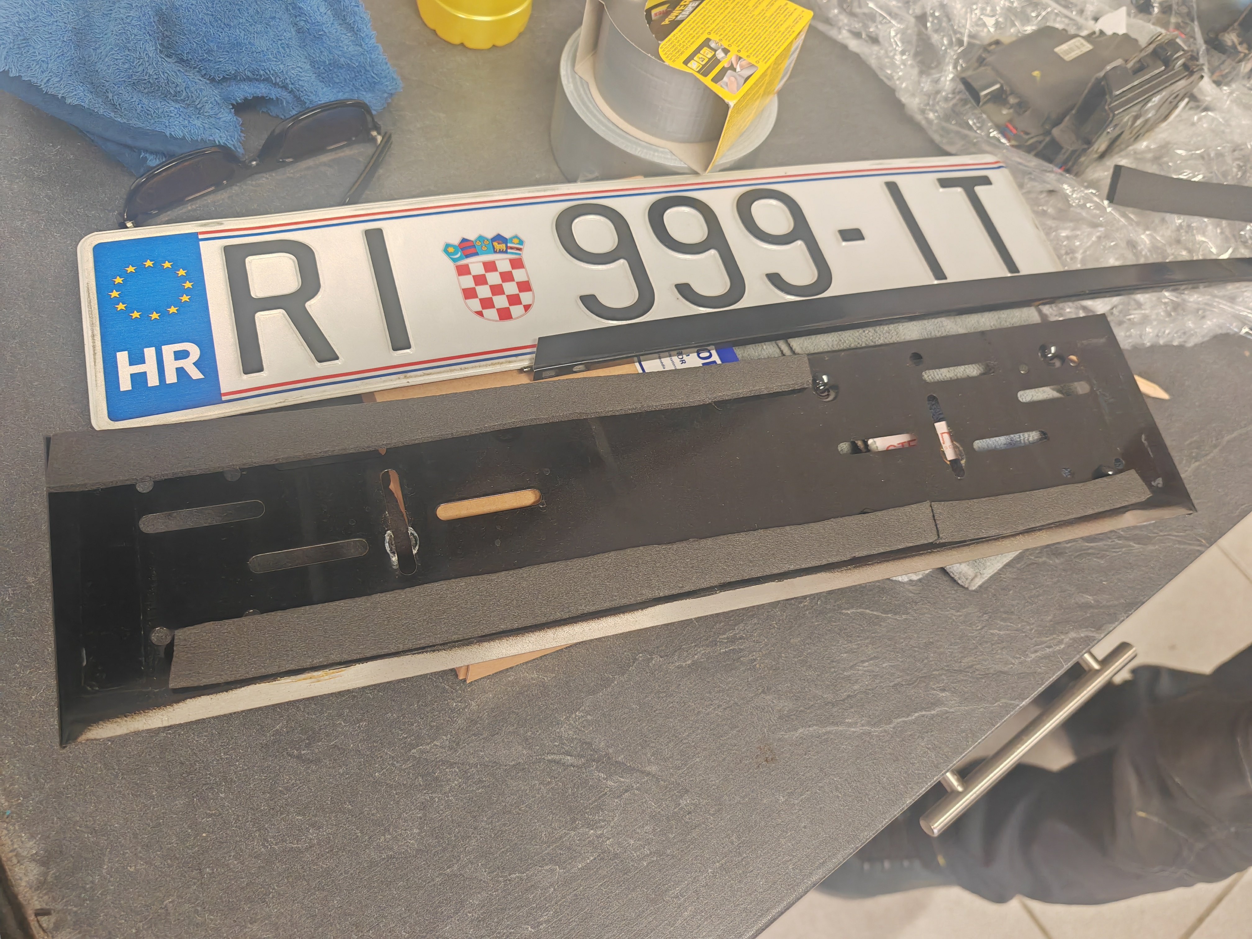

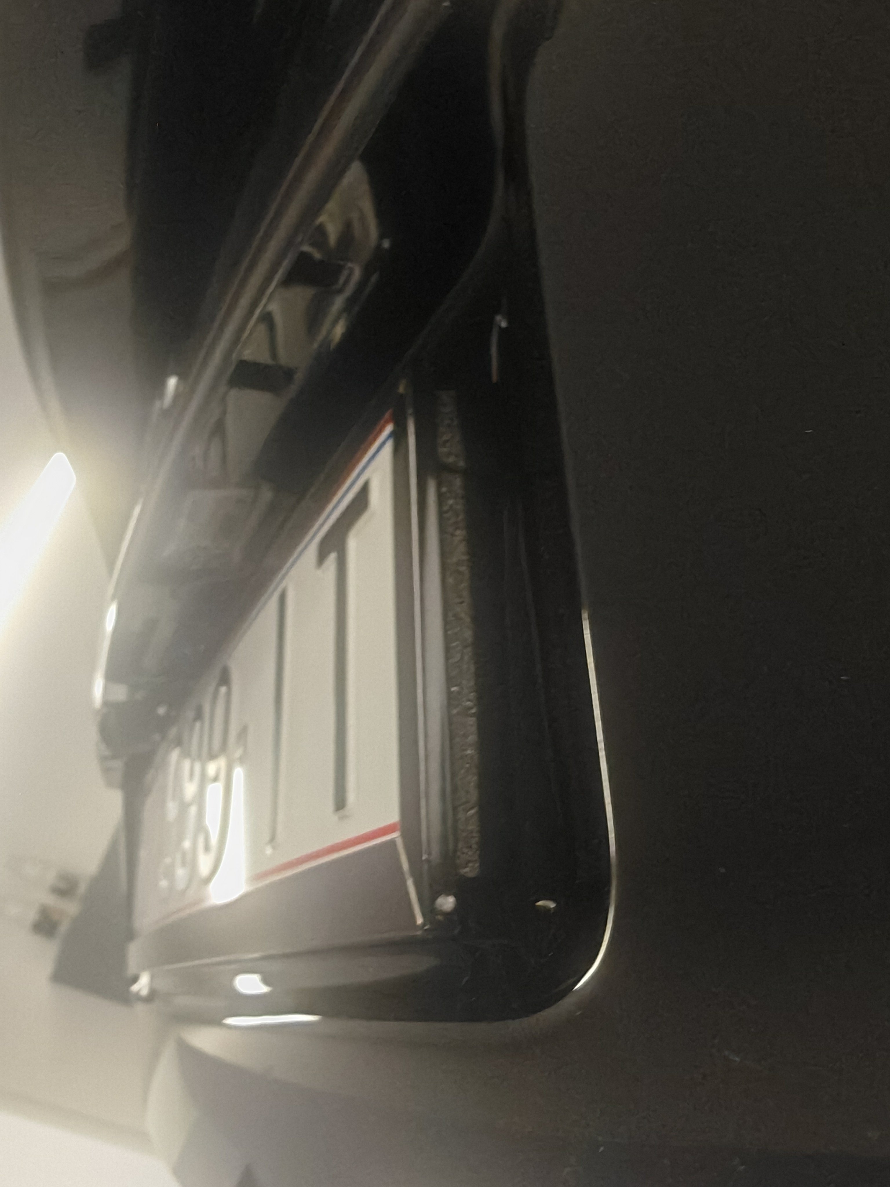

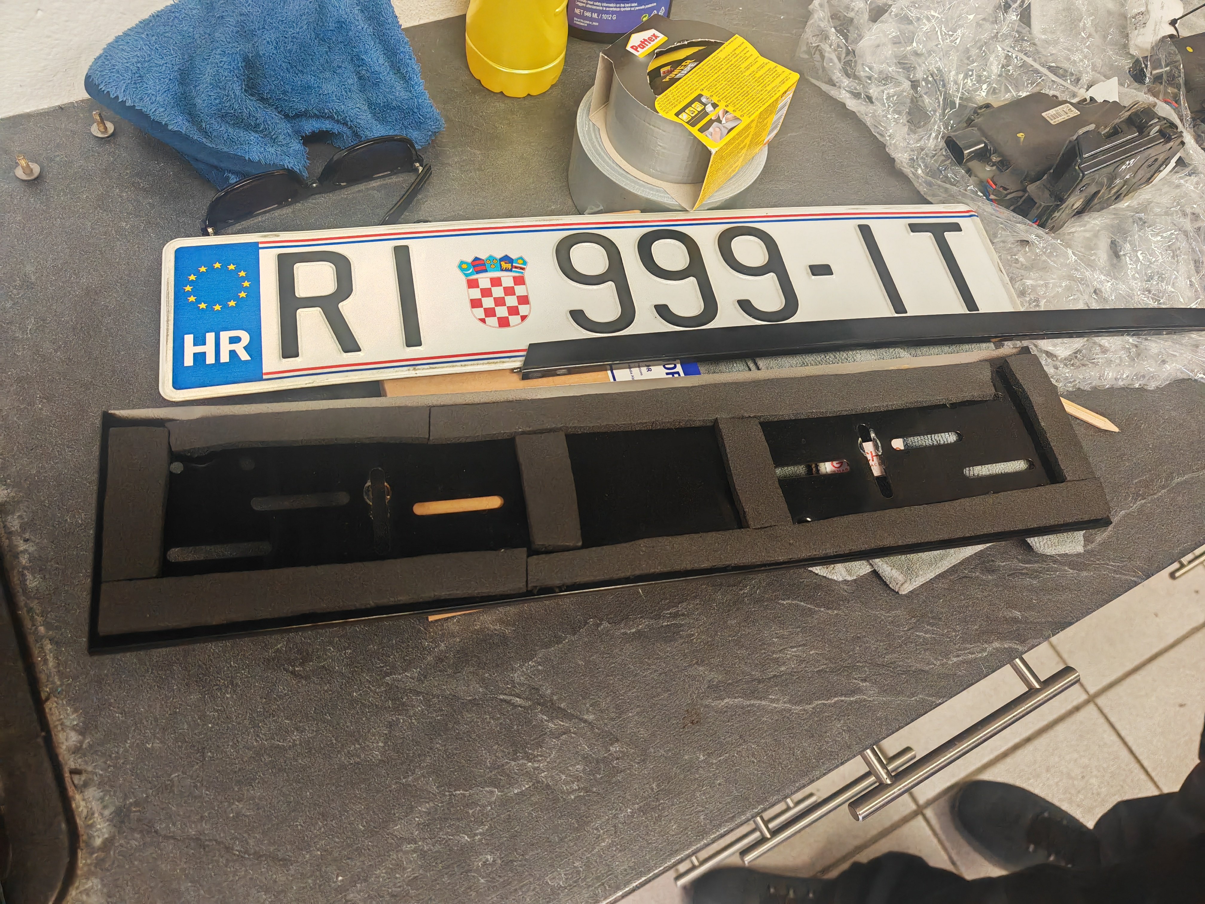

Removed old wire from Xenon balasts, water pump and water thermostat. Still need to put on engine Mount, to see why is right rear (passenger) calipers blocking that wheel from spinning naclward-onnthenroad making squezing sound, they were new Ate and painted red-hope tonsočve that, no more oil letaka whis was notnfrom the rear main Seal,or that gearbox sleve but were driven by thensir from blocknbreather adapter (Crestion motorsport one with 2 o rings) so we used OEM WV sealant to eliminate it and we did it, but I am planing to bore that adapter to a larger inner hole diameter, because it is funny small compared to AN10 adapter on it-and thus not fully functional😇😇😇 And for the end some magnets for the reg plate mount.

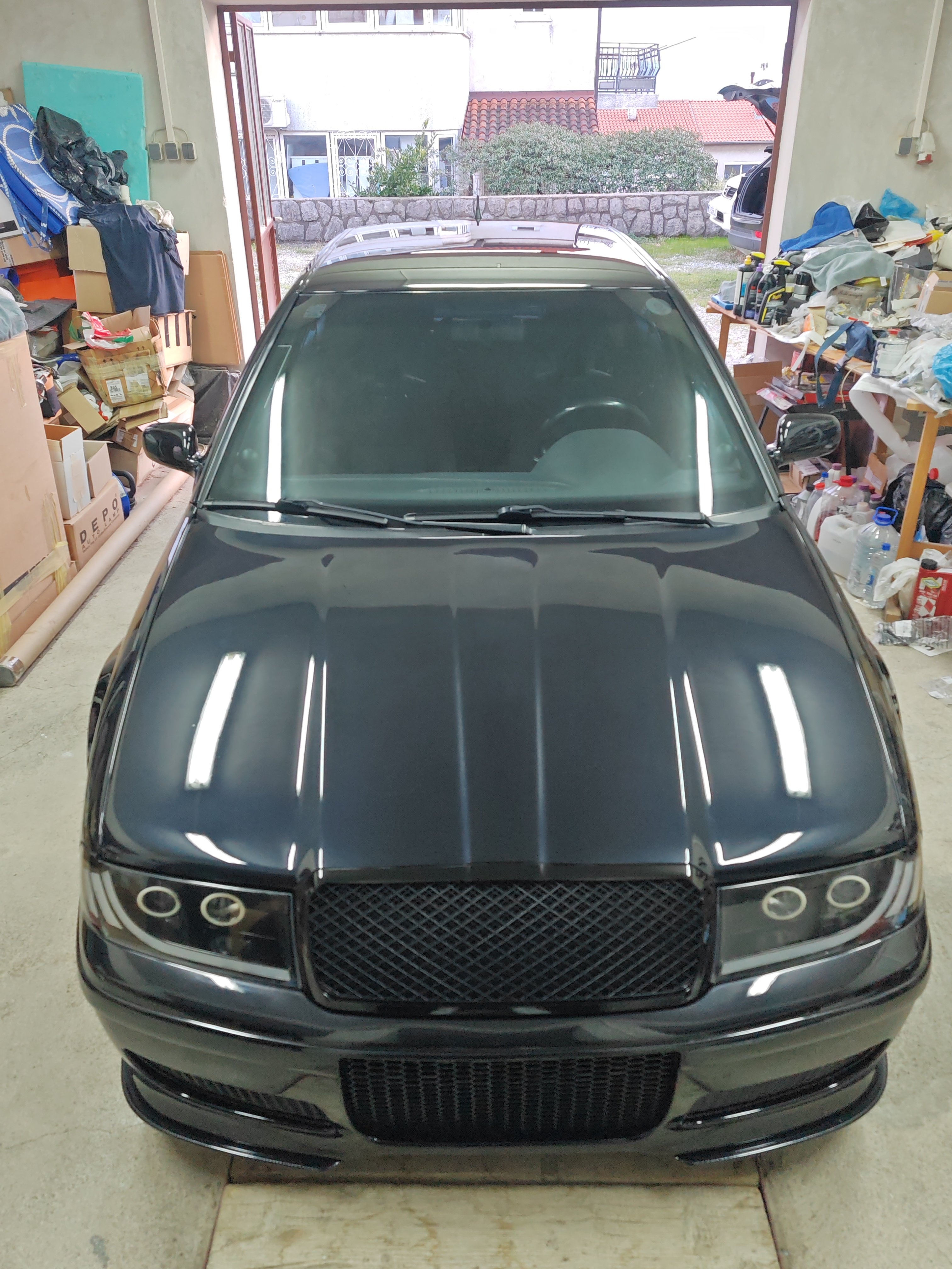

I returned mosquito mesh over air diffusor in bumper to avoid dirt and insects being dragged into the air box and air filter
