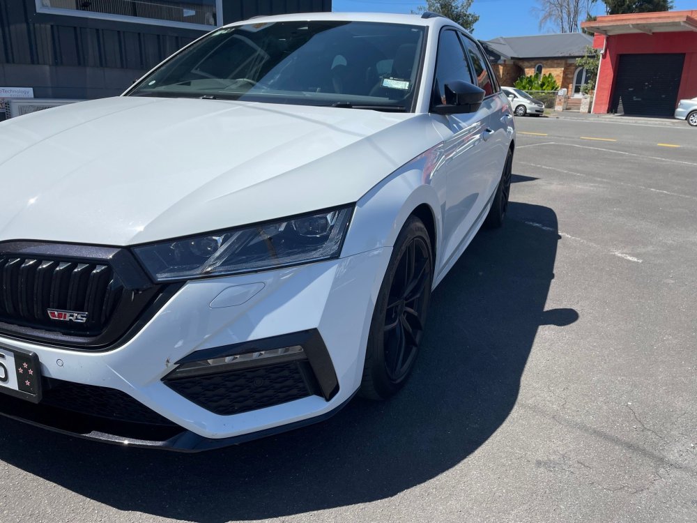

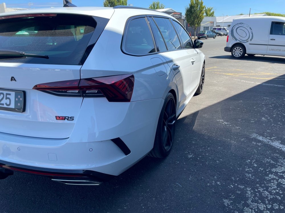

  2. They'll fit fine. I've got 18x8 +40 on my 21 vRS with room to spare.
  3. Wheels are Forum Shift. These ones: Mag & Turbo (magandturbo.com) Tires are factory size (225/45r18) Goodyear Eagle F1 SuperSport.
  4. I was wondering the same thing a couple months back when I was buying new wheels. I couldn't find any pictures for reference which made it hard. I ended up with 18x8 et40. I've attached pictures so people can see how they fit. 40 offset is still easily inside the arch. You could even go a little lower and get away with it. I think et35 would be perfect.
