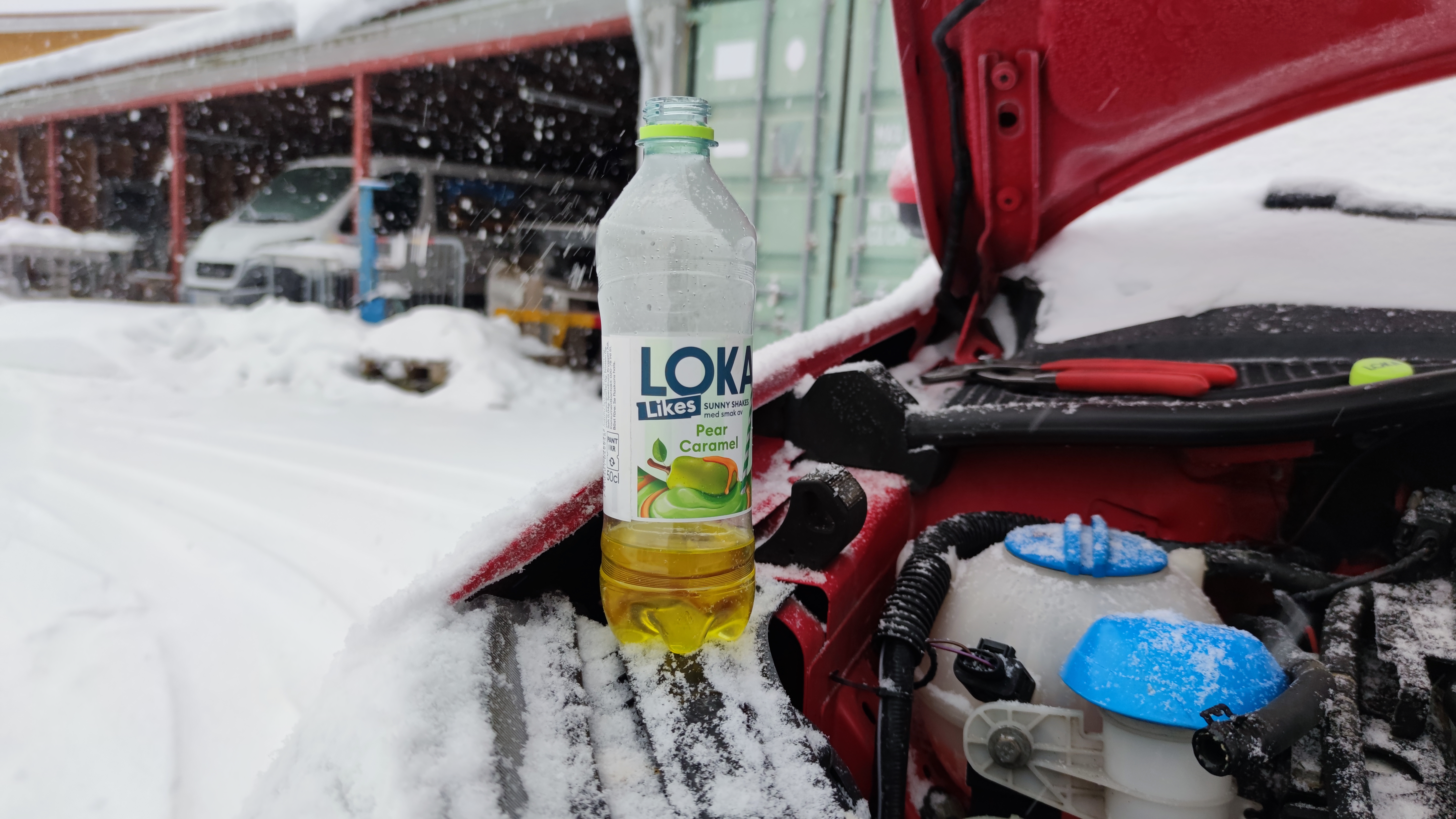

Seems like a bad joke but the problem got worse AGAIN about a year since last time! Funny enough the problem seemed to have gone away earlier this season as it always started up even in -25 degrees. Anyway, the problem now is that it started to run poorly when my wife was drivning it, and since she turned it off it has not started at all even in "mild" temperature (0 degrees). It starts for about 2 seconds with a poor and jerky idle, and then dies. I did try to run the auxiliary heater and it ran a bit better, but it would not rev past 1300 rpm unless I was blipping the throttle, in which case i could "trick" it up to 2000 rpm. But puttning it in gear and try to drive caused it to stall. I've disconnect the fuel line from the tank and ran the pump with VCDS for 10 seconds, and it pumped about 100-120 ml of fuel, which would be 0.6-0.8 L/min. I cant find the correct specs for my car, but it seems a bit low? I also noted that the car has a secondary fuel pump under the hood. It would be a plausable culprit as well as its located besides the fuel filter, on the same side as the auxiliary heater which would make it receive some heat from the heater and explain why the car started easier when the heater was run. But i have bo idea of how to test that pump. Any idea what to do next besides throwing parts at it?

Are there any distinct way of knowing which one is which or do I just have to google it for this engine model? Unless contaminated from the tank I do not think it's the diesel per se, as stated I'm living in the norhtern part of Sweden and have other VAG diesel engines which have no problems with the same fuel. It runs just fine in all temperatures, once "correctly" started. The start-problems are usually when it's below -10C, but last time it was about -5 (however it did actually try to run and not hard-cut). No problem what so ever if it's warmer. I did run the pump(s?) for about 1 minute using VCDS when I changed the filter, and it started right up making me believe for a while the filter was the problem. Hmm good theory! But wouldn't that throw a code? It starts just fine basically 100% of the times if I use the diesel aux heater, but not if I run just the Defa-heater (cabin only), implying that the temperature in the cabin does not seem to matter.

New year, newish problems! I did a fuel filter swap, and did drain all the fuel from the canister where the filter are placed. Thought I could see some water at the bottom of it, and was hoping this was the solution.. but it was not. The car are still acting up. However, now does "cough" to death instead of the previous clean "cut off". Seems like it's starving for fuel or air, or are getting the wrong mix of it. Well so now I'm basically back to square one again. Any suggestions of what to try out for now? Are there any more filters, or areas where I can try to drain of water? I've added a video of the current problem. After the first start I'm blipping the throttle to try to keep it alive. NOICE WARNING, was using the Defa heater when I recorded it.
