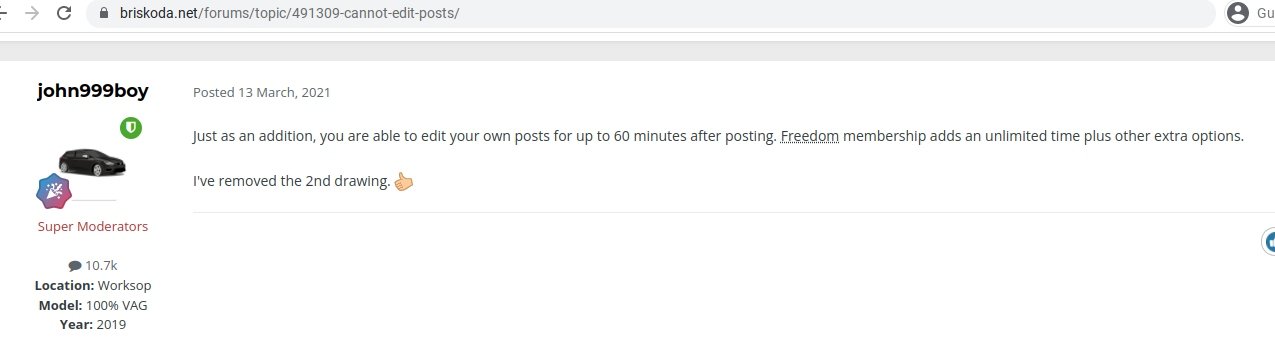

The time you have to edit is limited if you are not a Freedom member.
If you could not within an hour then maybe there was an issue.
If you were only trying over an hour after posting having been told where the EDIT was then no problem.
Edited by roottoot
That's what I remember but I am 14 hours from my last post and the edit option is still available.
^^^ were you a Freedom member in the past so still getting the benefits?
No, but I remember only getting about 1 hour in the past.
Edit: Looking back at my posts seems its probably 24 hours now as I can still edit a 22 hours old post but no further back than that.
Edited by Urrell
I am still getting Edit action available, was a Freedom member, but then I am also a Grand Master (but not I note now or next going to be a Renegade Master).
