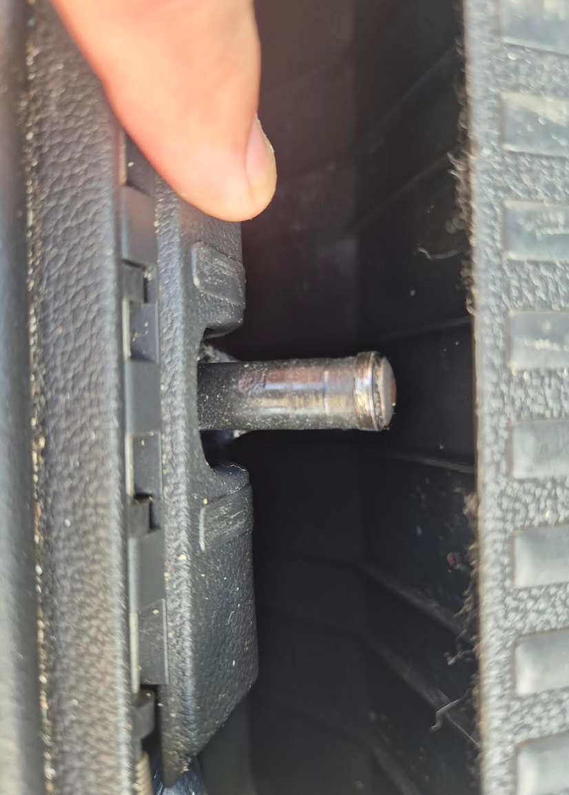

Oh wow, yes definitely a wiring issue there. Mine is definitely something to do with the buffers and striker bar. If I use a screwdriver to simulate the bar closing the latch, it clicks into 1st position and then 2nd closed position fine and the car says the boot is locked and closed, so the latch sensor is fine. I have it now where it closes, pulls down but is about 2mm not doing the 2nd click fully via the pull down. I have a suspicion that the bar itself is too thin. going to add some tape as a test to increased the diameter of the striker bar and see if that works

Still have this issue. Brand new latch mechanism which is where the sensor is. Have repositioned the metal bar countless times. Currently best I can get is the boor closes, pulls down to close but I have to lean onto it to push a couple of milometers to click closed but once done it will not auto open. I really can't imagine that the bar positioning is supposed to be micro millimetre accurate. Any ideas?

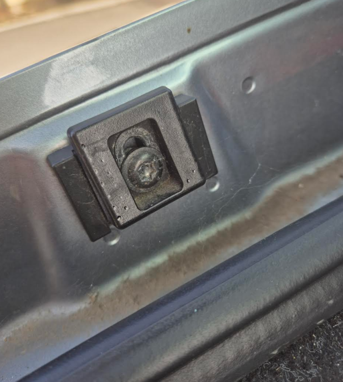

Hey there, thanks for this. Have replaced the lock mechanism but no matter how many times I reposition the metal bar it latches to (which is the only adjustable piece that I can find) I end up with either: 1. The boot closes and the latch latches onto the metal bar and does the pull down, but when driving the display shows the boot is open and makes the ding ding ding noise or The boot doesn't physically close properly all the way (99.9% closes but I have to push down the last 2 mm for the latch to click.), the display does not show boot open or make the ding ding ding noise but the boot lid needs to be slightly lifted when opening for the motors to start to lift it automatically.... The pieces involved are: 1. Lock latch mechanism (replaced) 2. Metal bar under sil (no sensor, just manual adjustment) 3. Gas struts (not adjustable as far as I can see) 4. Release motor and cable to lock latch (no problem there as far as I can see) 5. Control unit (can't see any option to set anything here via OBD link or options and nothing mentioned on this in Elsa)

Hi all Have replaced the electric latch mechanism but issue not resolved and I don't think the issue was the latch mechanism. Same issue, boot would close but alarm would sound to say boot open and display sign would come on. I've found that the metal piece under the spring loaded flap in the boot sill, that the latch latches onto (photo 1) can be adjusted left and right and higher or lower by loosening the bolts securing it, repositioning and then retightening the bolts (evidently to align the latch. The problem I have is that no matter how many times I reposition it (down to millimetre changes) I end up with 1 of 2 eventualities: 1. The boot closes and the latch latches onto the metal bar and does the pull down, but when driving the display shows the boot is open and makes the ding ding ding noise or The boot doesn't physically close properly, but the display does not show boot open or make the ding ding ding noise..... The best I've got so far is a situation where the boot 99.9% closes but I have to push down the last 2 mm for the latch to click. However, the boot lid needs to be slightly lifted when opening for the motors to start to lift it automatically.... Any ideas anyone? Is it alignment? Is there a guide on that anywhere? can't see anything online. Also, these things on either side of the boot (photo 2) can be adjusted and I think form part of the alignment but again can't find any guides online. p.s. Ive had the whole sill off, there is no sensor under the spring loaded flap. just the metal bar.
