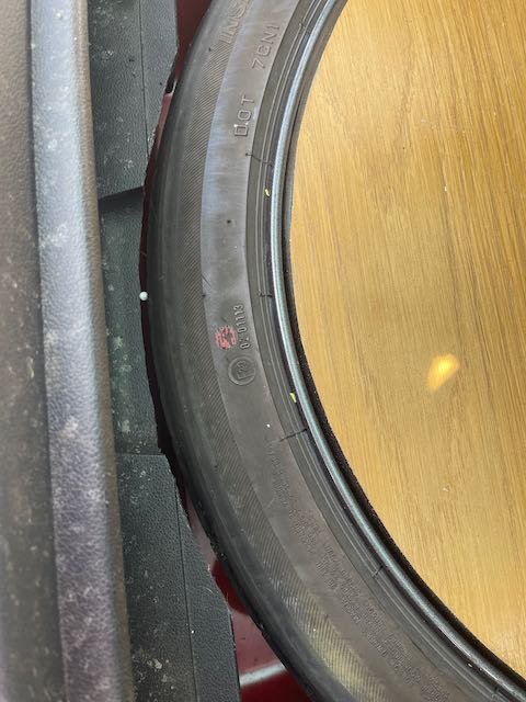

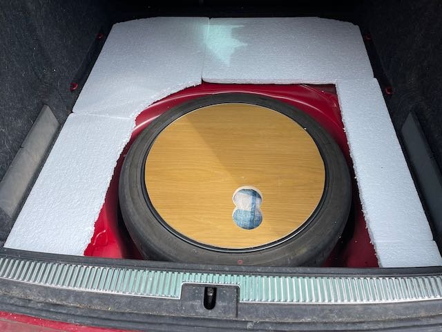

  1. Spare wheel now fitted and screwed down 19" Vega wheel c/w 235x40 tyre Plastic inside boot lip trimmed with angle grinder to get wheel in A scrap bit of ply placed over the wheel hollow to support the boot liner. Hole cut out of ply to keep things flat where liner hook is. 12mm ply used with edge reduced to 7mm to sit flush in wheel. 25mm polystyrene on boot floor to level with tyre height. Intention was to use doubled up 12mm birch ply (lighter than normal ply) but the war in Ukraine has stopped supply from Russia. May do this later? Boot liner replaced flat and supported with boot floor now raised 25mm
  2. That’s my plan. What thickness did you use? does it rattle?
  3. I agree with your comments. I am new here and will obviously need to find out how to search lol. Will look for the thread. Thanks Did you need to raise the boot liner around 25mm to get level with the tyre (235x40)? If so what did you use?

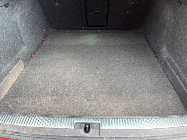

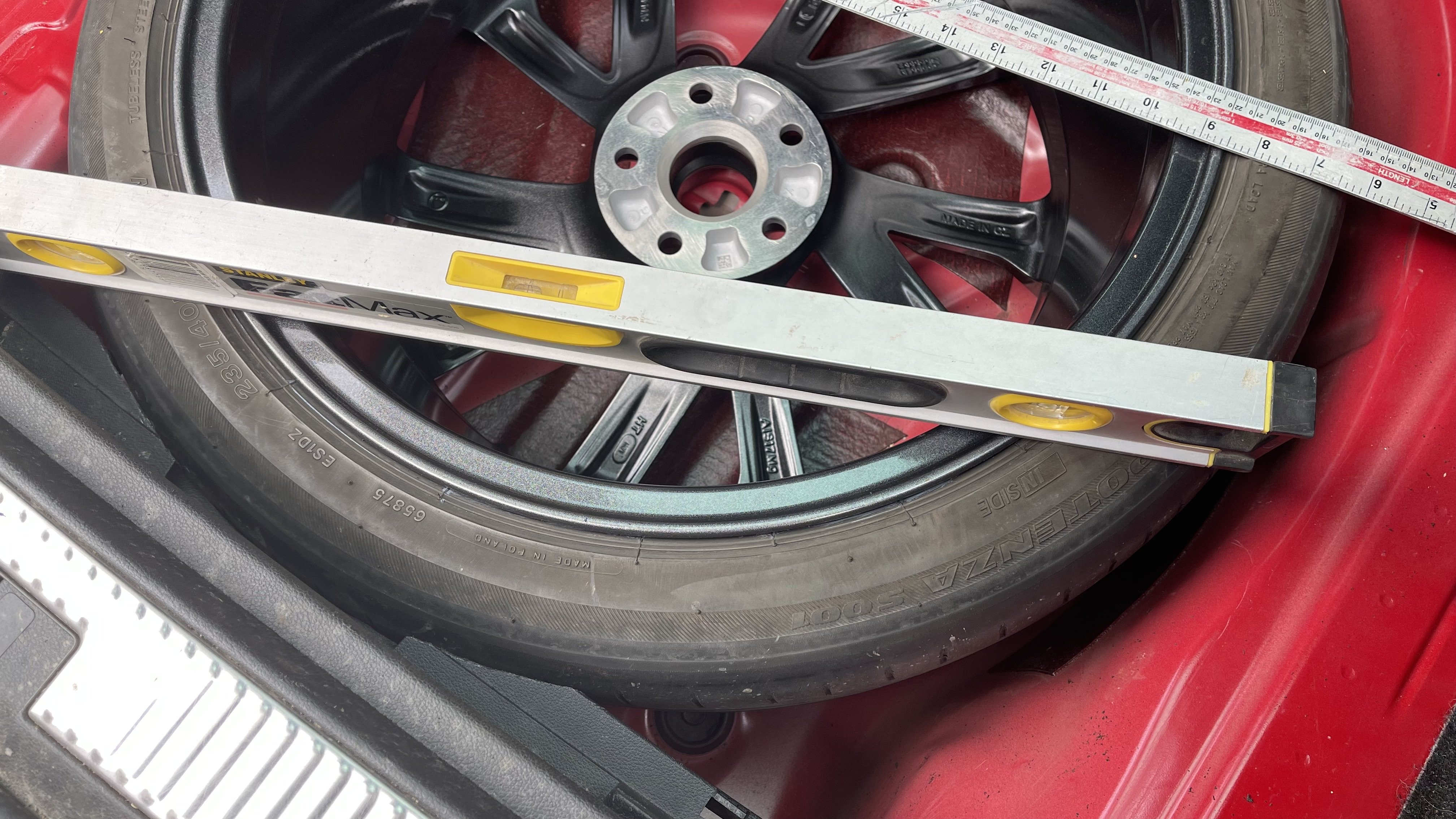

  7. My 2020 Superb Sportline Estate is the first car I've owned without a full size spare. Instead it came with a foam spray can thingy. Time to put that right... Vega 19" wheel purchased and 235x40 tyre fitted... Only it doesn't fit in the spare tyre recess under the boot! Out comes the angle grinder to cut the plastic on the inside of the boot lid and in it pops. Only the recess isn't deep enough and the wheel sticks out around 25mm. Next job is to put a double layer of 12mm ply with some damping under the boot liner. No probs to do that. Can anyone please advise the correct spare wheel holder screw and where to get it. Also looking for recommendations for a suitable jack and wrench. Cheers
