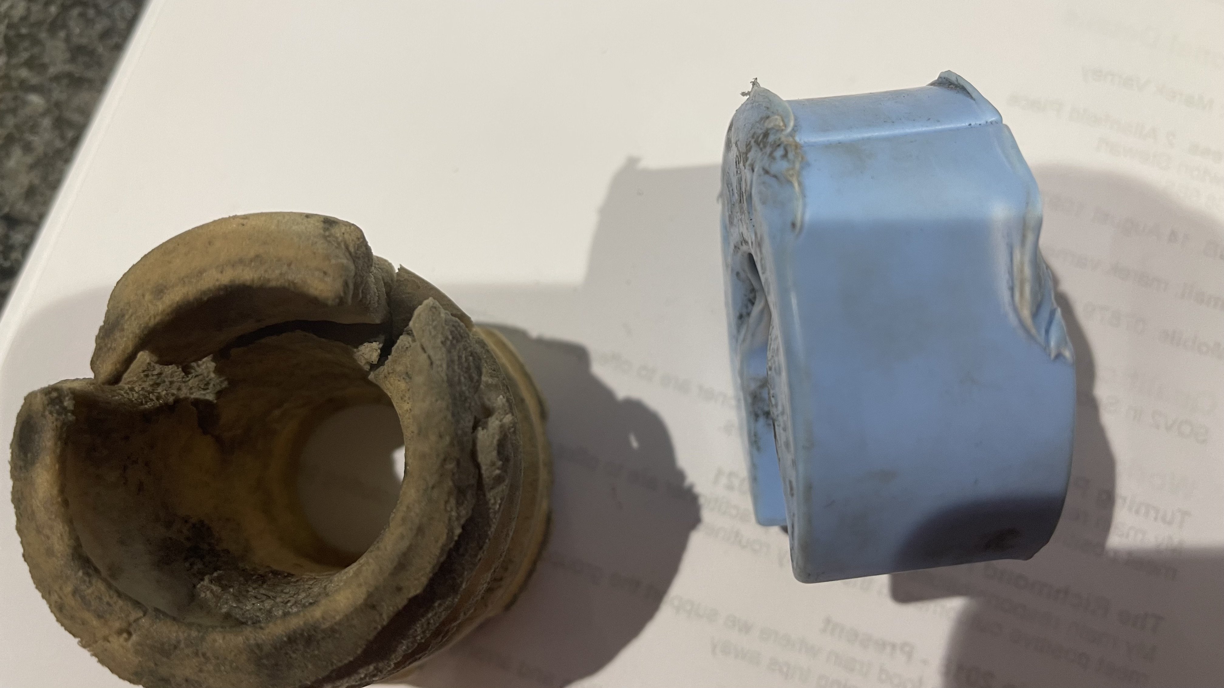

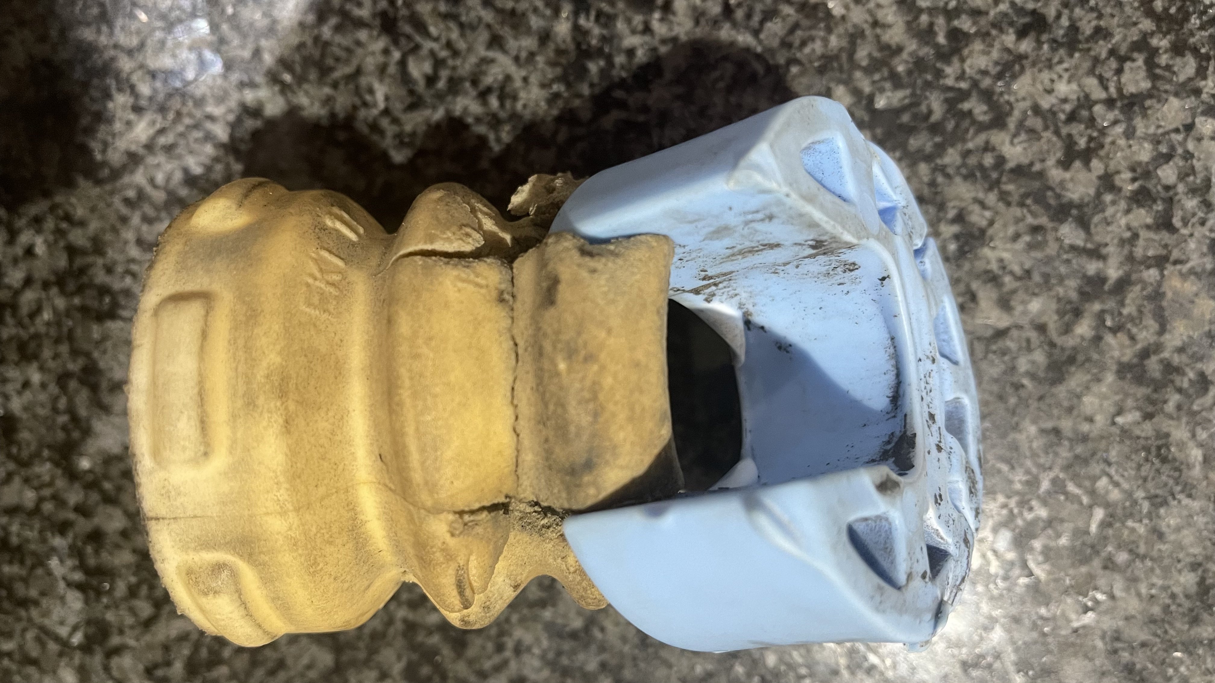

Both the first Skoda dealer to examine the car (not the supplying dealer) and the Halfords manager when fitting the tyres unequivocally blamed the suspension issue for the tyre wear, only the Skoda dealer wasn't either prepared to tell me or genuinely hadn't spotted the blocks, claiming not to know what the problem was. I can only go to the supplying dealer with advice I have been given. I further add that when the Halfords manager inspected the car, he did so with a Skoda Master Technician from this 1st dealer on live video and that was their joint conclusion, having found the blocks. If the argument, as the supplying dealer is now arguing, is that it may be pothole damage then surely it is logical that limited suspension travel would be a major contributing factor. I have not driven the car for 16,000 miles without realising. The car had 3,500 miles when I bought it last year and I reported the issue to the dealer as it became obvious last year. It has taken until now, after the car has been independently inspected, for the supplying dealer to be prepared to inspect the car themselves without charging me Β£120 to discover their own incompetence. They sold me the car, not letting me even sit in it let alone test drive it before purchase due to Covid with the promise that if there were any problems they would sort them without quibble and that the car still had 2 1/2 years warranty. When I advised them of the problem they first palmed me off onto roadside assistance and then wanted to charge me to inspect as they said Skoda wouldn't cover such under warranty, all in direct contradiction to their promise at point of sale. The bearings are not in good serviceable condition. I have them here in my hand right now and it does not rotate smoothly. If you look at the photo you can clearly see both a bend damage and also that one side has been compressed, in reality crushed, whilst the other, dirty, side wasn't in contact. It's knackered.

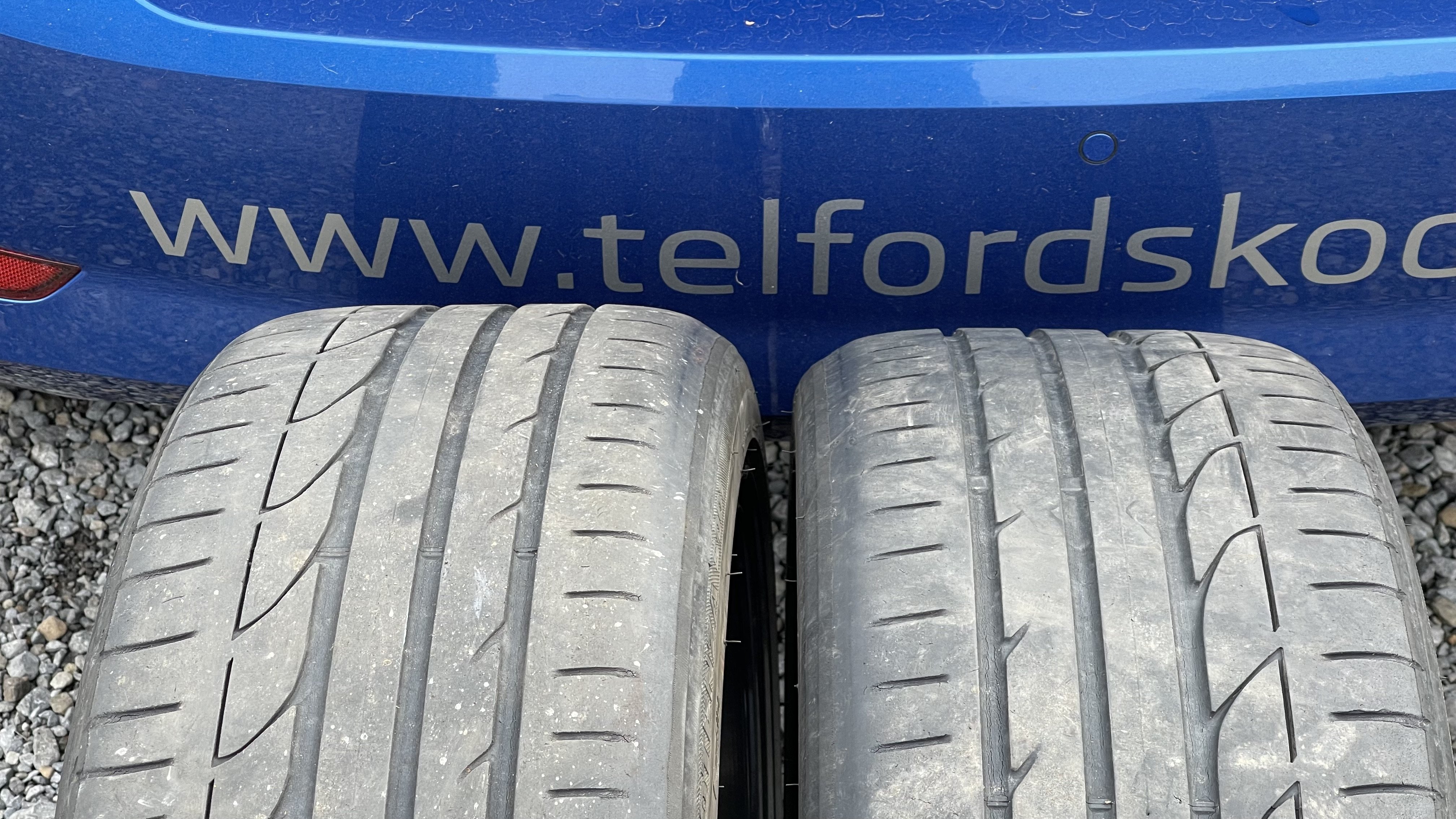

The two tyres pictured are the original tyres as supplied with the car. They both measure 4mm tread depth across the tread

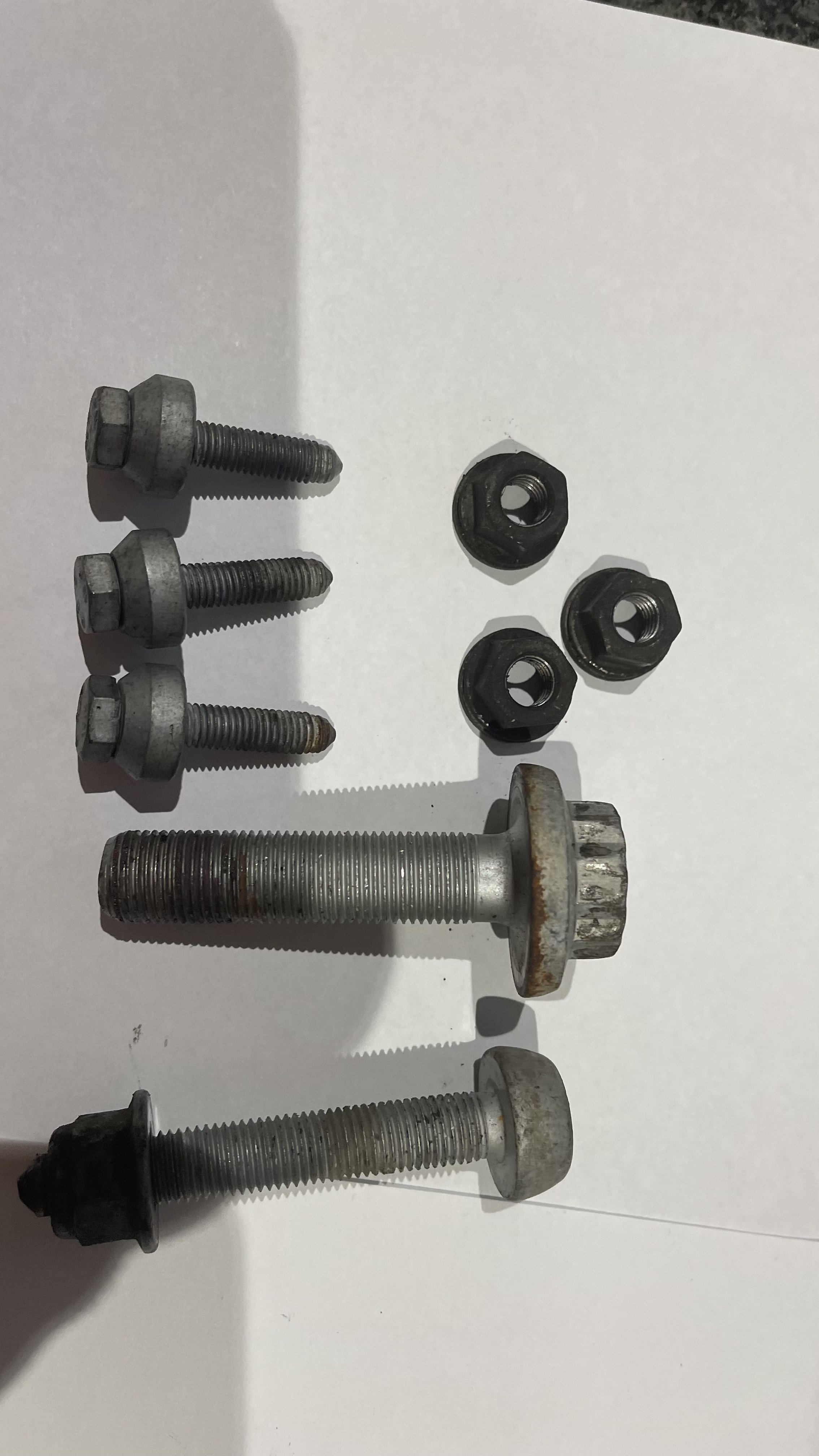

I wasn't shown the other side and it would be very difficult for me to see with the wheel in place. I sincerely hope it is as you suggest and not a bodge repair. They did and made great ceremony of handing me the old ones in a plastic bag, explaining the threads may have stretched or something.

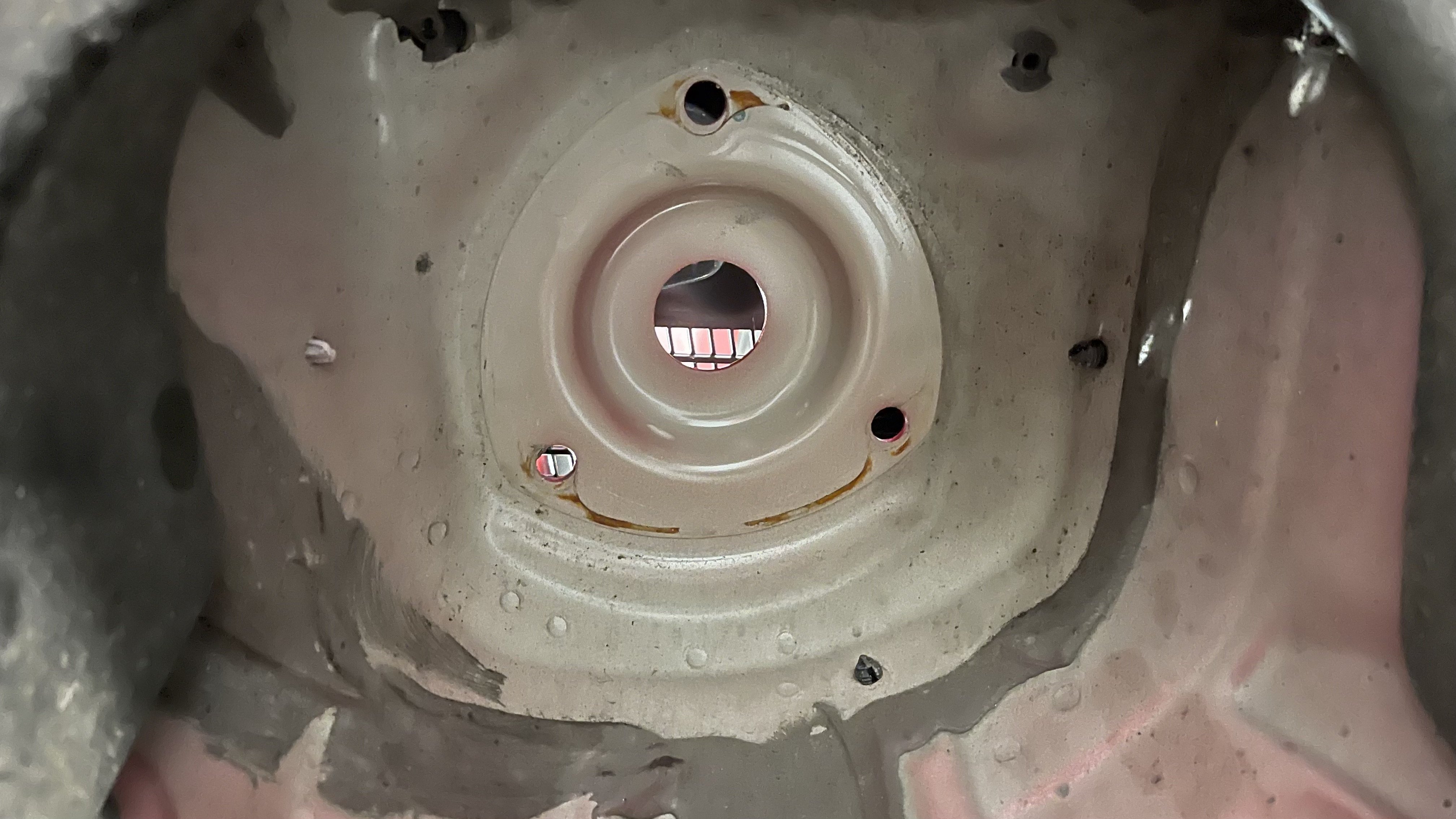

The garage has done the work - or at least what they deemed was required. There appears to be much what to me looks like epoxy glue (grey colour) at the top of the wheel arch where the strut is attached. Is this normal or is it a repair? Thank you for your help 07165C2D-C1BD-495F-B533-874F314814C4_1_201_a.heic

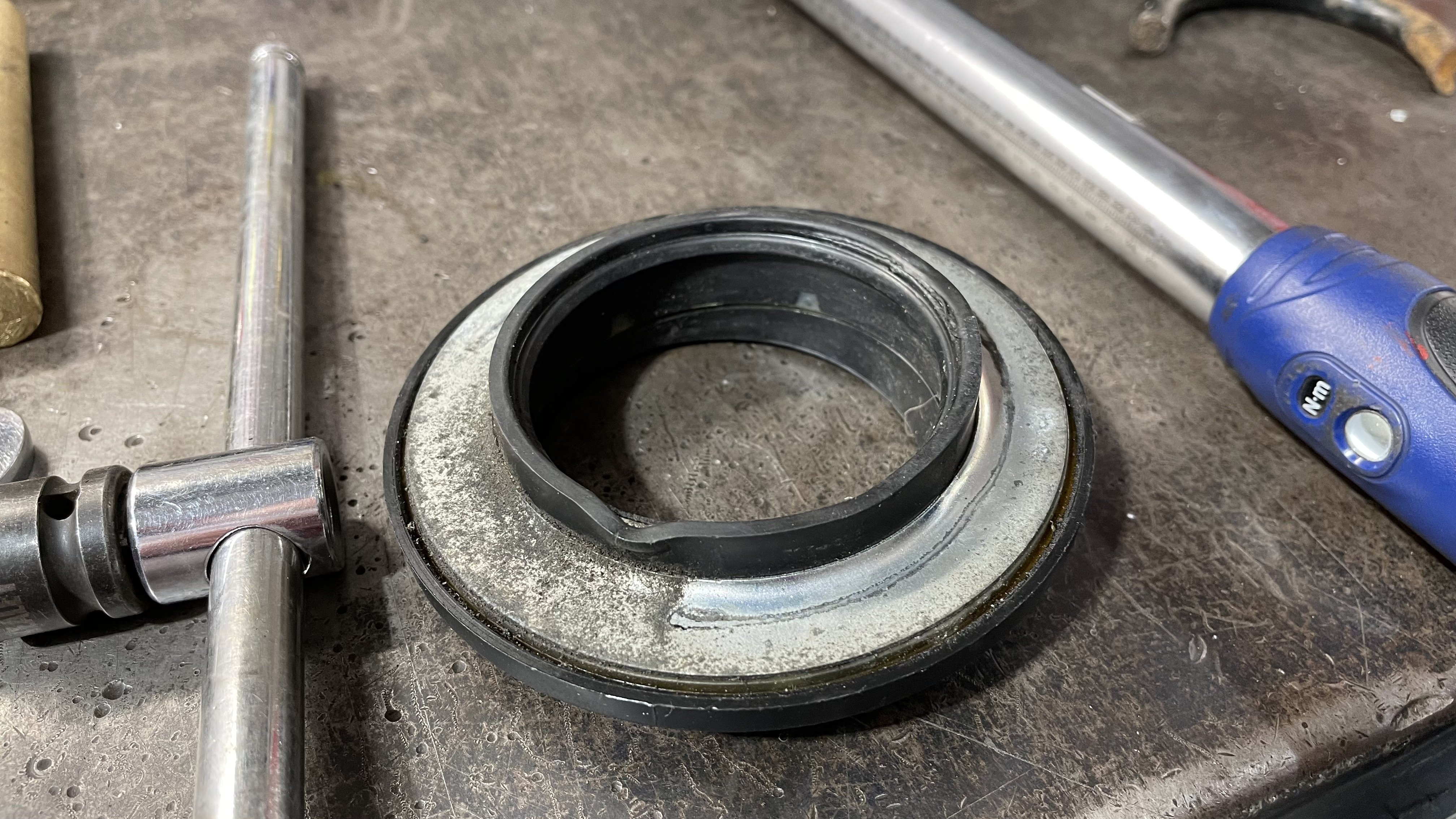

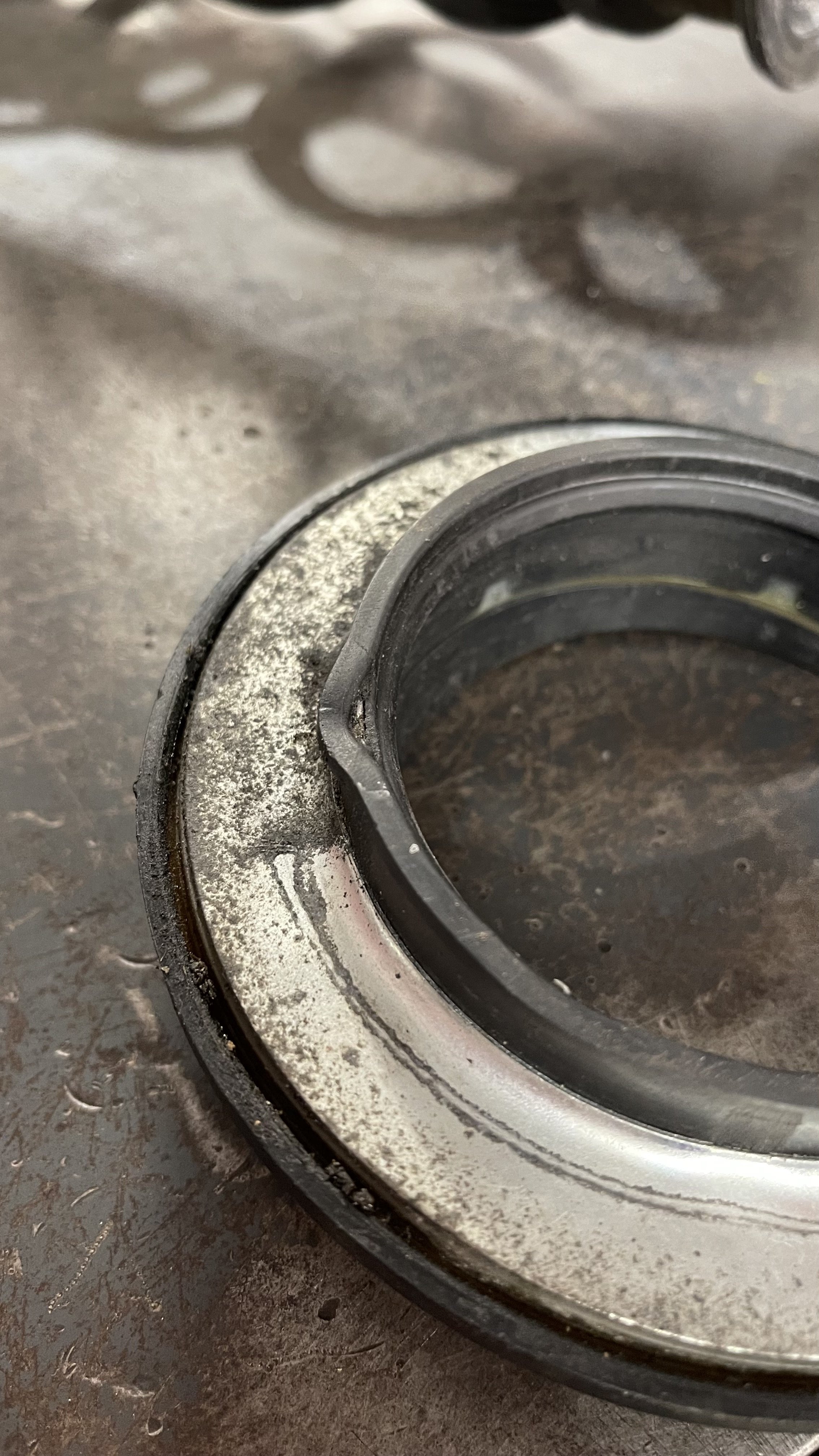

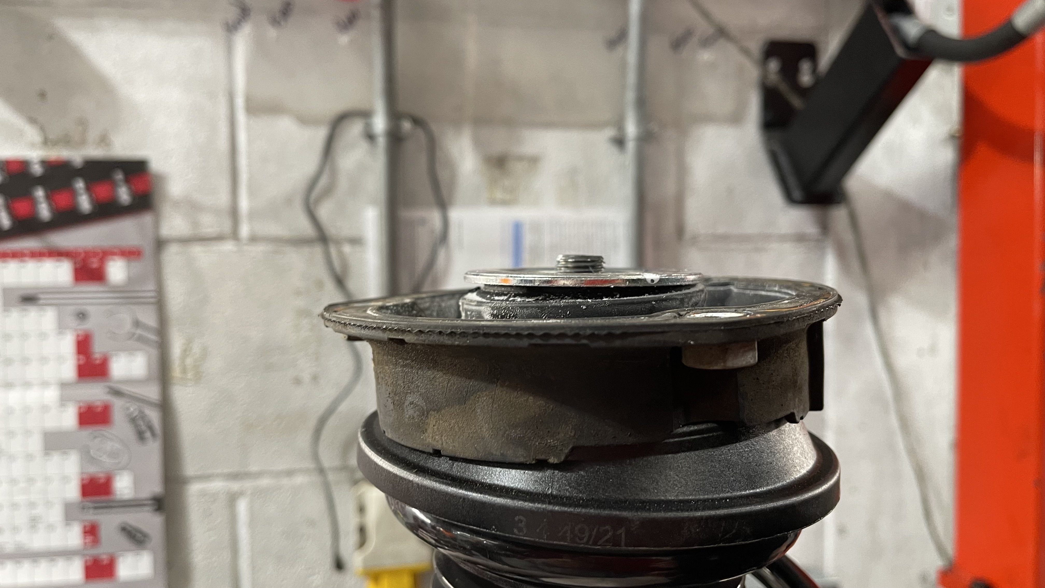

Thank you all for the inputs so far. Very much appreciated. I have spent the last two days at the supplying dealer, which unfortunately involved much unpleasantness and their blaming anyone and everyone apart from themselves when it is black and white their responsibility having supplied a car with the transport blocks still in and the damage clearly as a result. I will post muchness more later but my brain is currently frazzled with the stress of it all, so meantime here are some pretty pictures π They have only replaced a few of the items I was advised needed replaced and only on one side. They were even going to refit the top bearing which they accepted is knackered, despite a 10 minute argument, until I told the dealer owner I was very unhappy with that and she came back claiming they were always going to replace it, which they now have. If anyone can advise if this is likely to cause negative camber and that that's what the tread wear definitely shows then I would be very much appreciative. Also if anyone can advise re alignment checking is the local Halfords up to the job or does it have to be a fancy VW approved 4 wheel check as the dealer is specifying?- Transport blocks left in
I don't pretend to be an expert and am happy to be advised by someone who actually knows, hence why I am asking. I am advised that negative camber will produce wear unevenly across the tyre and not even wear across the tyre with just the inner edge worn at 45*. If as you say it is negative camber what would cause that? Was the car supplied to me with negative camber or is it as a result of damage potentially caused by the blocks being left in. Those who changed the tyre advised the struts knackered, dust covers burst, bump stop chewed and jammed inside. They advise both struts and strut mounts need changed. The supplying dealer will not as they claim they are fine. How can I tell who is right? What needs to be done to stop both the tyres wearing on the inner shoulder?- Transport blocks left in
Tyres are already changed at cost to me. I was advised by those who changed the tyre I should expect to be recompensed by the supplying dealer- Transport blocks left in
I am concerned that what the dealer is currently doing (not much more than removing the blocks) may not address the tyre wear issue, possibly linked to damage caused by leaving the blocks in- Transport blocks left in
Oh - and I did get a free inspection previously by a different Skoda dealer who were unable to find the transport blocks were still in. They could tell me there was a problem, but not what it was, but could tell me it would be over Β£1,000 to sort... - Transport blocks left in
