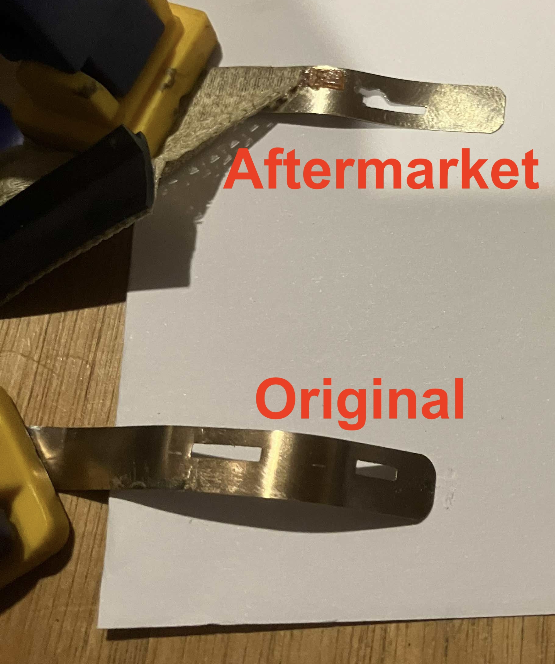

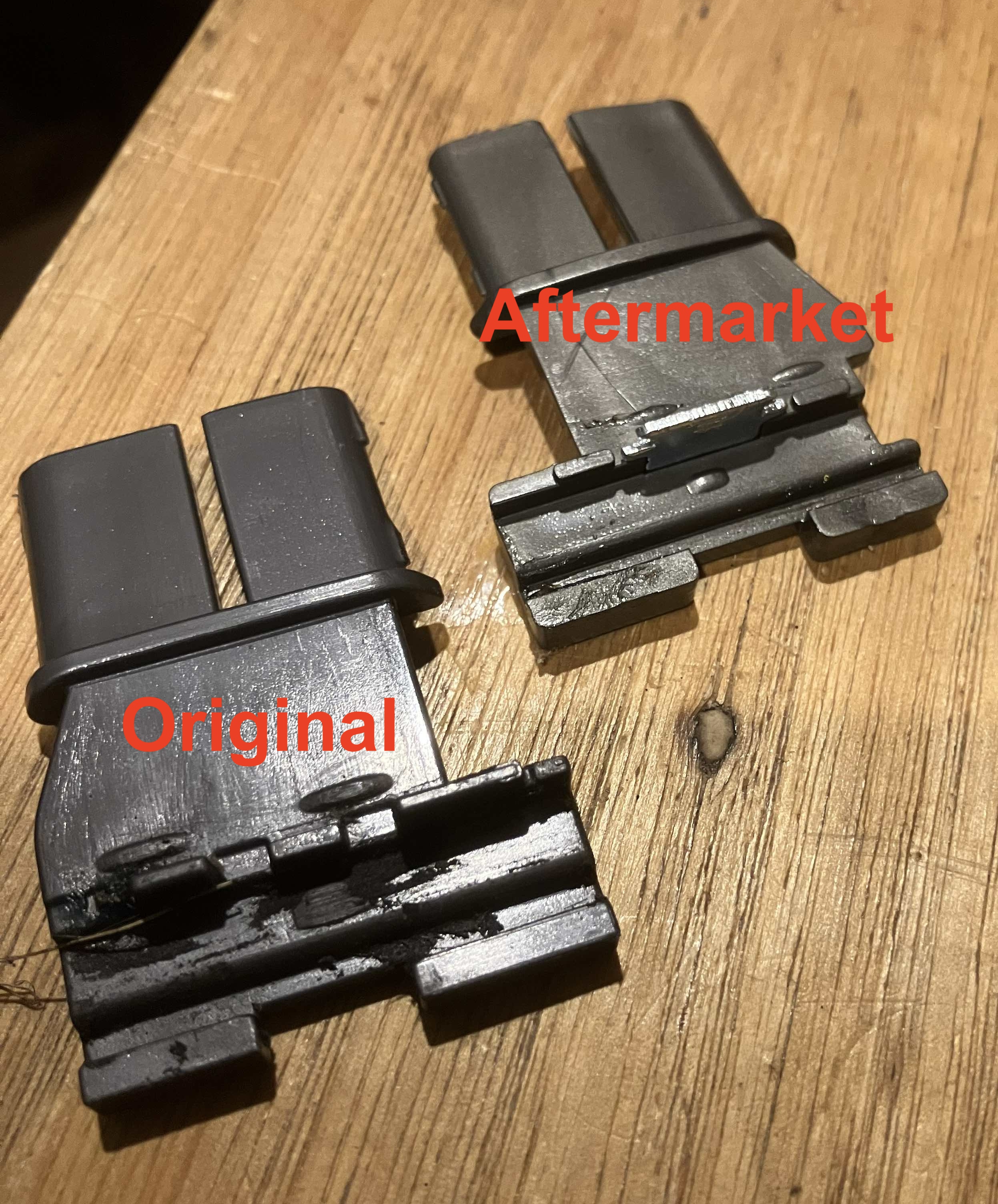

  4. Solved. I wasn’t feeling the spring steel runners into the track. Good video on youtube for those with same problem: https://youtu.be/N5beaqdfrDQ?si=3yruyWnCG1nRvkim
  5. I've had a hell of a time replacing my roof blind. I have been through two that I got off eBay - they both ran off the runners when retracting the blind and bunched up. I tried putting a piece of dowel in the second one to stop it deforming, and while it helped it didn't solve the problem. They are the same width as the original but use a different runner system as shown. I haven't yet found any that have the original, and would rather not pay Skoda's usurious parts prices... Has anyone found an aftermarket that works? Thanks

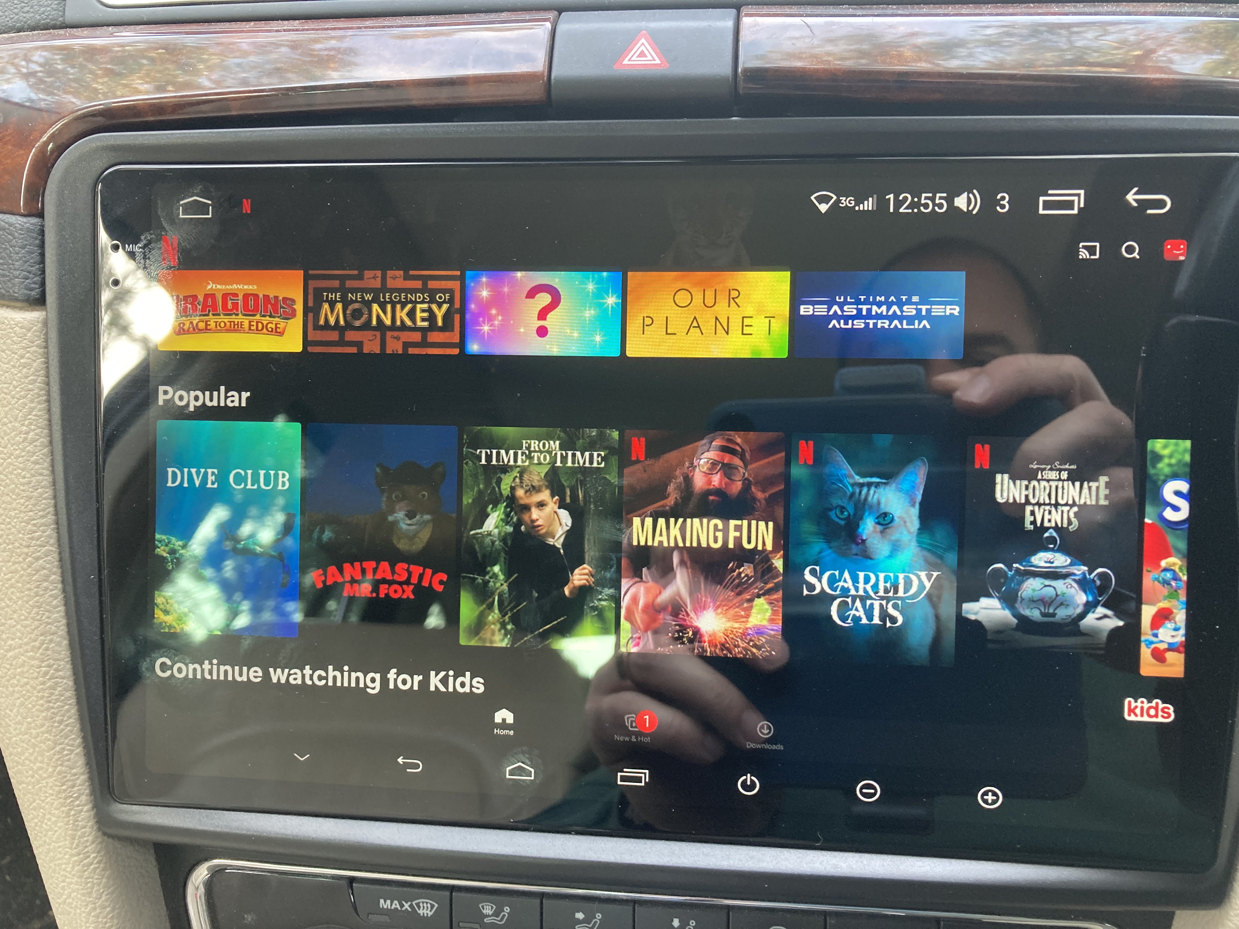

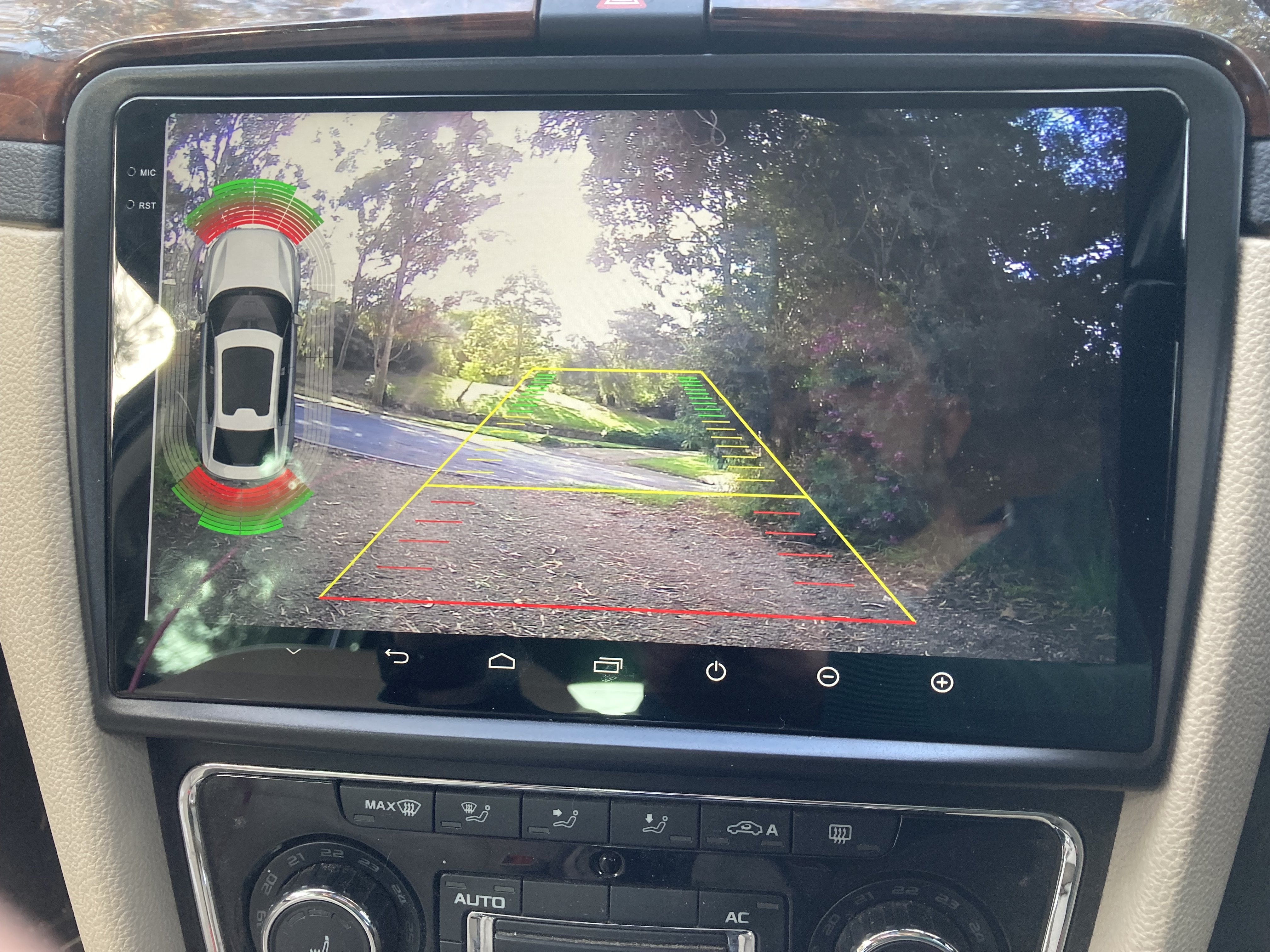

  6. I got the HD front and rear combo, also the HDMI in option (has to be ordered separately), DAB (sep antenna, put on rear side window behind c pillar- station wagon). Existing antenna works fine with GPS and FM radio. Be sure to get the superb specific one for bezel. the seller barely understands English so have low expectations of comprehension.
  7. I bought the maxed out one 8/256. In hindsight 4/64 or 4/128 should be enough if using car play.
  8. A slight background hiss when nothing’s playing. The carlink can be a bit clunky and only connects via bluetooth. The UI is a bit clunky, chinglish. Less of an issue if using carlink. Otherwise see XDA forums. Not for amateurs though. Lots of fiddling needed.
  9. I ended up doing it… mekede m6 pro 2K from ali express Huge improvement, some flaws I can live with, but you need to have some tinkering experience and don’t expect much support from the seller… https://a.aliexpress.com/_mMgfnPO https://forum.xda-developers.com/t/mekede-m6pro-plus-with-2k-2000x1200-screen.4516547/
