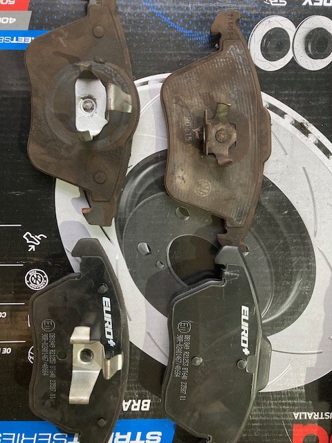

Yes, you are right. They apparently fit other build codes. I am going to try these, which appear to match and are in stock near me (I have the front wheels off, just changed a rotor): https://www.bendix.com.au/products/db2210 There’s a DBA pad with the same model code that the manufacturer lists as fitting 1LK and looks like a close match.

Thanks. I went through my car’s option codes and I have a different brake variant (1LK). Mismatched by the place I bought it from.

Hi, I bought some pads (Bendix DB1849) that supposedly fit my car. However, the outer pads are missing the retainer clips that the OEM ones have. Per pic below. Are they needed? Thanks
