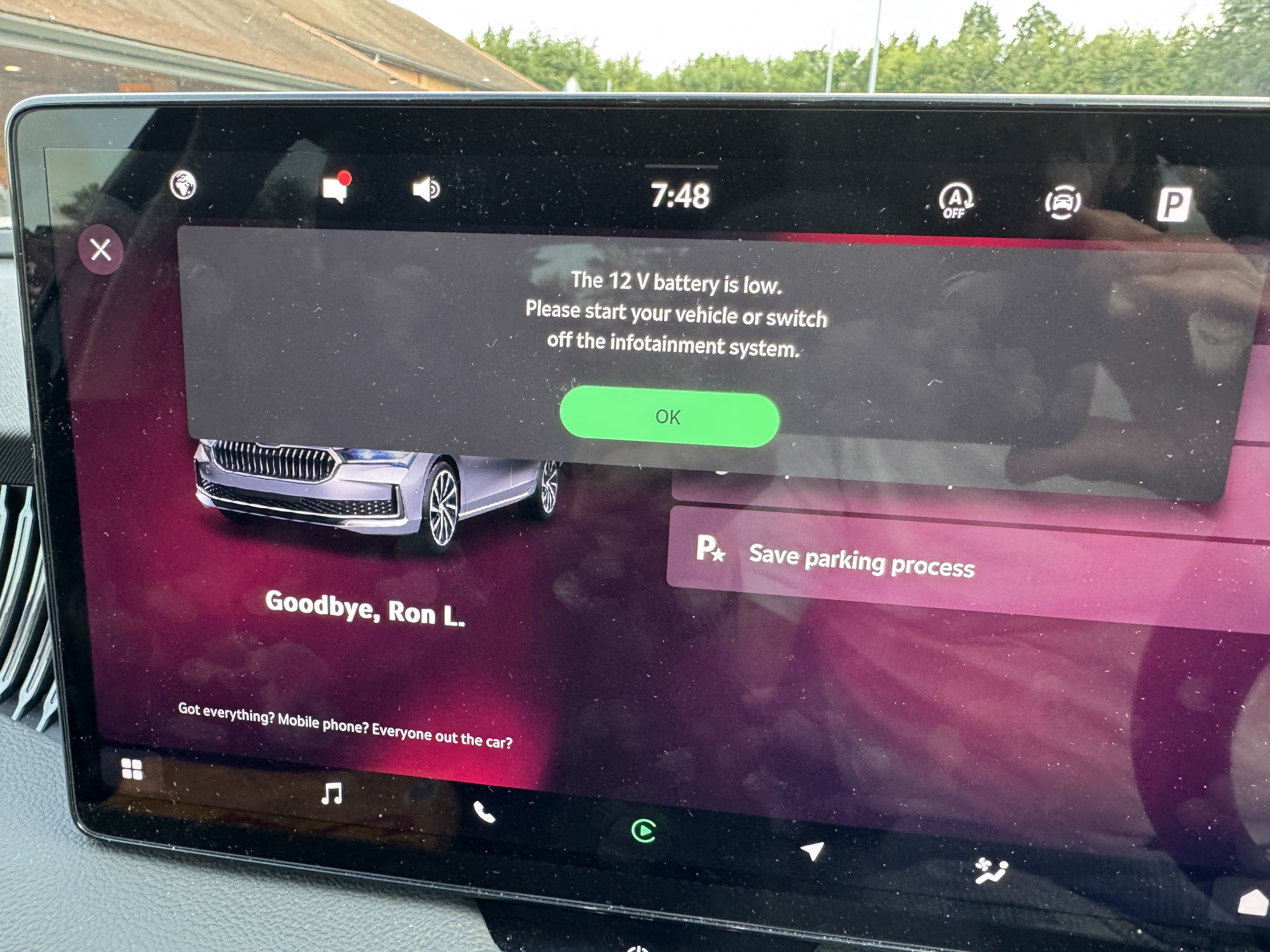

  4. My car has been in garage since Wednesday. They had to go to Skoda technical who think they have solved it. It is having a software update and should be ready Monday. Like you I have had great experiences with my previous 2 Superb’s, but this one has not been so good.
  5. Battery was replaced by Skoda on the 1st visit a few weeks ago.

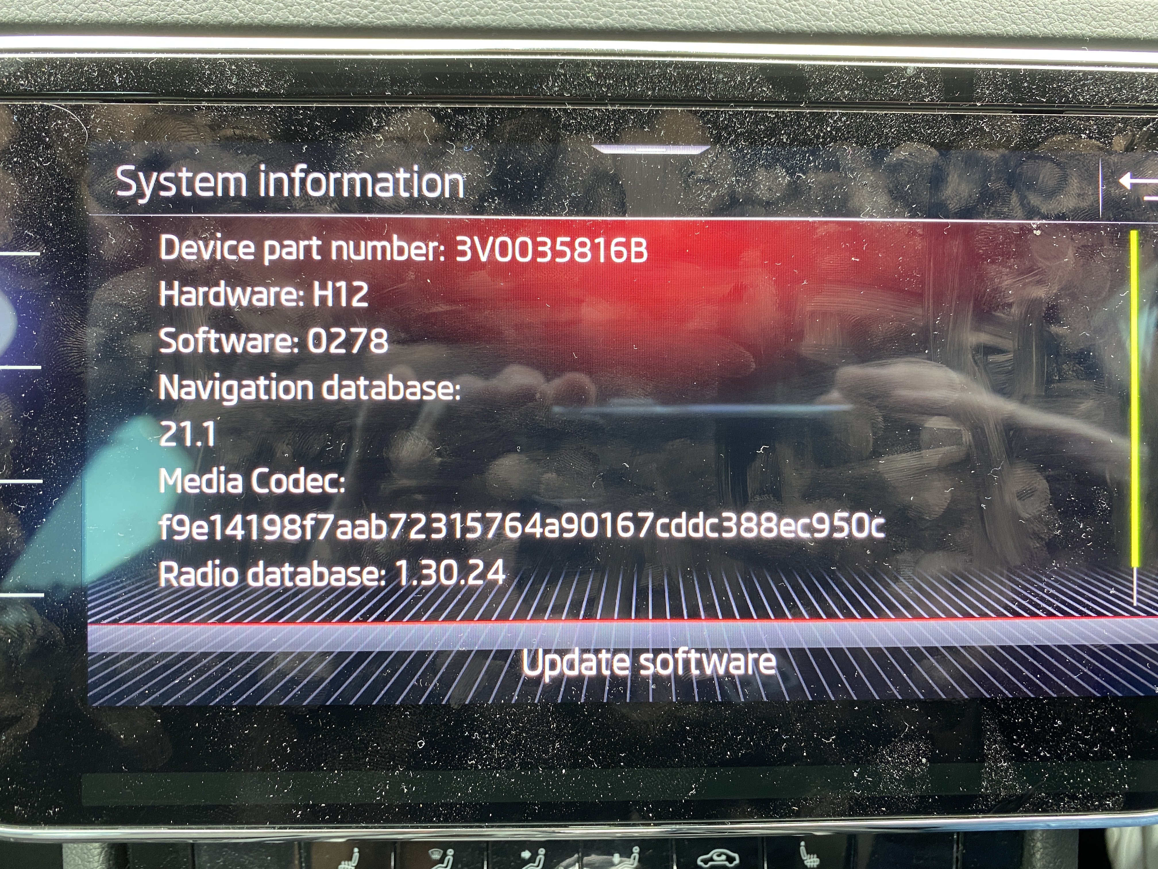

  7. Has anyone on the forum had any success upgrading the system software on their Columbus system from 0278? I struggled to get my system updated to 0278 a year ago (thanks to this forum I could produce evidence there was an update). Apple car play was next to useless, but every time I took the car to the dealer they said there was no problem with the car and there were no updates. A year on and although car play still works, it's very glitchy and my dealer is telling me to get an update I will have to spend £114 for diagnosis with no guarantee they will agree to an update. I've heard rumour of a version 0324, but I'm not sure if it applies to my car or if it even exists. Any help would be gratefully received so I can go and take it up with my dealer (again!). Thanks in anticipation.

  9. Update as promised. Took car into dealer on Tuesday morning and have just picked it up (3 days). As you can see from the before and after images, software has now gone from version 156 to 278 and the device part number has had a 'B' added to it. Apparently the update failed twice before it finally succeeded. The service rep did say that there was another major software update due in June if this one didn't fix the problem. It's early days, but all worked perfectly on the 30 mile journey home (but it's done that before). Re the comment from ERIK99, it's difficult to know who is giving the correct information, but my dealer told me the updates don't rely on a subscription to connect.

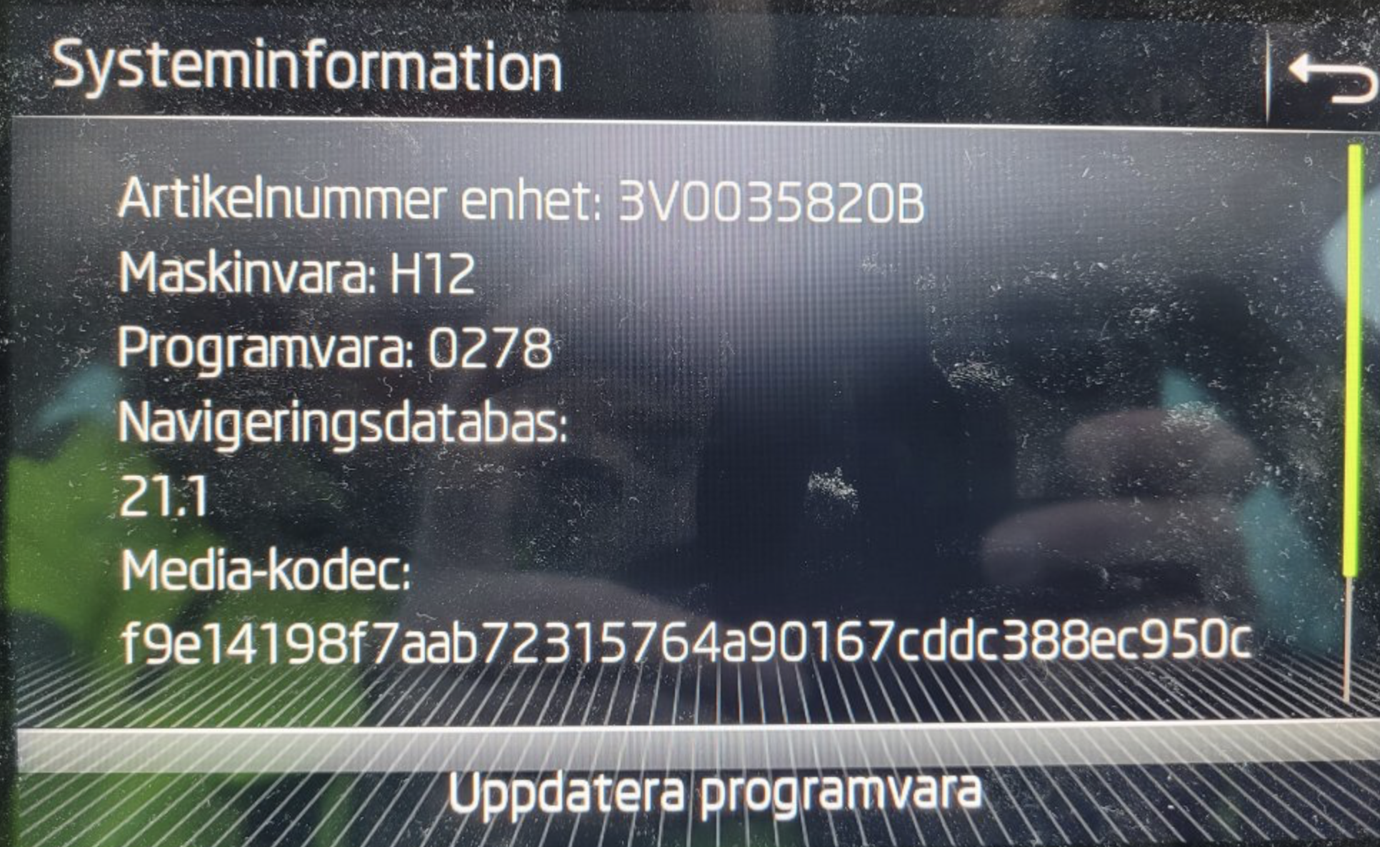

  12. Car is due into dealers tomorrow to have this looked at again so I have been doing loads of research since your post. I am 99% certain there has never been a successful system update since the car was new. I found the ‘service’ menu (hold finger on the menu button) and it lists all updates. The only updates are dated 2019. Someone also posted a pic of their uK system stats, same PN as mine showing 0278 update. I can only hope I can persuade the dealer to look into the issue properly this time.
  13. Thank You Simon. I did a bit of extra research in this site after your comment and it looks as though you are right and my suspisions were correct. I found this on another post. What's annoying is it does confirm my dealer has been telling porky's as they have never updated the software.
