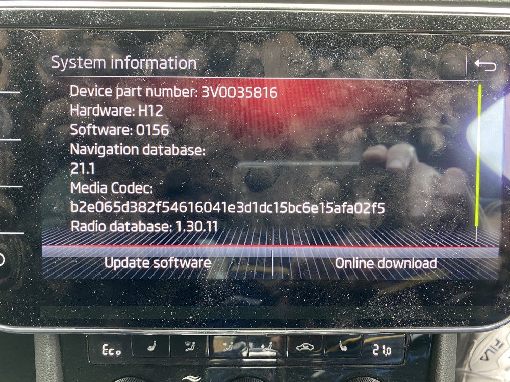

Ever since I've owned my Superb, I have had problems with my Columbus Infotainment system. The car has been to my Skoda dealer 3 or 4 times so far but the issues are never resolved with the dealer either saying the have updated the software (they haven't), they have reset the system or they have tried a software update but there isn't one. I have a suspicion the system has never successfully updated, but I can find a definitive answer, anywhere online, as to what the latest software version for my car should be. During the time I have owned the car it has informed me that there is a software update available, but I am convinced it is not completing. The last time it did this, the system said 'preparing update' and then I got a screen message, 'Cannot start backup services'.
The issues I am having are either Non-Apple CarPlay issues or CarPlay issues.
The none CarPlay issues are the system refusing to load my profile. This happens about 3 times a week and the only way to clear the fault is to turn off the ignition and leave the car for about 15 minutes. A soft reset (holding the power button) will not reset the problem. The other issue is the system simply crashing and re-booting while driving. Sometimes the profile reloads and all is well, but once or twice it won't reload the profile. This is a real pain when I'm actually driving as I lose access to any satnav.
The CarPlay issues are numerous. Things like the sound dropping out of a phone call right in the middle of one (I can hear them, they can't hear me) or What'sApp/Messenger showing it's playing a message but I can't hear it.
I've attached a screenshot of the latest software details. I've anyone could advise I would be grateful. Car is going into dealer again in a few days.

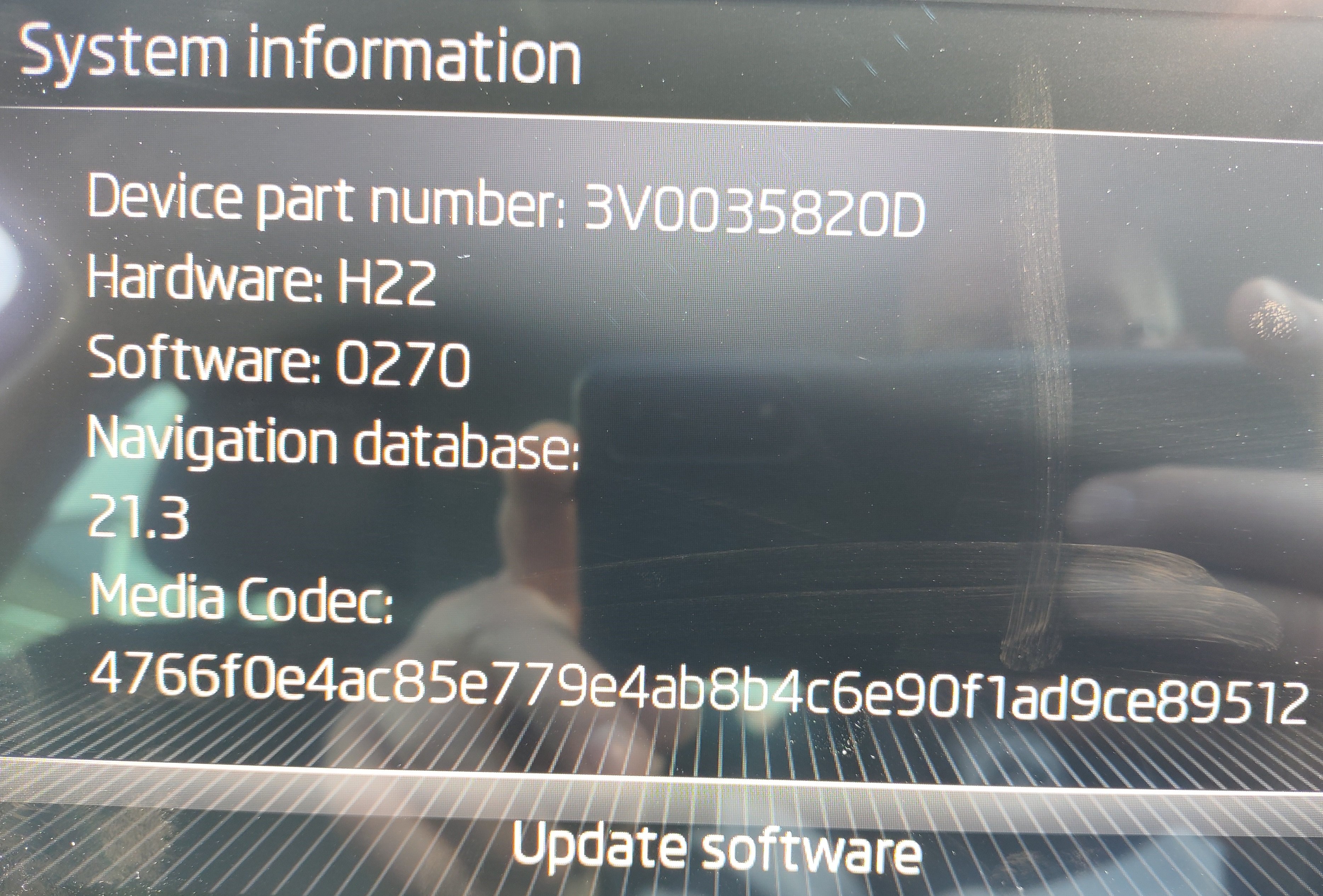

There is a software update I believe it to be 0270 yours is currently 0156.
Thank You Simon. I did a bit of extra research in this site after your comment and it looks as though you are right and my suspisions were correct. I found this on another post.
What's annoying is it does confirm my dealer has been telling porky's as they have never updated the software.

At least you can go to the dealer and tell them what level it should be on.

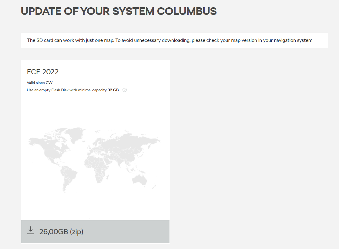

https://updateportal.skoda-auto.com/en-GB
Someone linked to this once which is pretty useful. Put in your VIN and it'll give you the update.

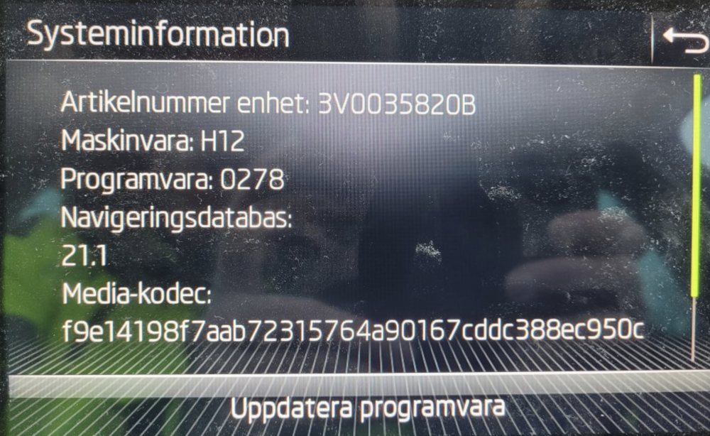

this is very interesting.
This is obviously not a UK car, so I wonder if dealers outside UK get different level of service.

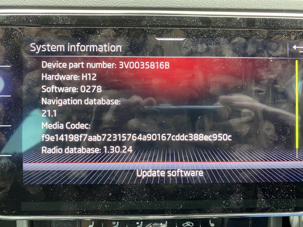

Another owner on this forum has a software version of 0278, so there is most certainly more updates to come.

I find the next bit absurd, but here it is - your car downloads the new map from the USB stick as you drive around.  It only downloads the updates it needs for your current position.  Skoda recommend leaving the USB stick in at all times so that you have the most up to date maps!  The instructions for doing this are all hosted on the Skoda Portal too.

LOL! Erik, it is not a story I'm afraid.  Go to the Skoda Portal; the instructions for doing this on MIB3 are linked there on the front page.  If it hasn't worked for you then you should inform Skoda Customer Services.  I'm going to wait until the other issues with my car are addressed before I try.
The map updates are free.  I still get them on the Skoda Portal and only have the 10 year SOS call and OTA system updates subscription.  The annual subscriptions have lapsed.

I've just been in to check mine.  This is what my car is showing at the moment.  It's a company car, so I'm fully subscribed.
This is insane - I've been wondering where the SD slot referred to in all the documentation is; at no point does anything talk about OTA updates.
So I'm on 270, I had an update download while driving (stopped when the car moved, but continued when we were in traffic. I now get a popup telling me to install an available update but when I click on the install button, it goes to engineering mode and then has nothing in the list of media to install from.
