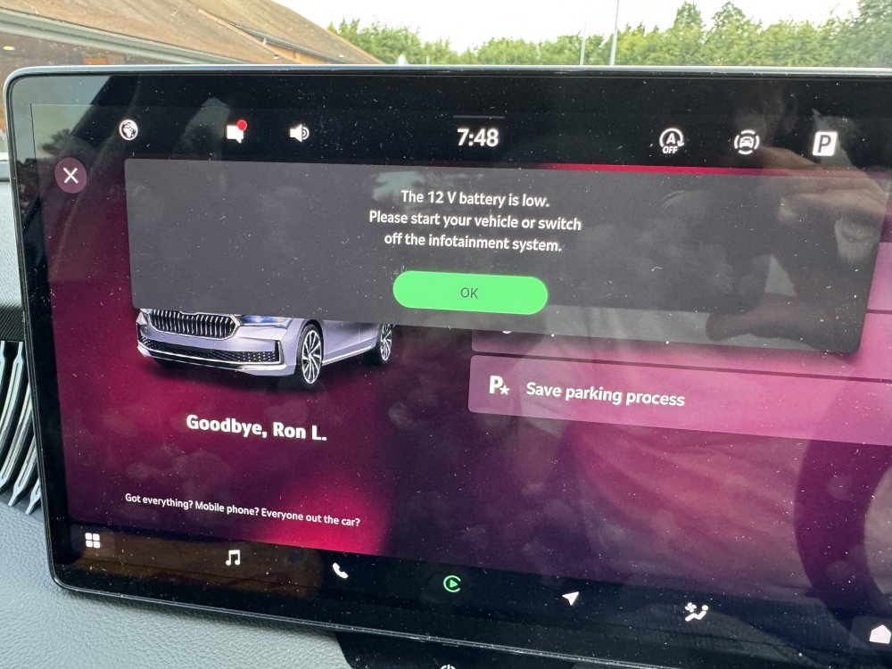

  2. 12v battery low Spurious dash warning messages Something regarding SatNav (I don’t use it) Update def seems to have fixed my problems.
  3. Picked up my car this evening. It's had a software update which apparently was a recall for other Skoda models but not for the Superb until last Friday. Dealer agent read me the 'fixes' that the update provided and it seemed to match issues id been having perfectly (except satnav as I use Waze on CarPlay). Let's wait and see:-)

  6. Has anyone else had an issue with their Skoda Superb software reporting a low 12v battery? As soon as this fault develops, my car profile keeps loading as ‘guest’ and the door lock/unlock system on approach, stops working. If I trickle charge the battery all the faults go away for a few days, but then return. My car has been into the dealer twice so far for this fault. The 1st time they changed the battery but the 2nd time, although they could see the errors in the cars logs, they reported ‘no fault found’ (they did wash and vac the car). It’s clear something is discharging the battery (I have a dash Cam which I have disconnected) but thought I’d ask if anyone else has experienced this B4 I take car back to garage this week. Thanks
