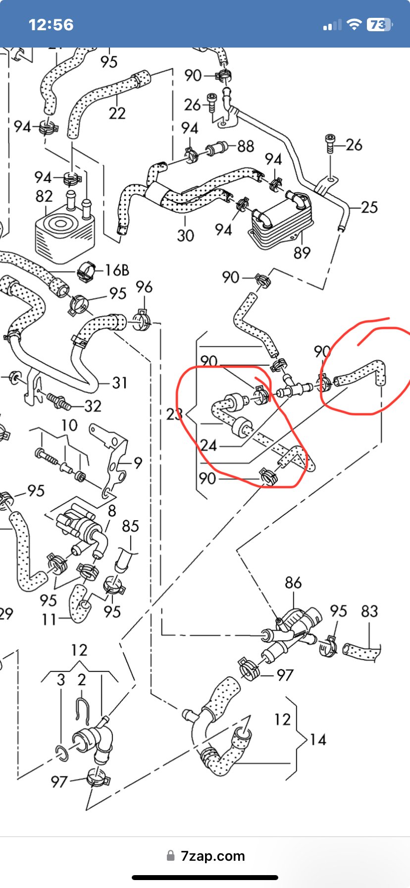

  15. Hi sorry not updated it anymore yet,, But I have since changed coolant, expansion tank, radiator didn’t change the matrix as it was really awkward,, I did a complete flush as best as I could by holding pipes and covering holes so water would flush engine and the matrix,,there are 2 hoses that I think have a one way valve in (both mine were blocked)I’ll add a photo,, these 2 pipes helped me no end as I wasn’t getting any water overflowing into the top of the expansion tank thus I think keep an airlock in the system,, the flush out and radiator change in my opinion seriously helped as I now have only a slight pressure in the system and don’t even bother to release it every morning as it stays the same pressure if I leave it one day or a week, pipe 23 goes to top of radiator and to a plastic part down the right hand side of engine then from the tee piece back to expansion tank these 2 pipes are definitely worth checking to see if they are blocked I just took one pipe off and tried to blow down it both ways and it was blocked so I just whacked it on the floor a few time and a load of gunk flew out. Oh I have now always got heat in the cabin,, although barring flushing I didn’t do anything specific for the matrix
