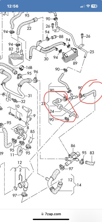

  15. Hi sorry not updated it anymore yet,, But I have since changed coolant, expansion tank, radiator didn’t change the matrix as it was really awkward,, I did a complete flush as best as I could by holding pipes and covering holes so water would flush engine and the matrix,,there are 2 hoses that I think have a one way valve in (both mine were blocked)I’ll add a photo,, these 2 pipes helped me no end as I wasn’t getting any water overflowing into the top of the expansion tank thus I think keep an airlock in the system,, the flush out and radiator change in my opinion seriously helped as I now have only a slight pressure in the system and don’t even bother to release it every morning as it stays the same pressure if I leave it one day or a week, pipe 23 goes to top of radiator and to a plastic part down the right hand side of engine then from the tee piece back to expansion tank these 2 pipes are definitely worth checking to see if they are blocked I just took one pipe off and tried to blow down it both ways and it was blocked so I just whacked it on the floor a few time and a load of gunk flew out. Oh I have now always got heat in the cabin,, although barring flushing I didn’t do anything specific for the matrix

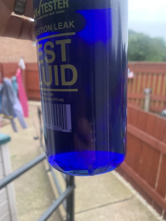

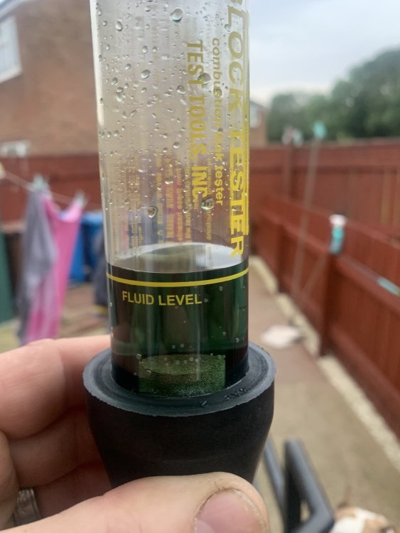

  20. Well I bought a block test kit and put it on this morning,, definitely need to go and get it checked properly but done twice with same results 😢😢that’s the blue colour it should be and it says if it turns yellow gases are present,, in a diesel it my turn green/yellow 😢😢,, oh dear looks green to me,,

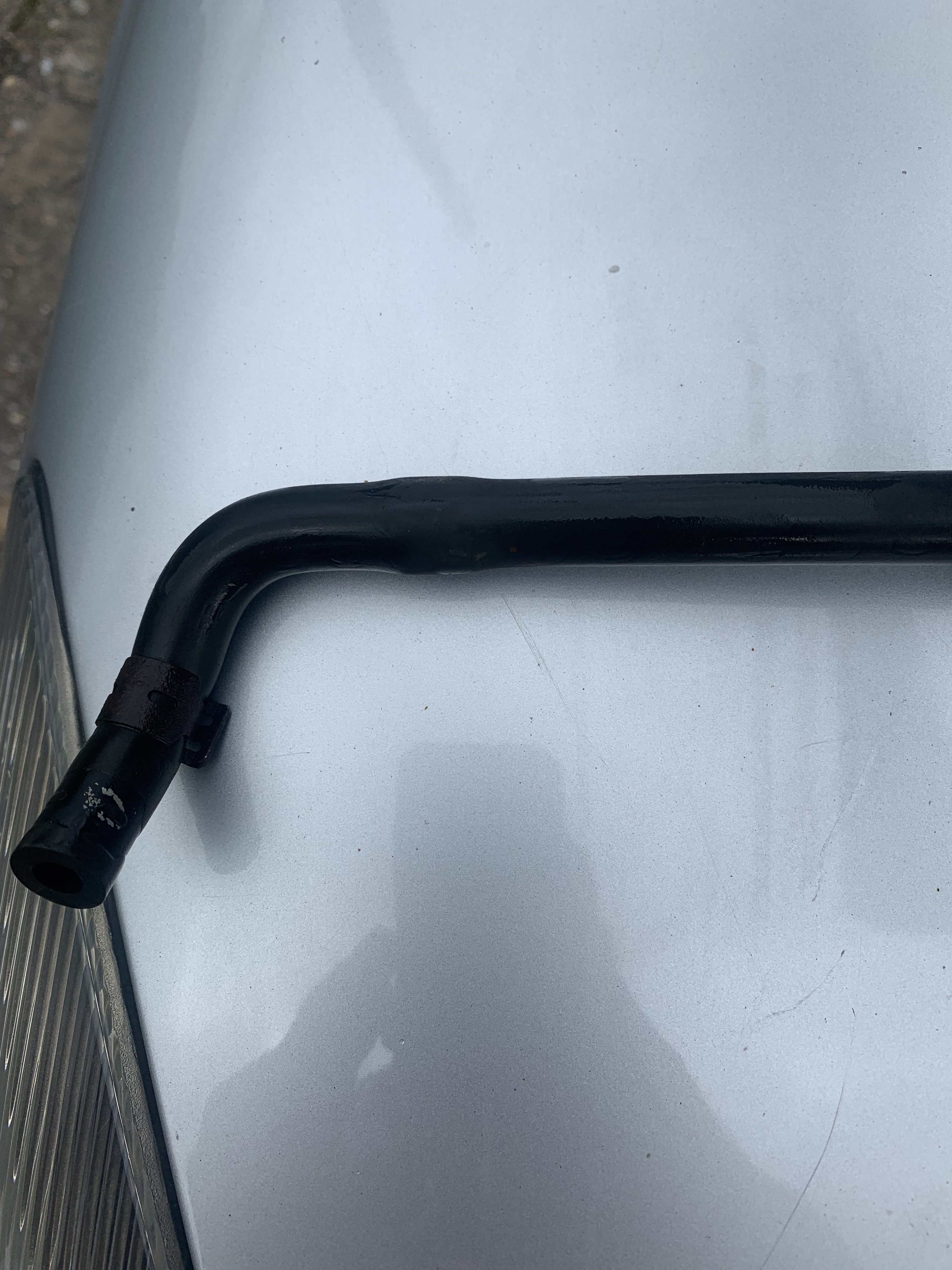

  21. Morning peeps,, right after a bit of googling and not been able to get sniff test due to they can’t do a diesel lol,, I searched tinternet and came across some guy that said to check the pipe from the top radiator hose that goes back to the expansion tank as inside there is a valve or something that gets blocked and won’t allow air stuck in coolant to escape my pipe was blocked so I unblocked it filled back up left cap off and let the fans kick in 3 times to make sure I’d got out the air,, I now only have minimal pressure in a morning when I release the cap and the temp gauge now takes a lot lest time to read 90 degrees,, this is the pipe it goes behind the air intake and the air box you can just see a slight hump in the pipe where valve is,, I’ll keep an eye on it for a while but hopefully this has solved my issue thanks peeps
