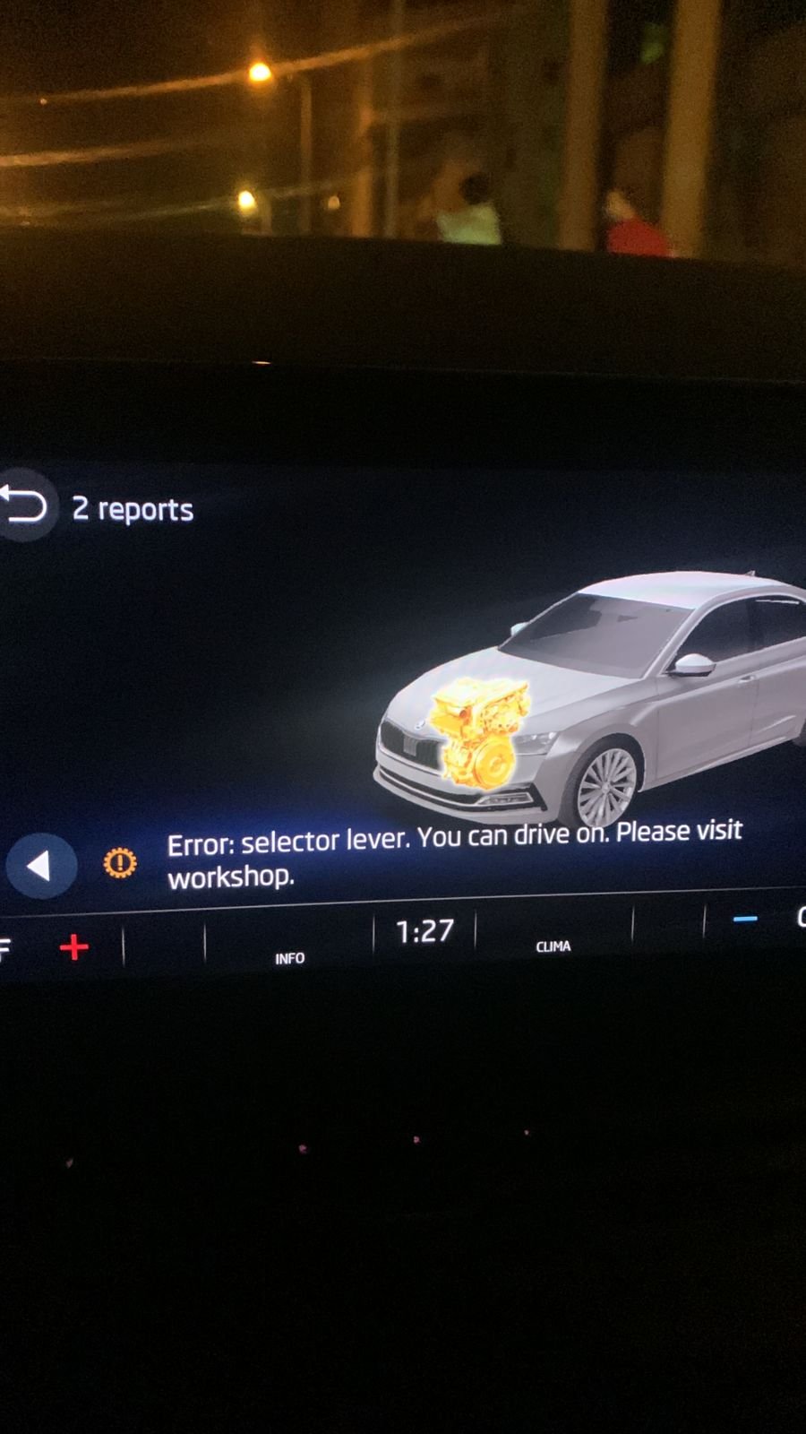

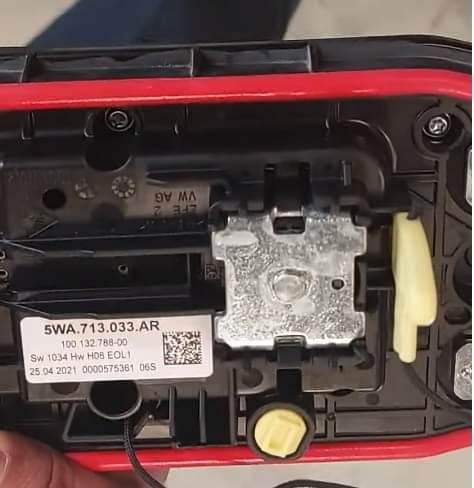

  1. Only selector mechanism issues with aisin 8 speed automatic torque converter no other issues with the transmission itself and they require atf change every 60000 km intervals
  2. Can you tell me the part no of the new selector mechanism
  3. I think he mean the selector mechanism not the whole transmission and i dont think that pressing hard on the brake pedal will solve the problem i think it will take a time and will pop up permanently again

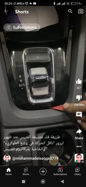

  4. All videos i found in youtube is in foreign language Russian and Arabic i post that video just to illustrate and say that's a simple solution this magnetic silver part have 2 pins that become loose by temperature and time and they tighten them and put some grease and the selector mechanism work again but anyway your dealer have to take care of it and change the selector mechanism with updated one
  5. https://youtu.be/-hJtN3uRqhY This is the solution
  6. https://youtu.be/XD2dTkBp1bM

  8. So make sure in case of it was the selector mechanism fault in your car that they don't put the faulty 5wa713033be and they will put an updated part no
  9. Yes they replace the 5wa713033ar with 5wa713033be and the problem still exist
  10. Finally this the old selector mechanism that end with ar and it was replaced by the one that end with be and we are waiting for the updated one and i hope it will work fine

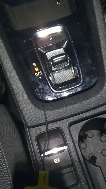

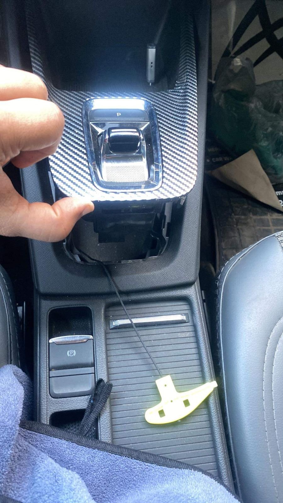

  11. This cable we use it in cases of emergency only we have the same shift by wire and when it stop shifting we have to use this wire to release the shifting

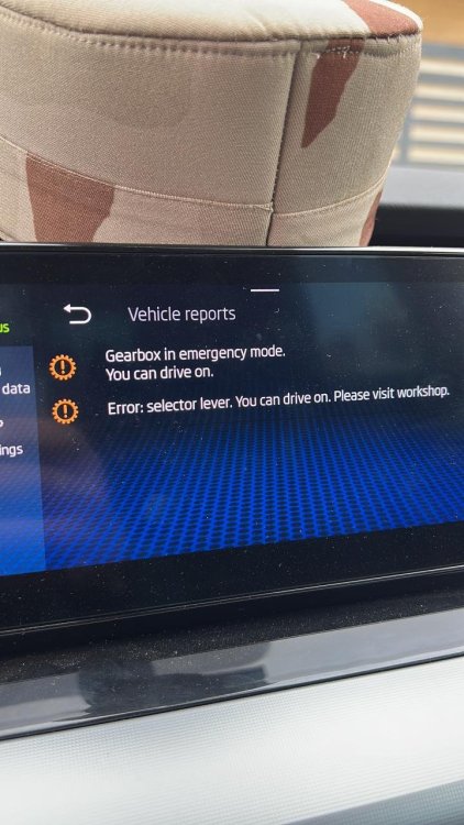

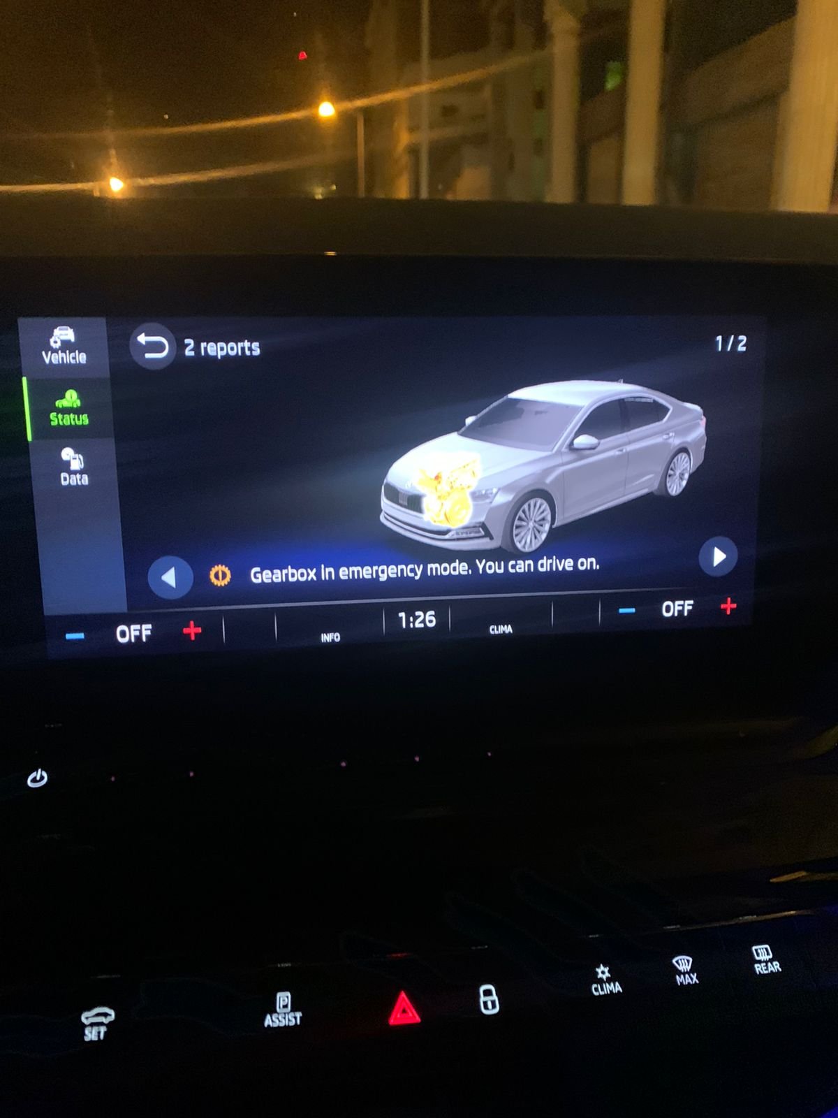

  12. Sometimes it gives the both messages and other times give only one anyway in case of your car stop shifting you have to release the black trim around the shift by wire knop and you will find a wire you have to pull it so you can select d or r
