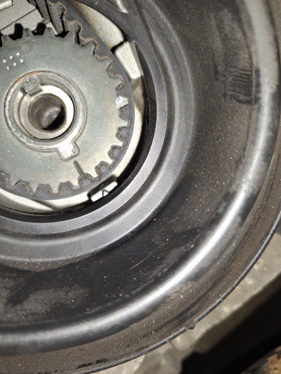

  23. Here's a picture of my gear. Not the best angle, but you can see the worn part on the tab pointing towards the TDC, but the rest looks okay.
  24. Yes correct, the key on the left has been completely worn away by the pulley but the key on the right is fine. I'll get some proper photos of my drive wheel / gear / sprocket (not sure what to call it now) when I get home to show the damage done. So looking good, just need to figure out how to extract the drive wheel, as there doesn't seem to be much info online about replacing it.
  25. So on the Vectra Z18XER engine they have the pulley (first pic) and it attaches to this crankshaft gear/sprocket (second and third pic). The pulley sits of a keyed ridge on that gear best seen in the third pic, then you tighten the crankshaft bolt down so that the pulley stays keyed with this ridge. Its this that has been sheered off so the gear is now basically flat, meaning the pulley now doesn't sit right. The gear however stayed in place the whole time, so I would like to think there is no damage to the crankshaft What I am wondering is if I extract the gear from the crankshaft and replace it with a new one, then get a new pulley and a new bolt, that it should be the end of it and hopefully its not damaged something internally. Sorry if I am not explaining it very well.
