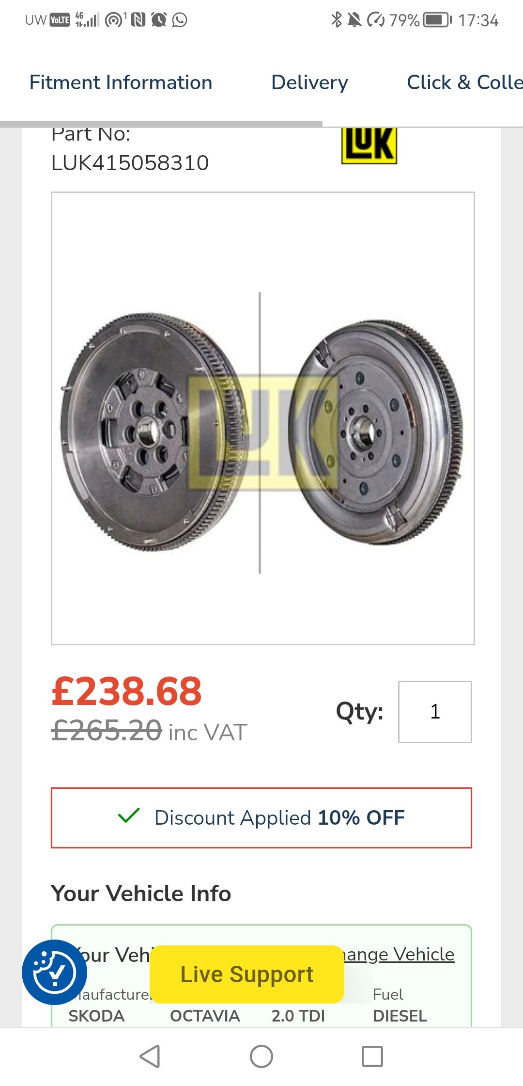

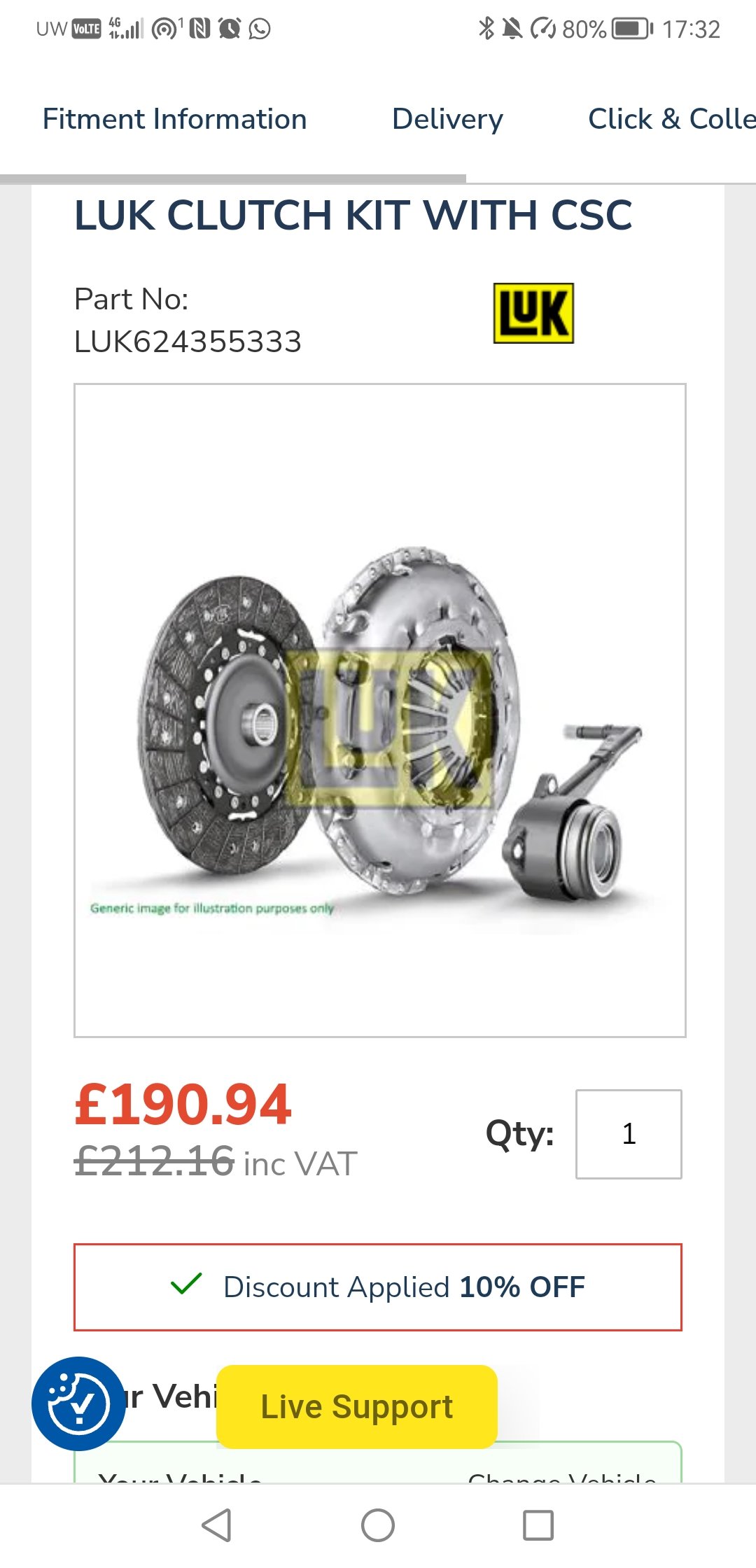

  8. Evening all, after hearing a grinding kind of sound with the clutch out and in neutral that goes away with the clutch pressed in, I figured it's time for replacement. After 138k and no receipts for a past replacement I'd rather get it done anyway than have it go at any point! However, there seems to be quite a few different options from all the factors and online shops for clutch, flywheels and other parts.... It's a 2014 150bhp CKFC TDi, and according to GSF these fit, but unfortunately I'm not in a position to buy different options and return whichever doesn't fit...I have a friend that's a mechanic and he's advised: Clutch kit around 250 Dual mass around 300 Slave cylinder around 90 These will be LUK parts Around 5 hours work Those rough prices would be going through the garage he works at. Are there any reliable options to search for the correct parts by VIN? I don't doubt him, but if I can save myself a load of cash buying parts myself it'll certainly be very helpful! I know there'll be a few other bits needed, but these would obviously be the main parts... Any help is very much appreciated!
