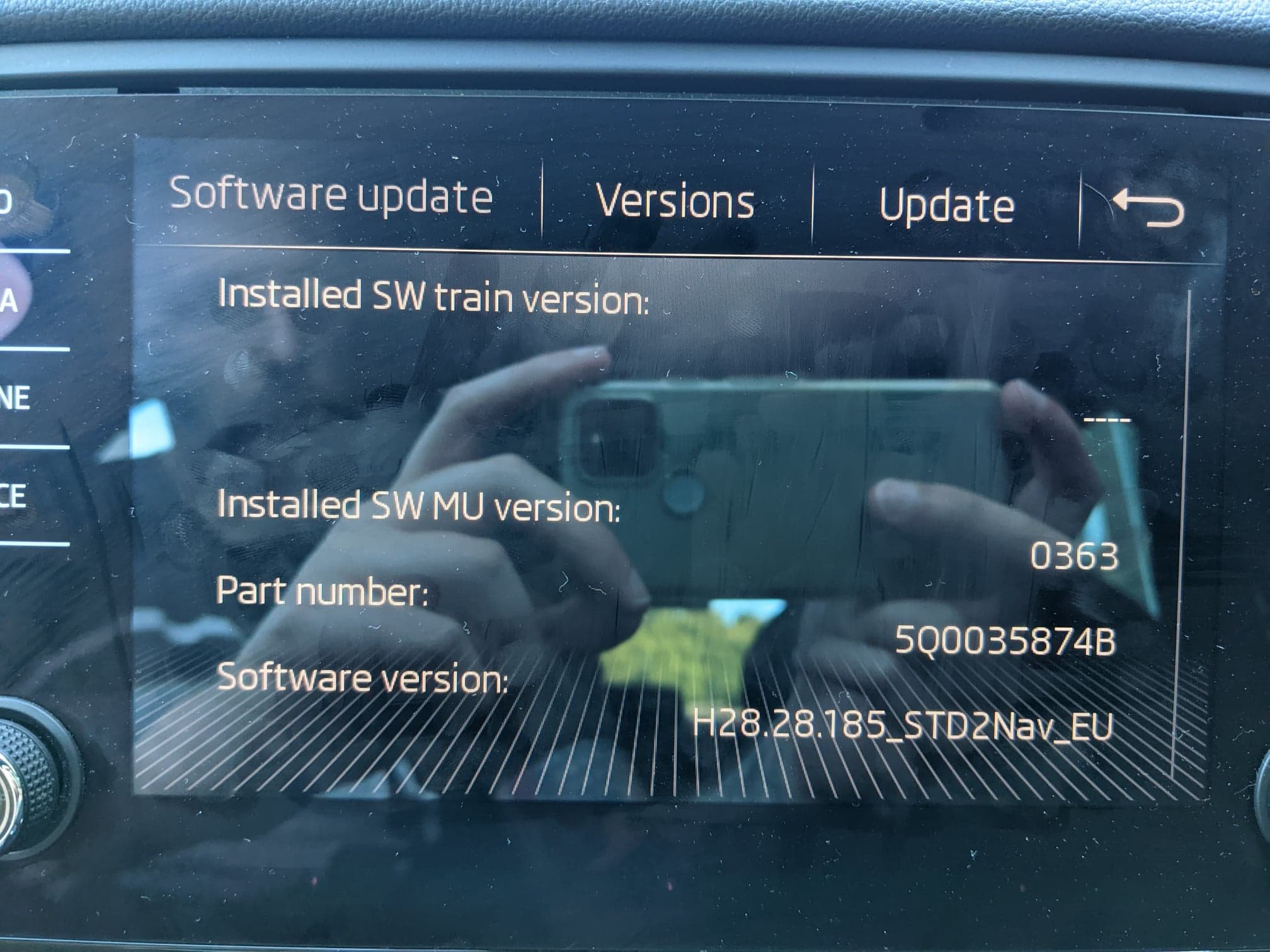

  9. Thank you! guessing that's the latest I can go up to on the hardware version I have installed

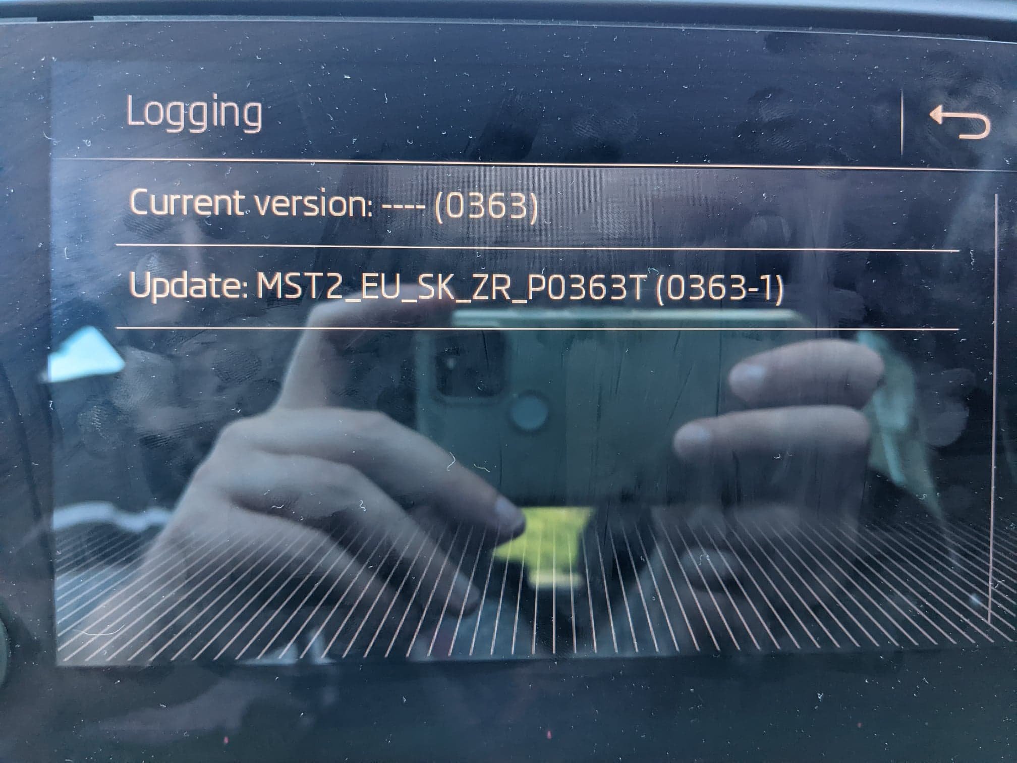

  10. Hi @varooom These are what it says when I enter the hidden menu. First SW Train is '----' but if you go into the 'Version' section you get the other picture. If I go into the logging section it shows the 2nd picture. Thanks. Lou.
  11. Hi @varooomThanks for the reply. I'm not sure what you mean by the "SW Train" version. I can see that there are new maps available to download which I will do but for the 'Software' section it says this.
