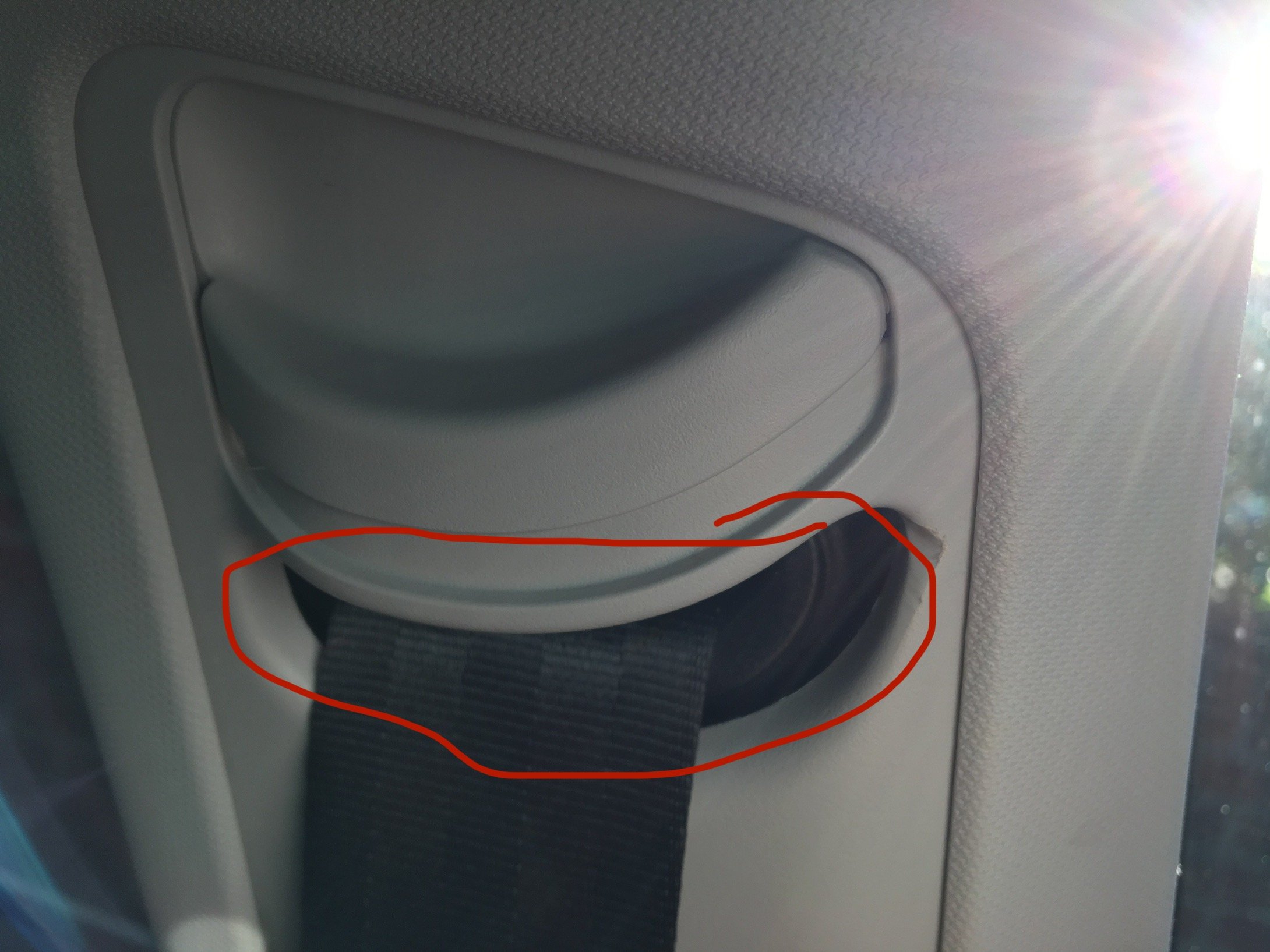

  6. Hello, sorry for the long wait in any update. After a month or so the noise does appear to have come back, I do now think I know the reason. Where the black plastic sits where the belt goes through, there’s a bolt or screw that holds that in, I have a feeling that just needs tightening, I’ve had a look in my Girlfriends Polo which is practically identical, and hers seems a lot more firm, mine however pretty loose, I think it’s a Torx screw of some type, so I am going to take the plastic casing off and see if it tightens, I will try remember to post an update once I’ve done this! I will also try find a picture from Google to show the plastic part I’m talking about.
  7. So, the paper did not work, however, I have finally fixed it, to some extent at least. I used the GT-85 on a small bolt or whatever it is that holds the part the seatbelt threads through, sorry it’s hard to explain without knowing exactly what it’s called (I will try to remember to post some photos when I’m next in the car). Anyway… it has significantly reduced the rattling, if not taken it away completely, to hear anything now you need to turn the music all the way down, have the windows closed and the fans turned off, at that point you can hear many plastic parts creak and make noise but they are to be expected especially with the roads over here, but yeah it’s basically impossible to hear the seatbelt rattle now. The only thing I’m interested in now is seeing if it comes back at any point and seeing if I’ll have to re apply the GT-85, I did apply some to the door locking mechanism for good measure haha, so far though the rattle is fixed and makes the car way more enjoyable!

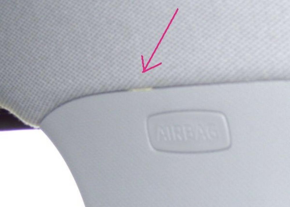

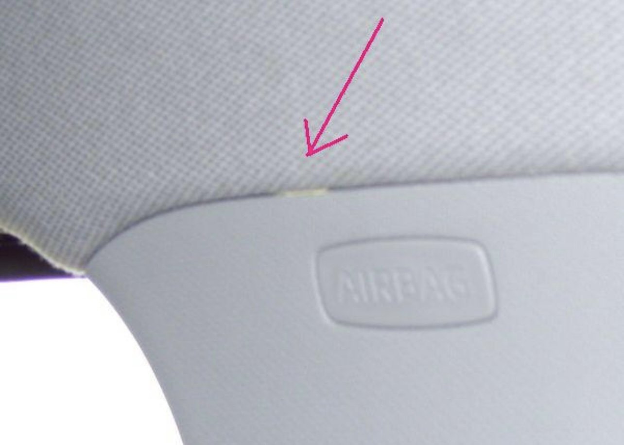

  8. Hi all, so nothing seems to have worked so far, I have got some of that GT-85 on the way as I ordered some the other day on Amazon, which I will use because I may as well seen as I bought it it! However, while browsing the other day online trying to find anyone with the same issue I came across a post on a “Dashboard rattle” thread that read this: “On my Fabia it is the fabric of the ceiling rubbing against the plastic covering the B pillar. For now I hav just squeezed in some paper between the fabric and plastic”. I will attach an imagine so you can see. I thought I may as well try this for the sake of it and just need to drive the car now, I’ll be driving to work in the morning so I’ll try remember to post an update, I’m not hopeful but I’ll happily try anything just on the off chance…

  10. Cheers I will use this if I decide to take the pillar off

  14. Hey thanks for your reply, so I’ve just had a look, I re adjusted and checked it was secure, all seems to have clicked into place, I believe it was all good before but I will see if perhaps this has solved it and will have to update later once I drive it, thanks again. Quote
