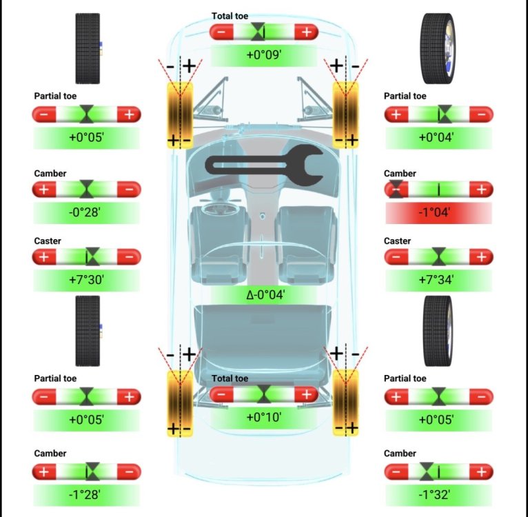

  1. Thanks guys for helping by providing valuable inputs. I hope you guys had great holidays. Updates: Another issue has been observed during driving on a dark road in the night that right headlight is now way off (light dipped towards the road). I believe this issue happened after replacing the rear control swing arms as headlight positioning sensor is attached these arms. But not sure why headlight alignment (projection of light differs between left and right side), any idea? Had a discussion with workshop. They have checked the car and appointment is now planned to try to further tune the alignment of the wheels and headlights of the car. Happy New Year to you all.
  2. Hi Alasadair1, Thanks for your reply. I've not checked these recently. But I doubt that front suspensions or top mounts are faulty as these were done one year ago. Rear springs were also changed around one year ago. And now rear control arms have been replaced. I've found the following workshop manual to adjust the camber on the front axle. Sorry about my basic questions. I'm just an ordinary owner of Octavia and trying to get understanding about the issue from Experts here. In case workshop doesn't agree to adjust the camber, do the values in report (shared previously) are OK to live with, or camber is critical and must be adjusted? Best Regards,
  3. Adding a screenshot of alignment report.
  4. Hi fellows, Skoda Octavia 1Z3 rear tyres 225/45R17 got damaged from insed. Major damage was on the rear left. Car was checked by workshop. While trying to work with alignment one of the alignment bolt got broken. They said rear control arms need to be replaced. After replacing rear control arms and alignment done by workshop, car is still going right and steering is bit on the left side (not straight). Their report shows camber (-1 degree 04’) out of specs. Tried to talk with workshop about front right camber out of specs, but they said camber can not be fixed. Is this a case? If some adjustment is possible then could someone share workshop manual? Looking forward to your reply. Thanks
