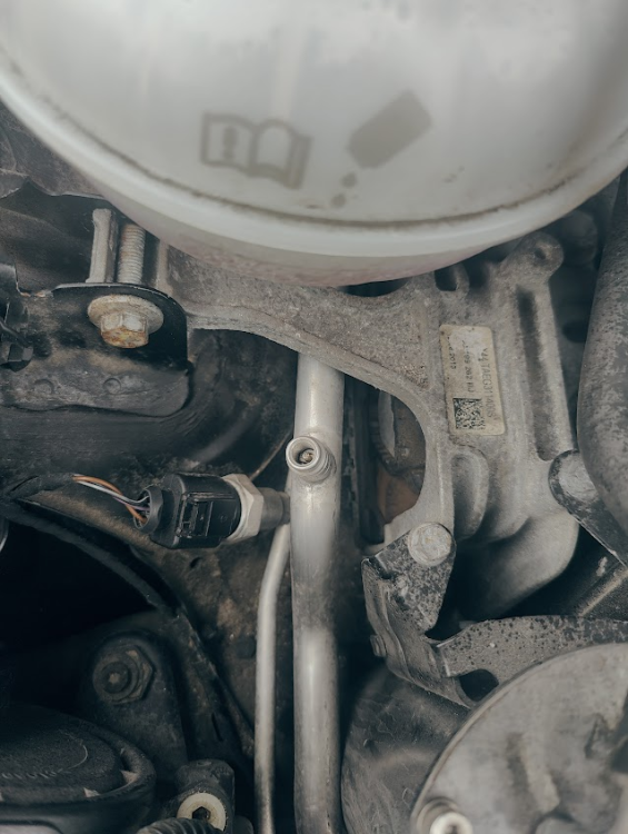

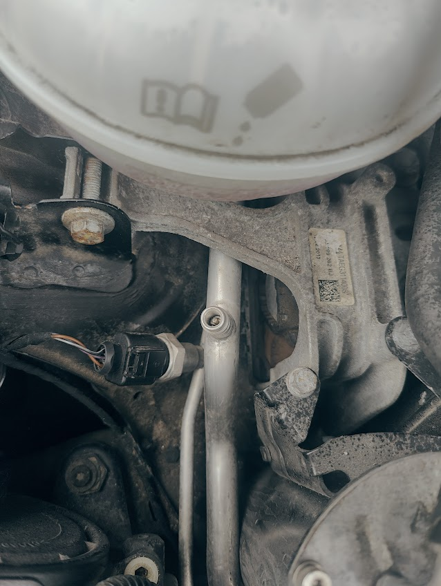

  9. Does anyone know how to find the part number for this rather insignificant part? It is the plastic cap which is supposed to cover the ac refiller hose. Btw is there a site with an exploded view of parts for the MK3 Skoda Octavia, so that one could find the part number for these kind of things?
