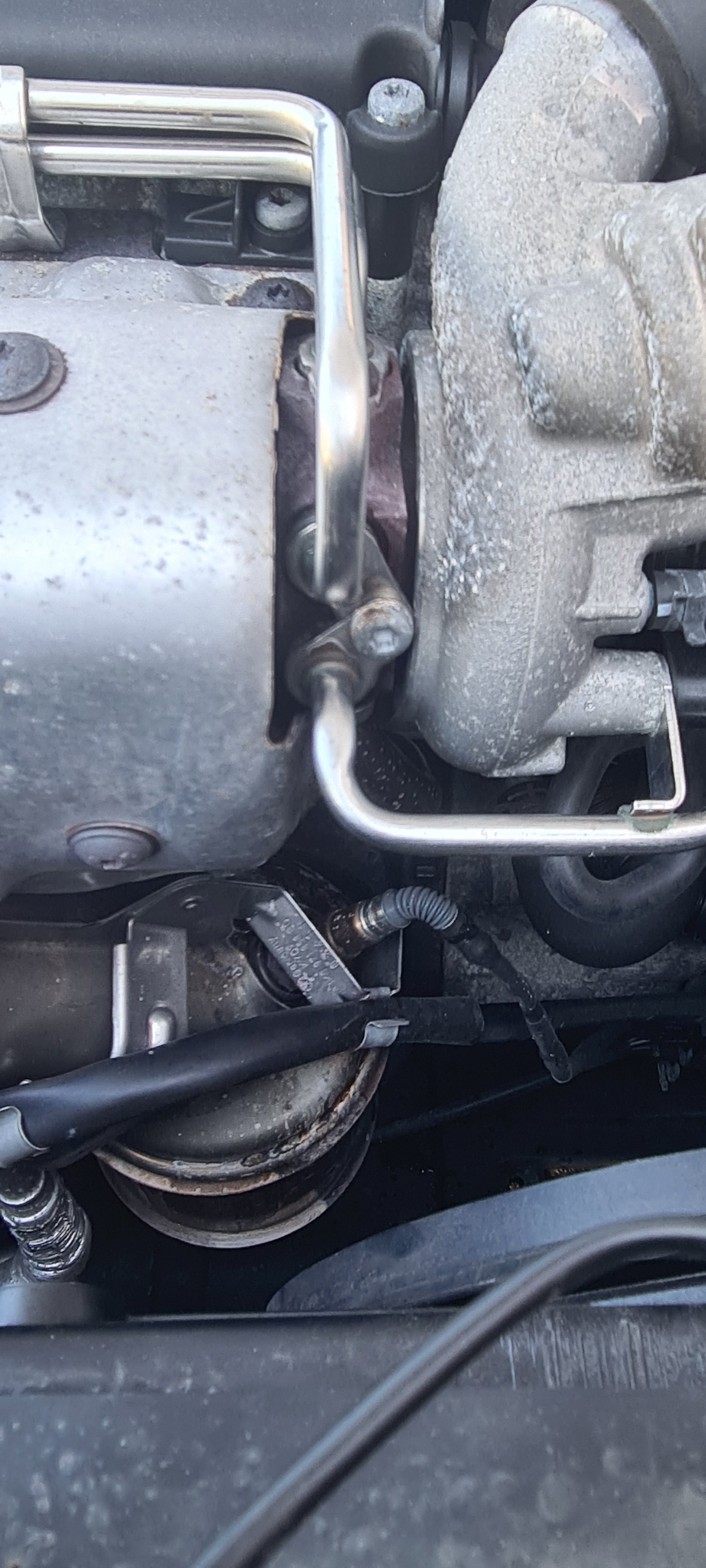

  3. Yeah only when it gets up to temperature does it make that whistling sound. I did get the leak fixed today however, an O ring between the coolant line and the turbo had perished so about £30 to replace that. Funnily enough the sound seems to have gone somewhat since getting that o-ring replaced.

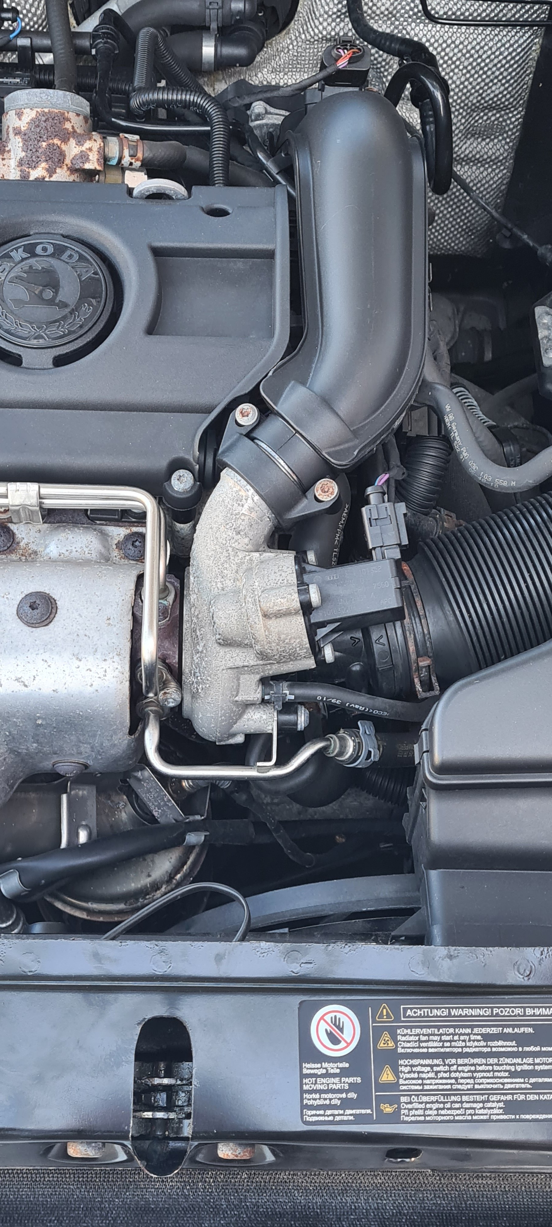

  4. So for an update. I found there is a slight leak of coolant coming out of this particular part on the engine above what I assume is the turbo. I have no idea what this part is and I'm unsure if it would be linked to the whistling sound I can hear?
