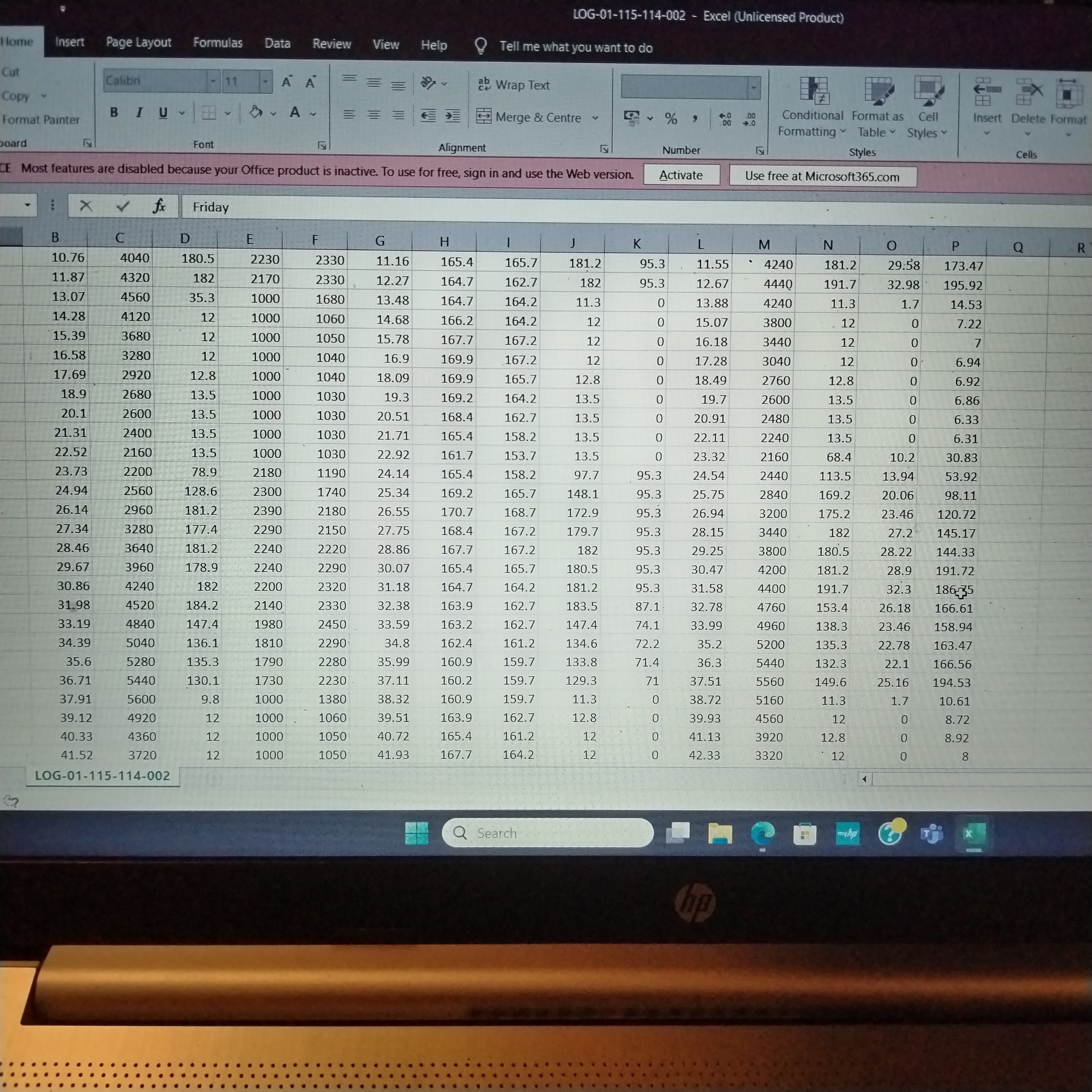

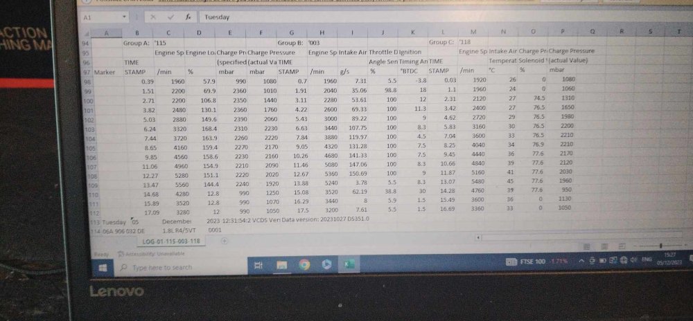

  4. So, recently purchased a Mk1 Vrs. Issue I'm having is at about 2800/3000 RPM the whole way up the rev range in every gear (apart from 1st) at WOT the car is lagging. It's hard to describe but it's like it lags, then it's fine, then it lags again and so on. Now, if I part throttle it, it doesn't do it. I've a attached a log logging boost (actual vs requested), also logging N75 duty cycle & also MAF. Third gear, WOT, 2000RPM to 5500RPM. Car is mapped, by who I don't know. Was it Dyno'd? I doubt it. Car is standard other than the map. In my mind I've ruled out the N75 as it seems to be trying to do it's job in the logs, MAF reading is a little strange being that it's reading a little high at spots but I've unplugged it and it makes no difference. I've checked the wastegate, it's not seized & moves freely. I've also done a log logging misfires (there are none). Anyone any ideas? I'm really starting to think it's the map but a couple of previous owners said the car ran well when they owned it. Second picture is the log. First is just so you know what's being logged.

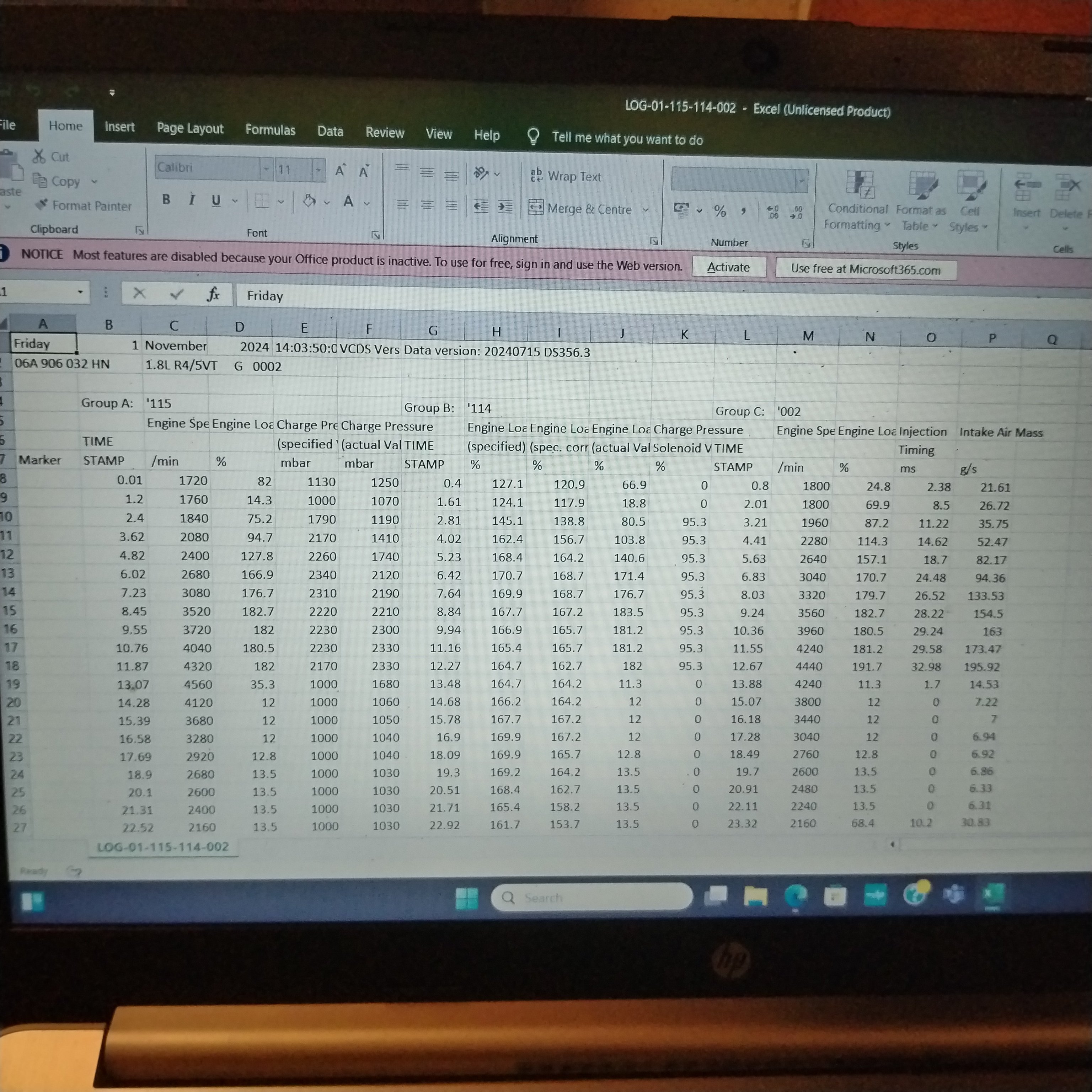

  5. Can anyone make sense of these logs for me and how my car is running according to these logs? In my mind it doesn't seem to be right but not sure if I'm being paranoid or not 🤣 1.8T AUQ stage 1 mapped to 208BHP N249 delete, SAI delete etc etc. Also, both LTFT and STFT are at 0% all the time (they never change)
