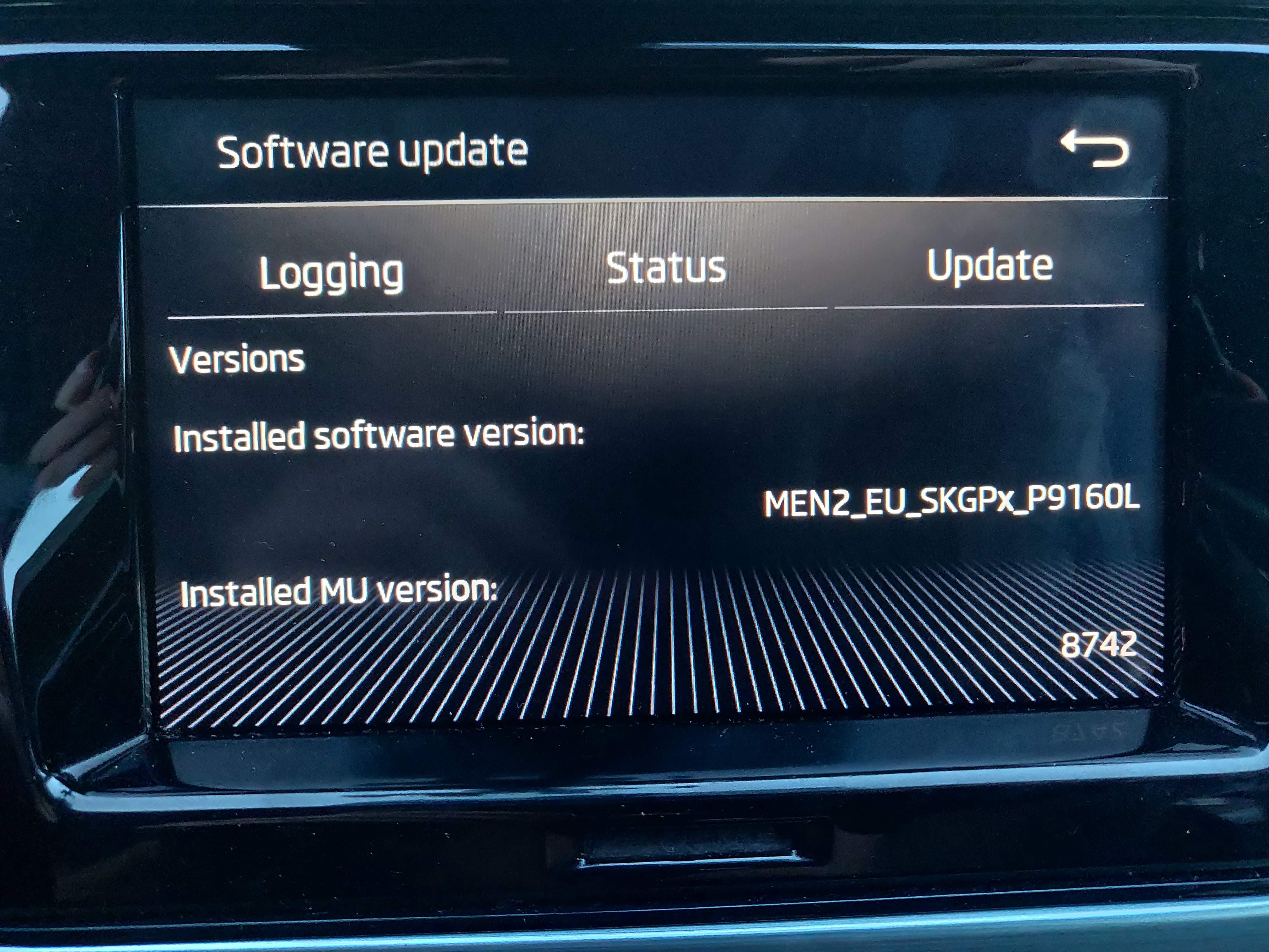

  10. As you can see in the picture, that version is the one currently installed

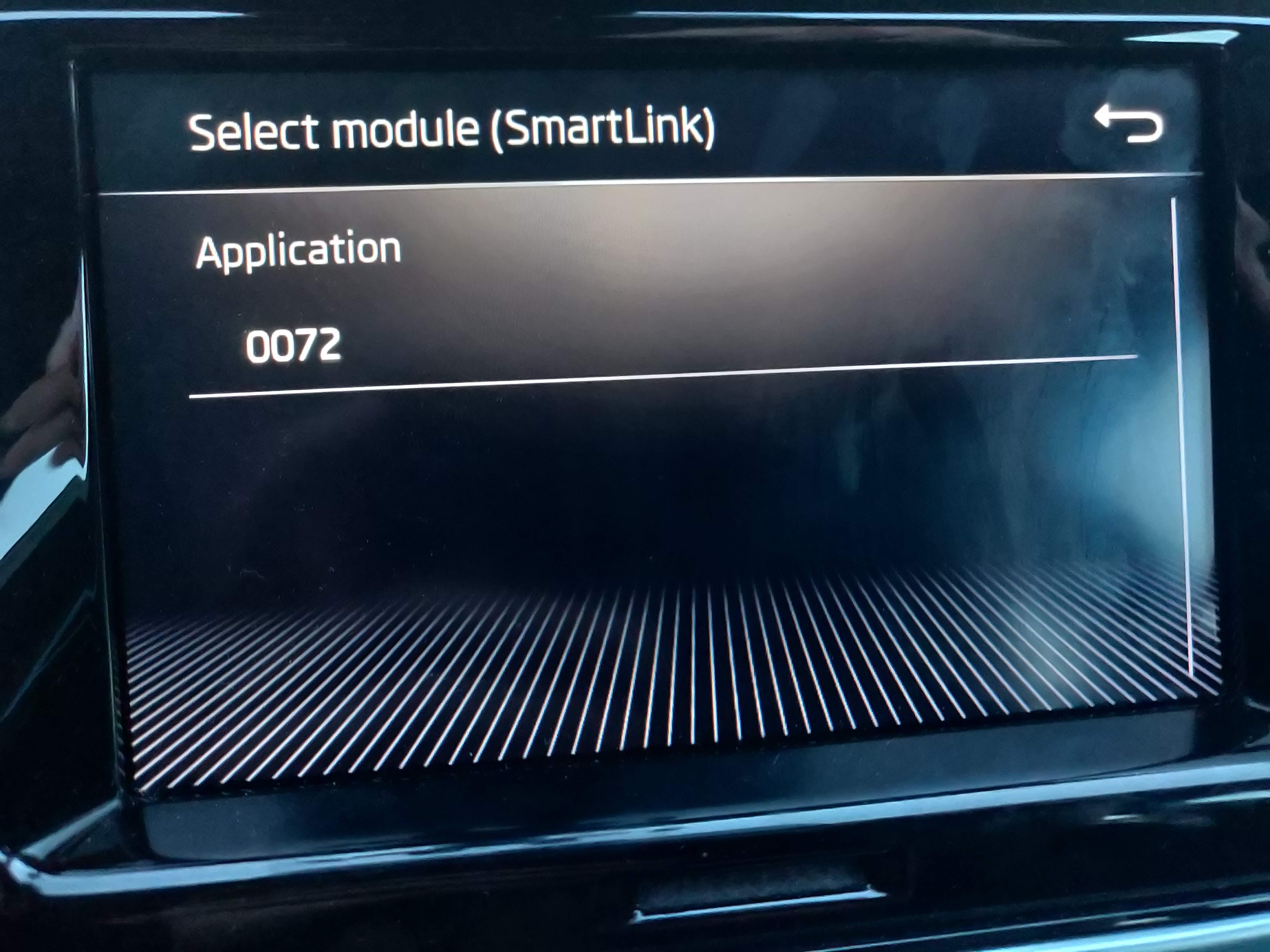

  11. I recently purchased a used Skoda Fabia model 2020. HOwever, I cannot get the connection to my Android up and running. I'm following the setup in the MySkoda app, but when I come to the point where I have to enable a hotspot on my phone, I'm stuck as I cannot find the option on the infotainment system to connect to a wifi. I tried following the manual, but the option simply isn't there. I took a few pictures if the version of the Swing-system, hopefully it can help troubleshooting a bit. The system was initially set up in Danish, but I switched to English thinking it might be a localization issue.
