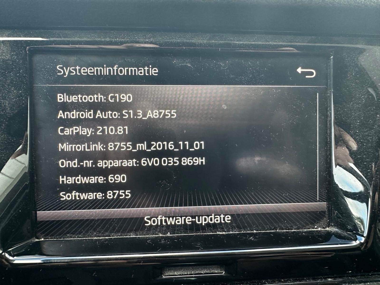

I recently purchased a used Skoda Fabia model 2020. HOwever, I cannot get the connection to my Android up and running.
I'm following the setup in the MySkoda app, but when I come to the point where I have to enable a hotspot on my phone, I'm stuck as I cannot find the option on the infotainment system to connect to a wifi. I tried following the manual, but the option simply isn't there.
I took a few pictures if the version of the Swing-system, hopefully it can help troubleshooting a bit.
The system was  initially set up in Danish, but I switched to English thinking it might be a localization issue.

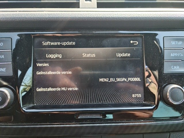

Just now, varooom said:
The updated version is this...
SW Train = MEN2_EU_SKGPx_P0080L
MU = 8755
If this helps you.

11 hours ago, pab567 said:
6V0035869H does NOT have WiFi 😞
Hmm I think I need to have a talk with the dealer then 😅 But thanks a lot for the response MN

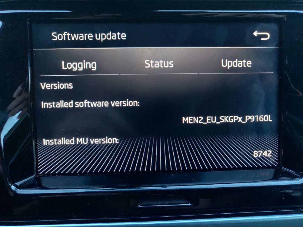

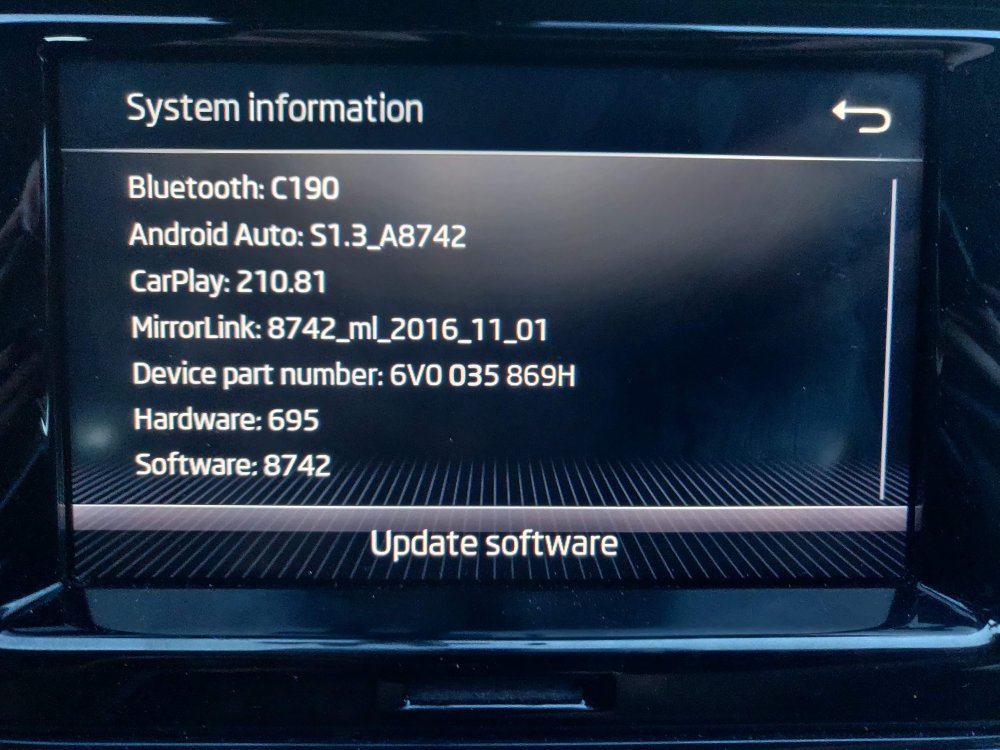

Hello, please could you @varooom provide me with the link for update too? I lost connection once with iPhone and I reset settings. After that, I’ve lost functionality like lock settings, virtual subwoofer etc…It shows just Not available. I have too the old version 8742. Thanks a lot!

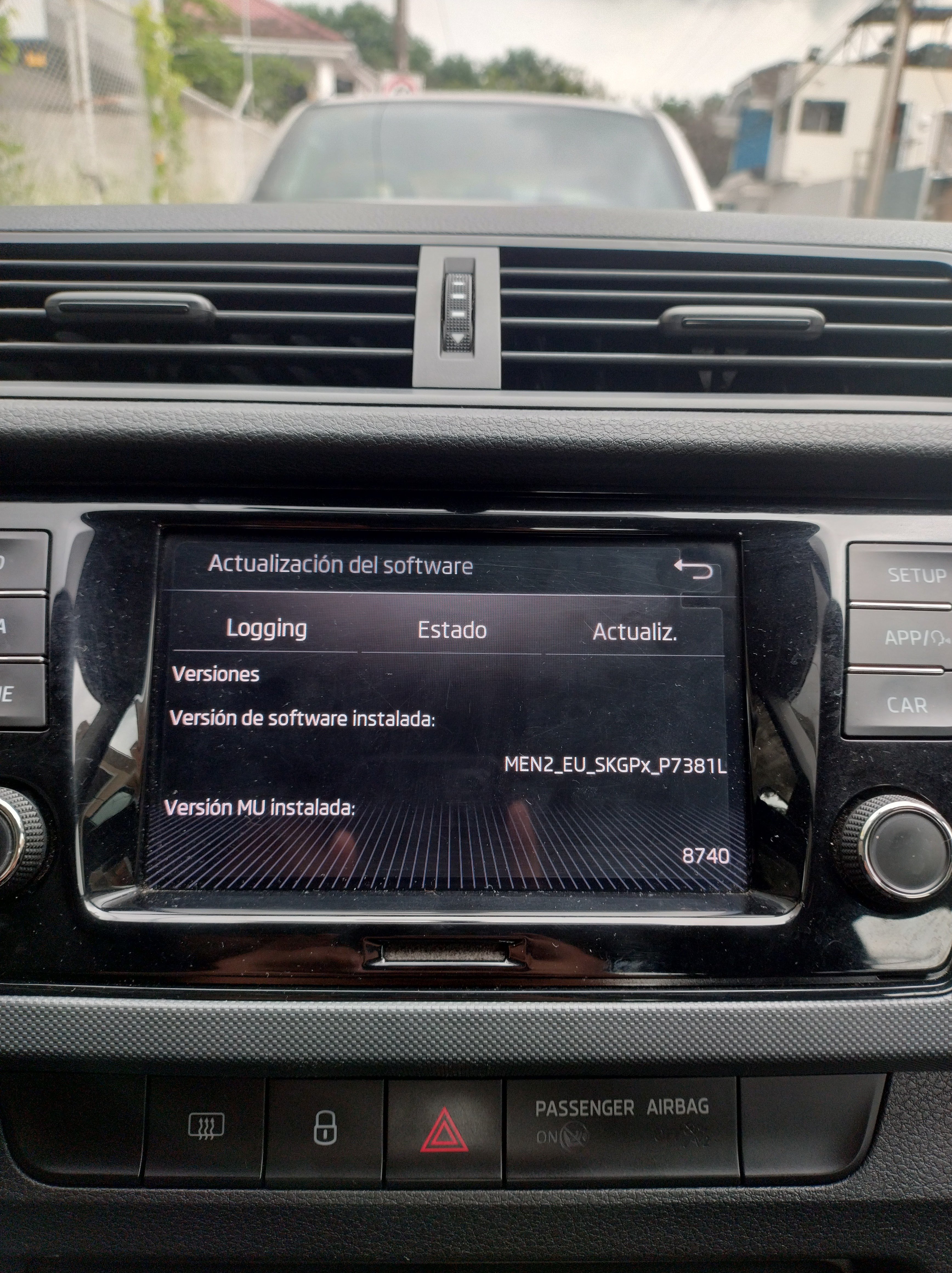

@varooom I have a lot of troubles with my car radio. I think i have a old software verion. As you can see in the picture below.
Can you also sent me a download link for the newest software please?
