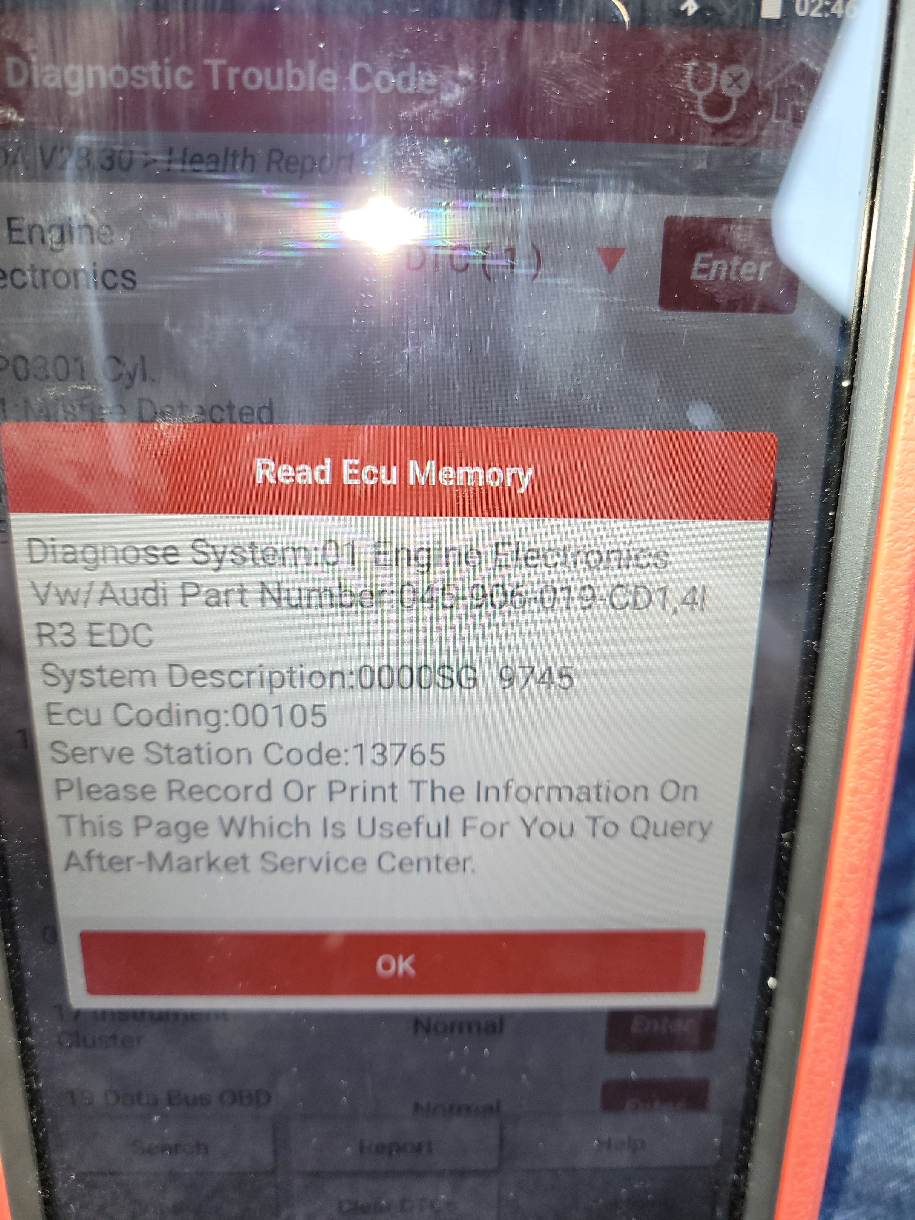

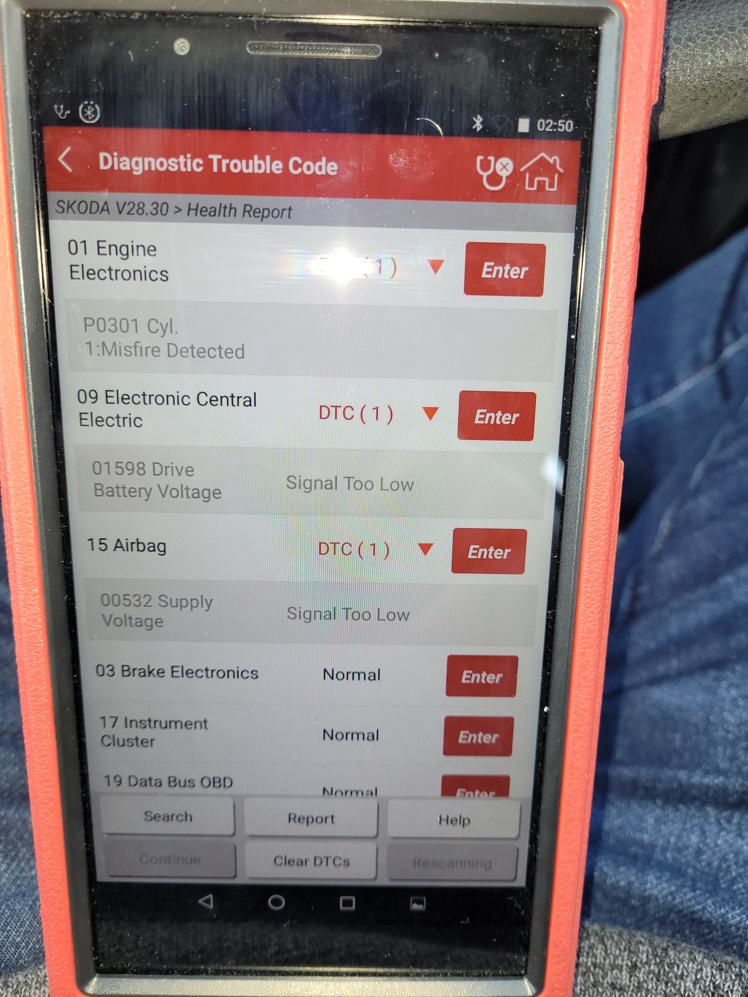

Uneven idle miss see obd report pic
Yes for sure
Just to bring anyone interested up to date.i changed the loom on.the.injectos and alls well
Thanks I will update as and when
Hi not showing anymore but haven't driven today
Thanks I just checked the battery and its showing 13vts plus Disconnected for a few minutes and started voltage from alternator was 14.4 So all looks ok
Thanks for all the info I'm going to check battery and electrical today and reset faults again Then I will order inj loom Cheers
Yes well I have taken it off to replace the Injector, but didn't notice any issue with the cam lobes
The thud thud thud I'm not sure I do get it but I will.listen tomorrow So you think the.loom is a nono then Is there any easy way to qualify the cam possibility Thanks
Wow that's a bit scary I thought it might be the loom on the injector I was just going to order 1
