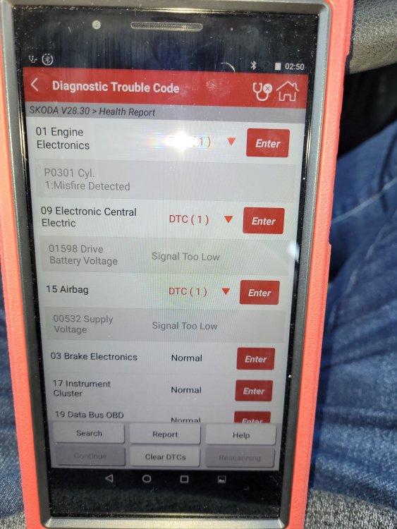

  7. Thanks I just checked the battery and its showing 13vts plus Disconnected for a few minutes and started voltage from alternator was 14.4 So all looks ok
  8. Thanks for all the info I'm going to check battery and electrical today and reset faults again Then I will order inj loom Cheers

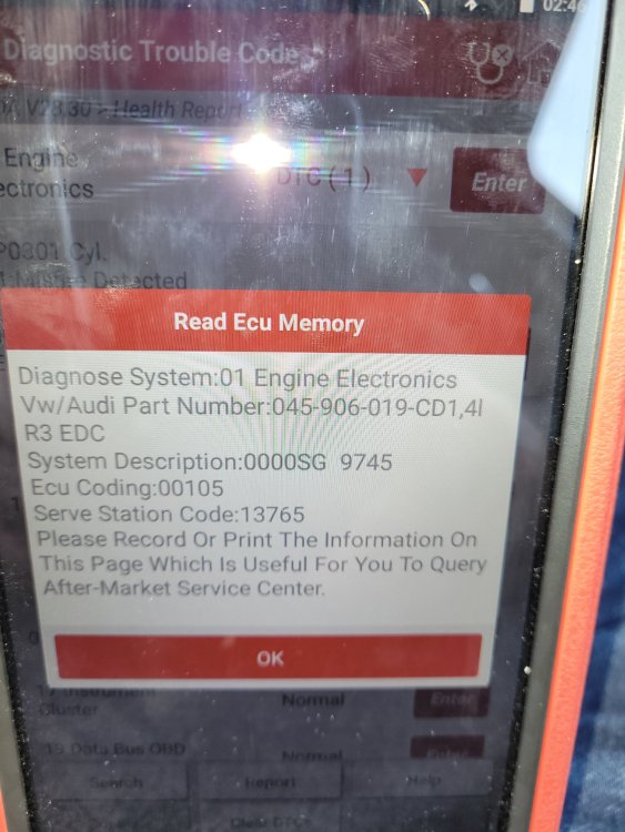

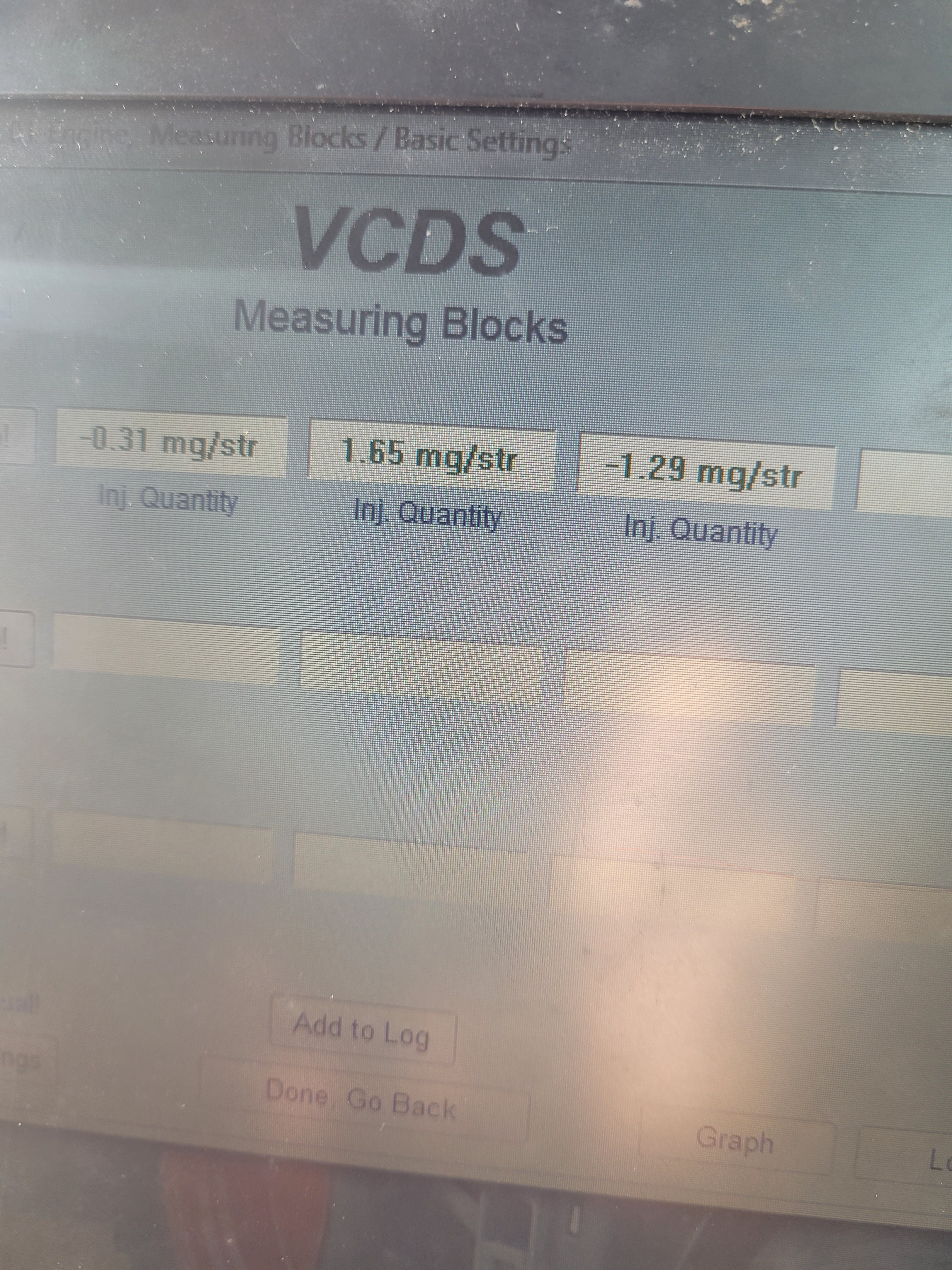

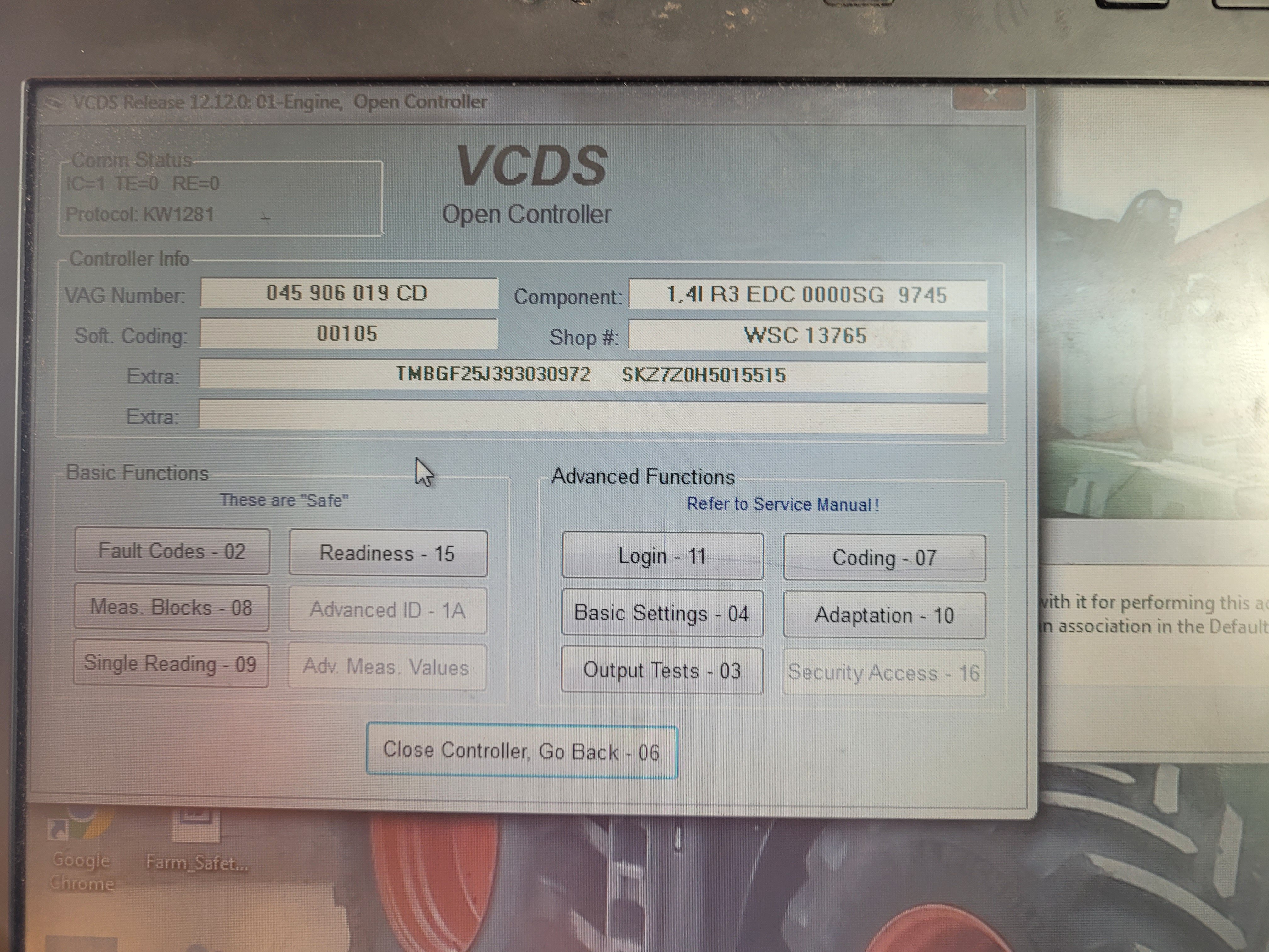

  16. Hi guys .just bought a 2008 fabia and I love it even though I have a few other vehicles all guzzlers I loving the functionality of it ,it's a 1.4 estate .only real issue is after it runs for a few minutes it starts hunting and running unevenly but if I just barely move the accelerator It runs cleanly and if I drive it on its fine but stop and it returs to uneve idle very lumpy I have taken a video of the issue on vcds showing the injector values Showing no1 as being dodgy I replaced today and its till the same problem ,just wonder could it be tps Or has anyone had this problem that can help me Thank you in advance and love the site
