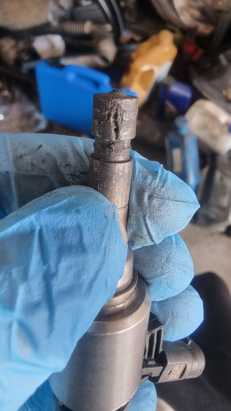

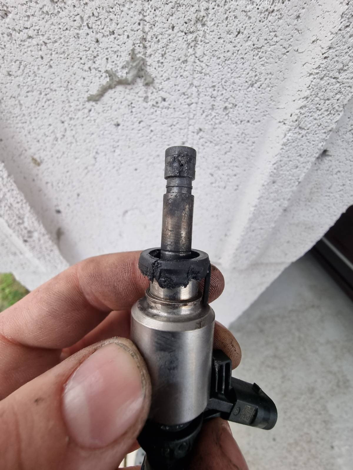

  1. Hello. CDAA. During driving got very strong vibrations, white smoke, burned rubber smell, leaking fuel from engine, etc. Car towed and injector 2 replaced (brand new bosch). Engine runs well. Drove the car 20 km and same symptoms again. Towed again and mechanic says, injector 2 is melted again. Could you please advise what could be the problem / how to possibly fix it. 5y ago pistons and chains were replaced. NB card is fitted with LPG which was checked recently. Thanks.
