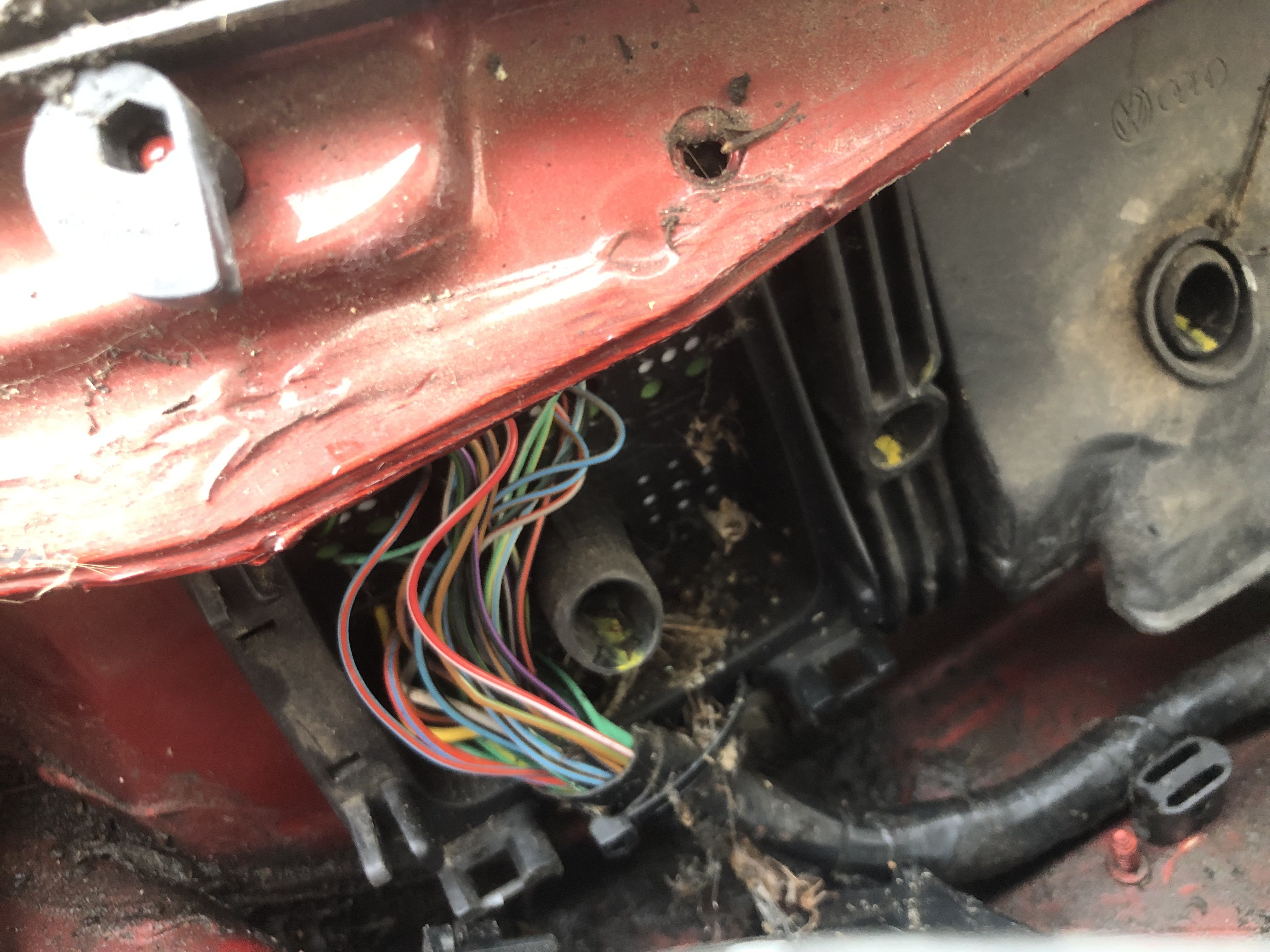

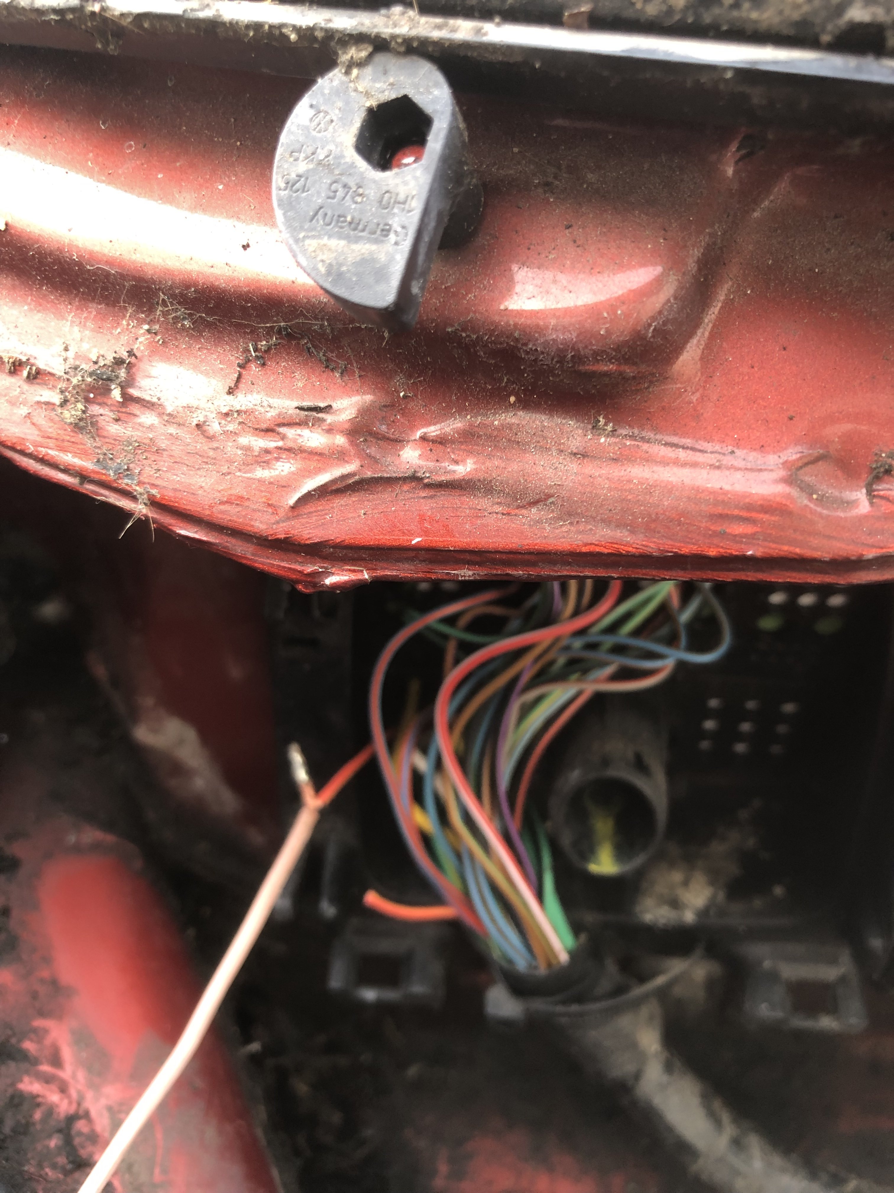

  4. I did exactly that! I resoldered it back into fuse 10 and tied it in as neatly as I could. No faults anymore. Thanks for your amazing help on this one!
  5. Ok, all faults now clear down after running live feed to pin 6 so it is a break in the engine bay somewhere! Just need to find somewhere neat to tie this in to now……
  6. Ok, Batt +ve is not reaching pin 6, but is available on pin 3? tempted to link it……
  7. Hmm….signs of damp and gunk in there…..

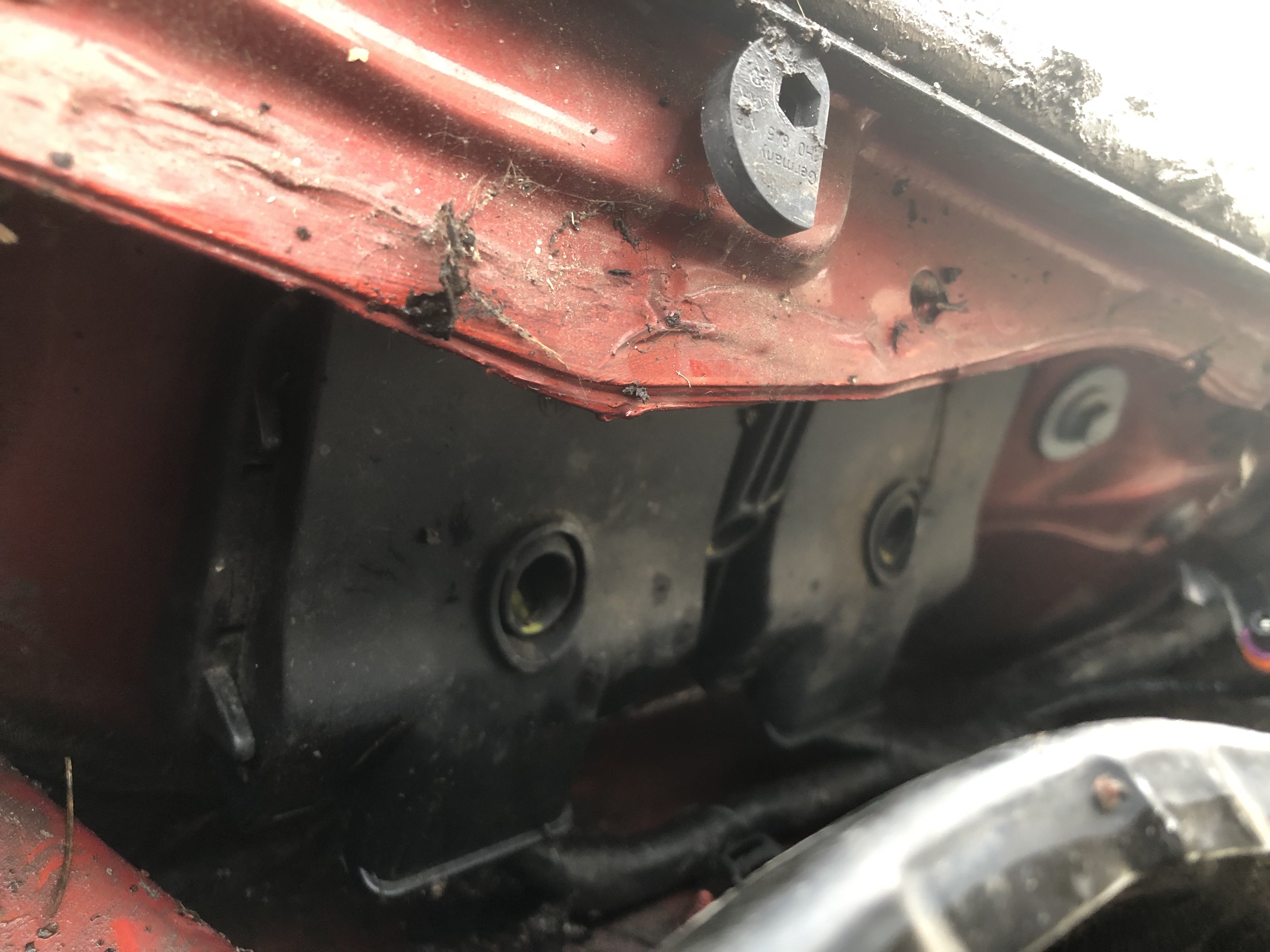

  8. Ok am into scuttle now, and removed wiper motor. How does to cover come off the firewall? Do not want to wreck it……BTW, scuttle area full of wet rotting leaves…..blew out with airline!
  9. Thanks. Already checked under bonnet, everything very clean!
  10. Thanks for the tips….I have a few different pullers so should be able to adapt something to suit!
  11. Thanks for your help so far. I think I will have to pull the scuttle panel off tomorrow and check at the firewall. Not been in there before so on a 20 year old motor who knows what may be lurking…..
  12. Would you be able to share the relevant wiring diag? Will have to pick up tomorrow, goind dark and just got rained on!

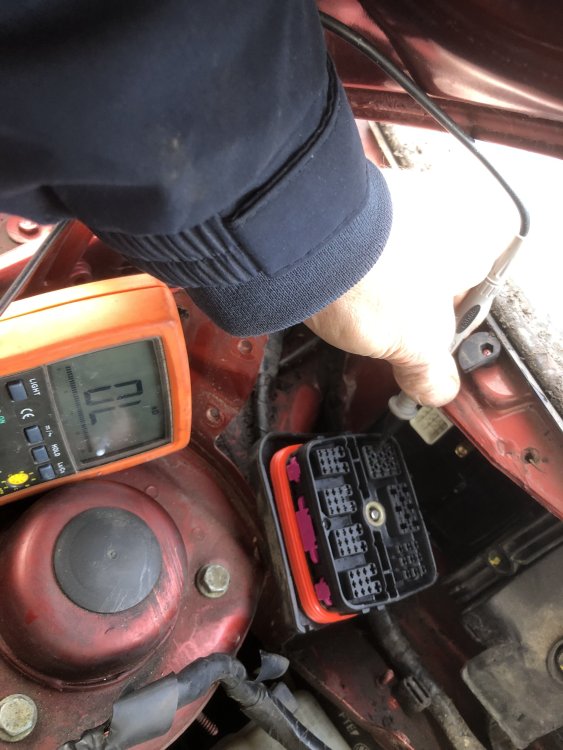

  13. ok, I disconnected battery and rang fuse 10 to pin 5….its o/c!
  14. Hmmm….battery connected, ignition on, plug still pulled out pins 5 to 8 no volts….
  15. Sorry, my mistake. Yes, it rings though fine to pin 8…..
