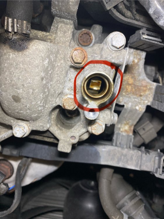

  3. Hi Pete- thanks for coming in. The reg is HV10 VHK (sorry for the confusion on engine size!). I think the whole chain will need doing now (tensioner on its own no longer an option as a Skoda technician has said Skoda have changed the tensioner part so now it doesn’t fit with old chain etc). It may well be the case they’re not sure what they’re dealing with because they’ve said until they get the cover off and look they won’t know). So it’s either £144 and sell the car for scrap. Or pay £1,350 and hope the car works for a while after the repair. They did invite me in to look through a little round cylinder type thing and said the thing that’s visible (gold coloured) shouldn’t be there and there should be a “gap” for something else to slot in there (I’ve attached a picture I took). So they believe the chain has “jumped” (I think he said) I’m in Portsmouth. Are you able to advise the straightforward way to check the chain timing please? Thank you

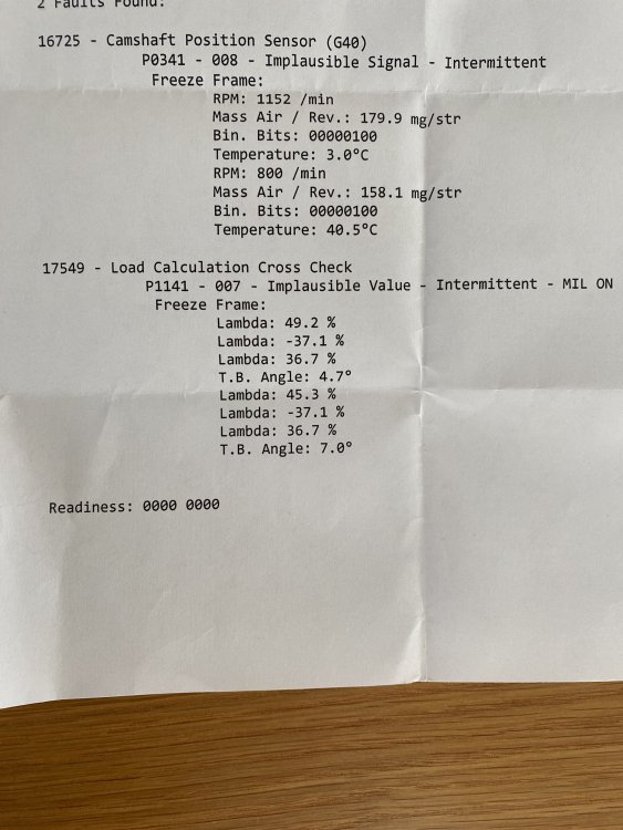

  5. Hi folks - big decision for me to make on my Fabia which I’ve had since new and only 75,000 miles!! I would welcome your thoughts on what you’d do please!! Car went into indi. garage because of engine management light. It’s only been driven 0.5 miles (to get to garage) since light came on. The two fault codes are : 16725 - camshaft position sensor (G40) P0341 - 008 - implausible signal 17549 - load calculation cross check P1141 - 007 - implausible value The indi. garage has said they think the tensioner is causing the issue because the chain has come out of position. I’ve been given three options: (1) replace whole timing chain kit, oil and filter £1,350 (2) replace tensioner only, oil and filter £550 (3) pay £150 to take car away (cost of diagnostic work so far) They’ve said because I haven’t driven the car far since issue that the sprockets and chain might not be damaged but won’t know until they take the cover off and get it apart. Would ideally like to keep the car as we know the service history and only 75k miles but don’t know whether to go for the £550 and risk having to pay £1,350 🙈🙈 I imagine the car is worth less than £2,000!! Any suggestions would be much appreciated - thank you!
