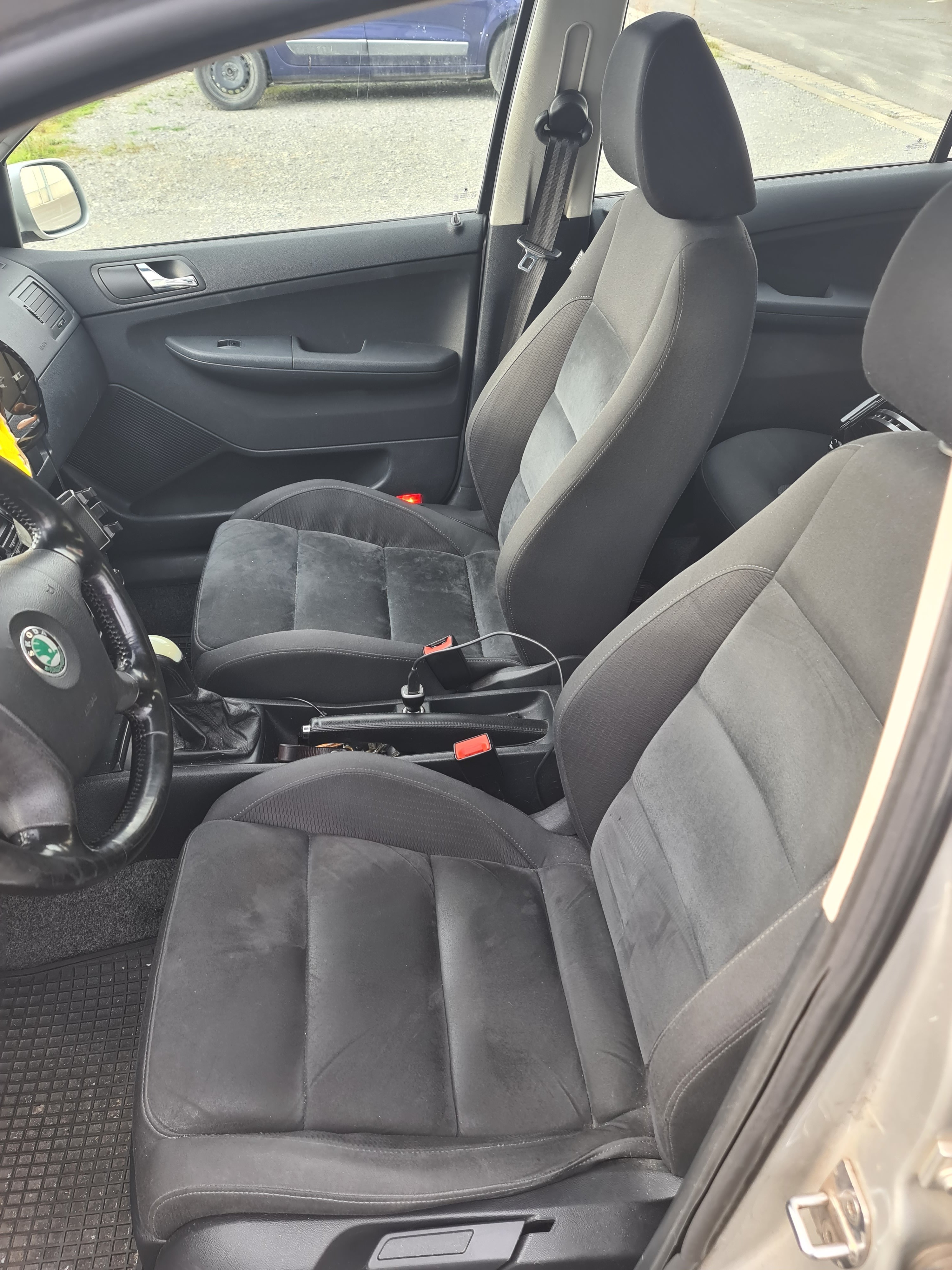

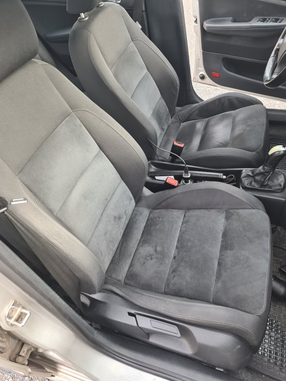

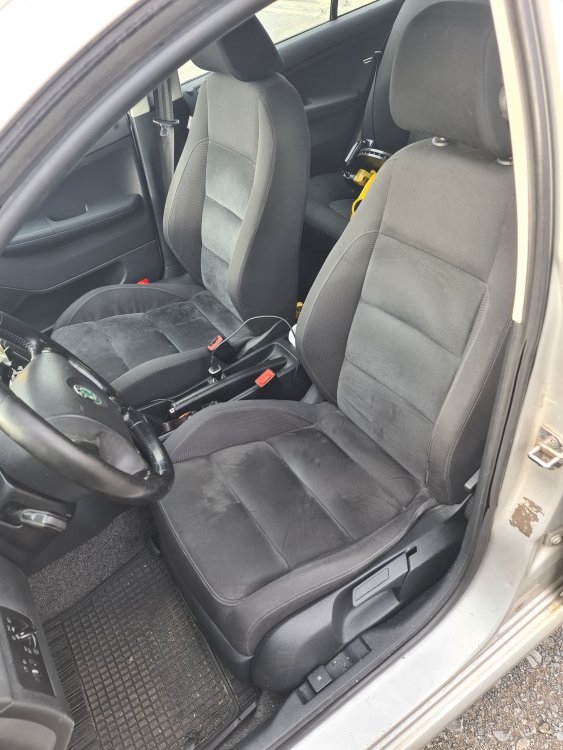

Hello, the conversion was easy as 1,2,3... Disconnect your battery! You just have to knock out the seat rail braket's tabs (bottom tabs under the rail) from the new Golf seats. (Drill them out). Use your existing rail braket's from your old seat's as a spacer. Small tab at the bottom). They are pressed in. You need a degrinder, 8 mm, 10 mm drill bit. 10 mm washer. After taking off the old tab from the new seat, drill a new hole just about 10 mm offset from the old rear tab. Use your old tab and place it under the rail (rear). The spacing is tight but it will fit. The lever from the gas tank latch (LHD) will have more resistance when you pull it. Rail pushes the plastic in. Right side no problem at all. You will have more usable adjustments on the seat's and more leg room. Absolutely the best seats so far. I'm on my third set! Leave your original plugs in your car and use the connectors from your old seat to convert to the new ones. Use your old heating control unit from your old seat and connect it to the new seat. You will not get any error on your dash (air bag lamp). Heating takes a little bit longer because of the Alcantara seats. The heating control unit triggers both seats. I can provide more detailed photos.

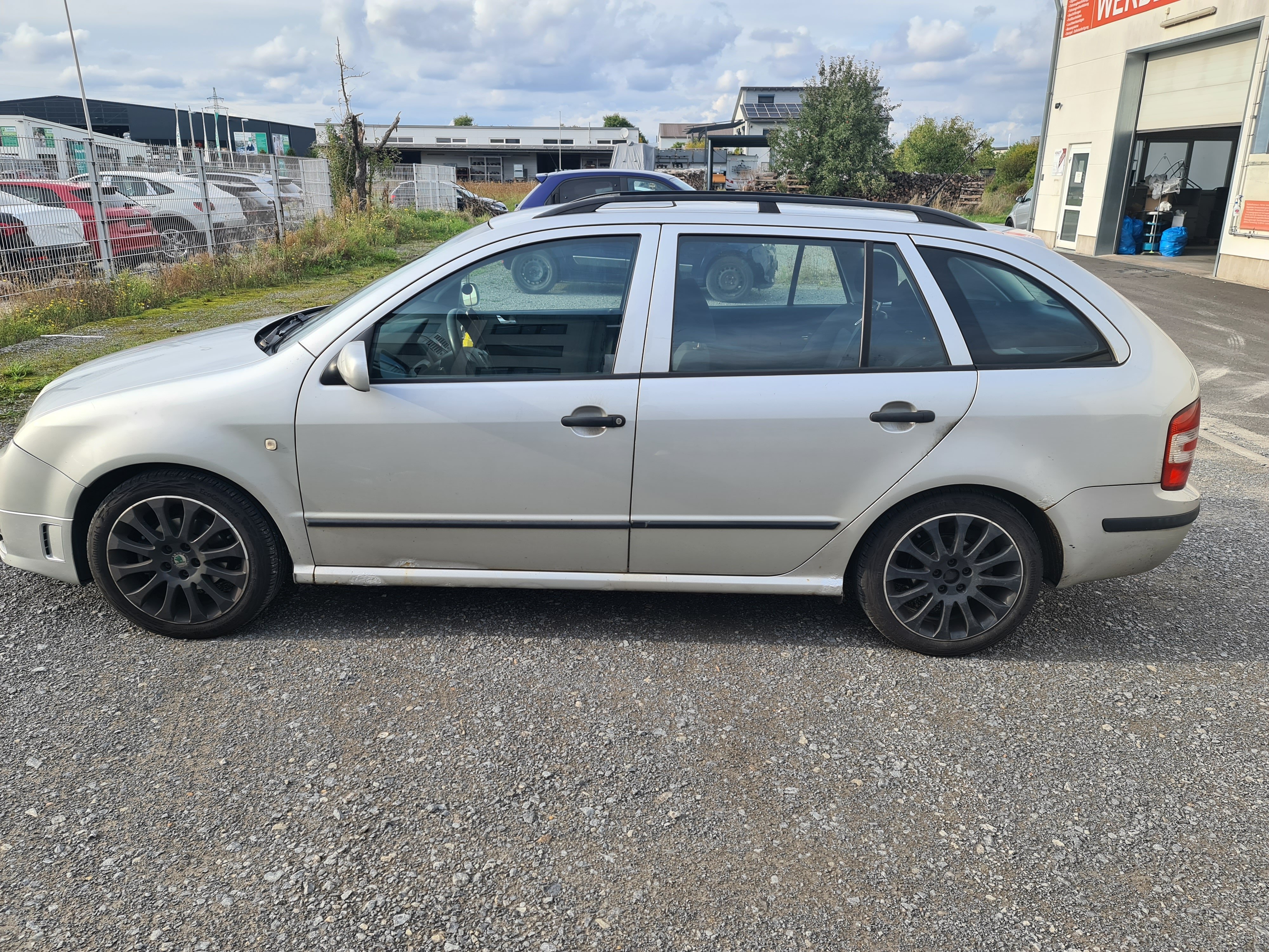

Fabia 6Y Combi on VRS springs

Fitted Golf MK6 Alcantara seats into my ****box. Heated seat's with side Airbags. Works great and lot better than the Fabia RS seat's. Heating takes a little bit longer but works great. Rear seat conversion is next.- Fabia Brembo low budget big brake conversion.

I will feature my big brake conversion on my MK1 Fabia 1.9. Step by Step with all parts needed and Help in anyway if you want to do the same. The conversion includes a full 4 pot Brembo caliper front and rear with Audi S3 handbrake. 312 mm front Brembo rotors 280 mm rear Brembo rotors 16" Wheels The cheapest way to make your fabia brake better on a budget- Fabia 6Y Combi on VRS springs
I would buy a complete coilover kit with lowered 30 mm springs front and back. I can send you a pic of my set up. Will be for sale. (Coilover kit with Eibach lowering springs heavy duty.) Much better conering, stiffer and better control on highway.- Hello to everyone out there...
